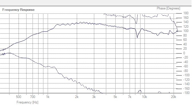

I am just working on a project using a rather good Polish engineered/built tweeter with has similar dome shape (maybe a bit more convex) as the DX25 and it has a good dip at around 8.5Khz which is a reflection in the throat. The dome shape is not optimal for this waveguide, try a ring radiator or a tweeter that has flatter diaphragm. Besides the dip - textbook performance (I`ve attached on-axis only but off-axis is superb too) which makes it easy for a single cap to equalize and achieve a low 4th order with a simple crossover (usually with a 2nd order electrical).
I expect my sample to give the same performance seen here, as I'm using the same common tweeter, so no 8KHz dip until 45 degree off axis: Test Peerless DX25TG09-04 (Vifa XD-270 F/4) am Waveguide WG-300 – Heißmann Acoustics
