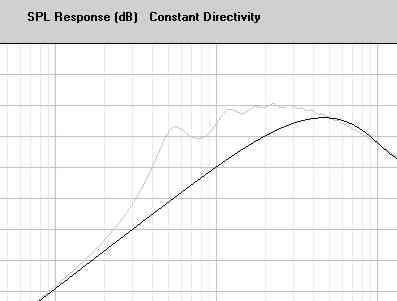

Zaph did a test of a wave guide dome tweeter.
As long as the wave guide holds pattern control, the frequencies below where the tweeter starts to beam show a modest rise in output, simply because the waveguide prevents 2Pi radiation. The extent depends on the geometry of the waveguide.
HTH
Doug
The inclusion of a compression chamber is where horns start to show a major increase in power efficiency. With a waveguide on a direct radiator the apparent (and arguably true, so long as you're sitting in the hot spot) efficiency increases because the sound pressure is gathered in a smaller area. I don't think overall acoustic output power increases.
conical, without comp. chamber
Just a quick question. Is there an increase in a dome tweeter's efficiency when it is loaded in a wave guide? If so how much of an increase is there?
It's not a simple answer because it varies with frequency, horn style ... most of the parameters. Basically a lower frequencies, but above what is usually called the "cutoff" (although the term is misleading) there is an increase in efficiency. But this increase fall off to zero as the frequency goes up ending up at almost no change in efficiency.
But be carefull that you understand and mean "efficiency" because it's not sensitivity or SPL - those act entirely differently because of the changes in directivity.

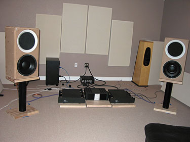

Putting my money where my mouth is, I listened to the Gedlee Summas in 2005 at the RMAF:
Earl from Gedlee on the left, Duke from Audiokinesis on the right. I also met Lynn Olson that day, who has a big thread on this forum.
Instead of buying Summas, I bought a set of JBL 2-ways which also use a waveguide and a high efficiency woofer. These JBLs are suspiciously similar to the Gedlee speakers, I wonder if they're following his work?
The JBLs had nice dynamics, but the rolled off treble bugged me, so I went ahead and bought a set of the Summas after living with the JBLs for about a year. And that's the last set of loudspeakers that I've purchased. The JBLs are really no comparison. They *look* similar, but the magic is in the crossover, the waveguide, and the cabinet of the Summa.
