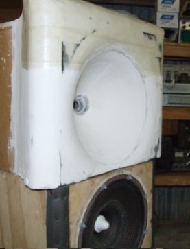

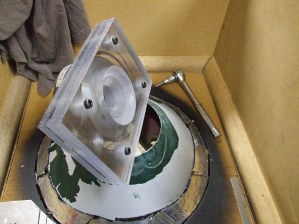

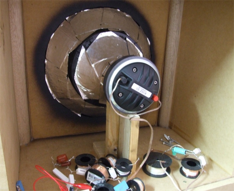

Sure, it's possible. That's how I made some of my early DIY waveguides.if I could extend
For example..
1. I took an 8" commercial horn and extended it with a baffled steel lamp shade,
2. Later, after designing a custom throat to replace the horn section,
3. Extending the mouth for a good match to the 15" woofer.

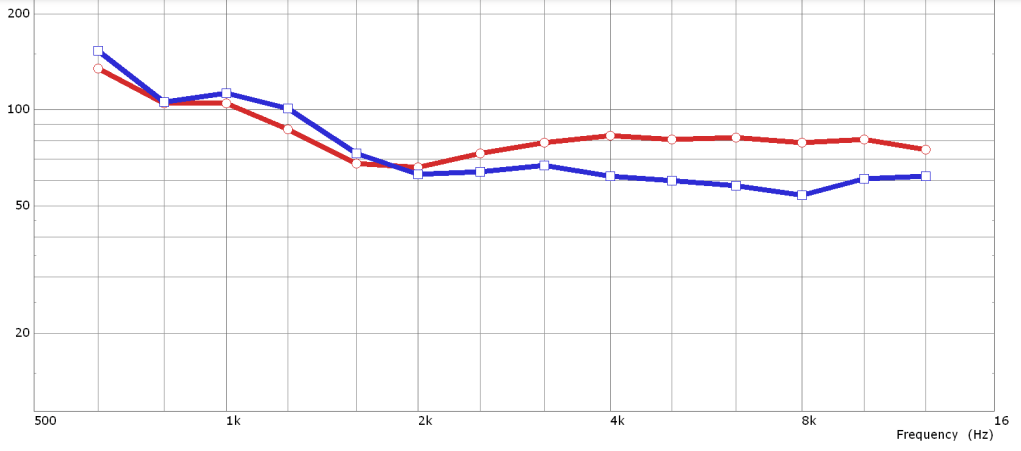

However, loading and waveguiding are not the same thing and in some respects, more of one tends to mean less of the other. Do you perhaps have a plot of directivity for this device?load a compression driver
Not that I have seen and I have no measuring instruments. I would be winging itHowever, loading and waveguiding are not the same thing and in some respects, more of one tends to mean less of the other. Do you perhaps have a plot of directivity for this device?
I would start with this and it wouldn’t take much to knock up the baffle.Another option is to learn what it can do as it is now, and find the optimum woofer size to match it and accept the DI that it gives.
I was wondering if this would be a way to extend horn you obviously know what you’re doing. I respect that.Sure, it's possible. That's how I made some of my early DIY waveguides.
For example..
View attachment 1238277 View attachment 1238278 View attachment 1238279

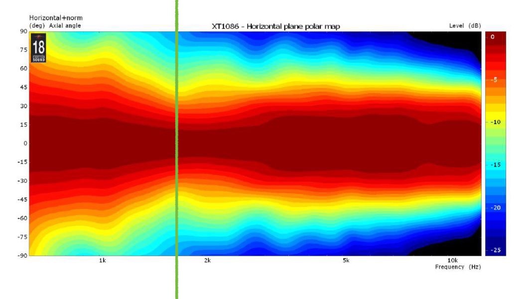

Also; I stand corrected. After looking at the polars, I concur with AllenB that the XT1086 is better suited to a typical 8-10” driver.
Here’s why:
“It provides consistent on-axis and off-axis frequency response from 1,4kHz to 16kHz in the horizontal plane and from 1,5kHz to 16kHz in the vertical plane. Horn directivity is constant from 1,4kHz”
Reference:
https://www.eighteensound.it/en/products/horn/1-0/0/XT1086
That is, if you’d want to use this horn to provide consistent on and off axis response; you’d focus on using it for frequencies higher than (to the right of) those marked by my green lines, as below:
At typical 15” will start to beam (send less energy to the sides) at approximately 800-900Hz.
Thank you @AllenB for pointing out the directivity graph above.
