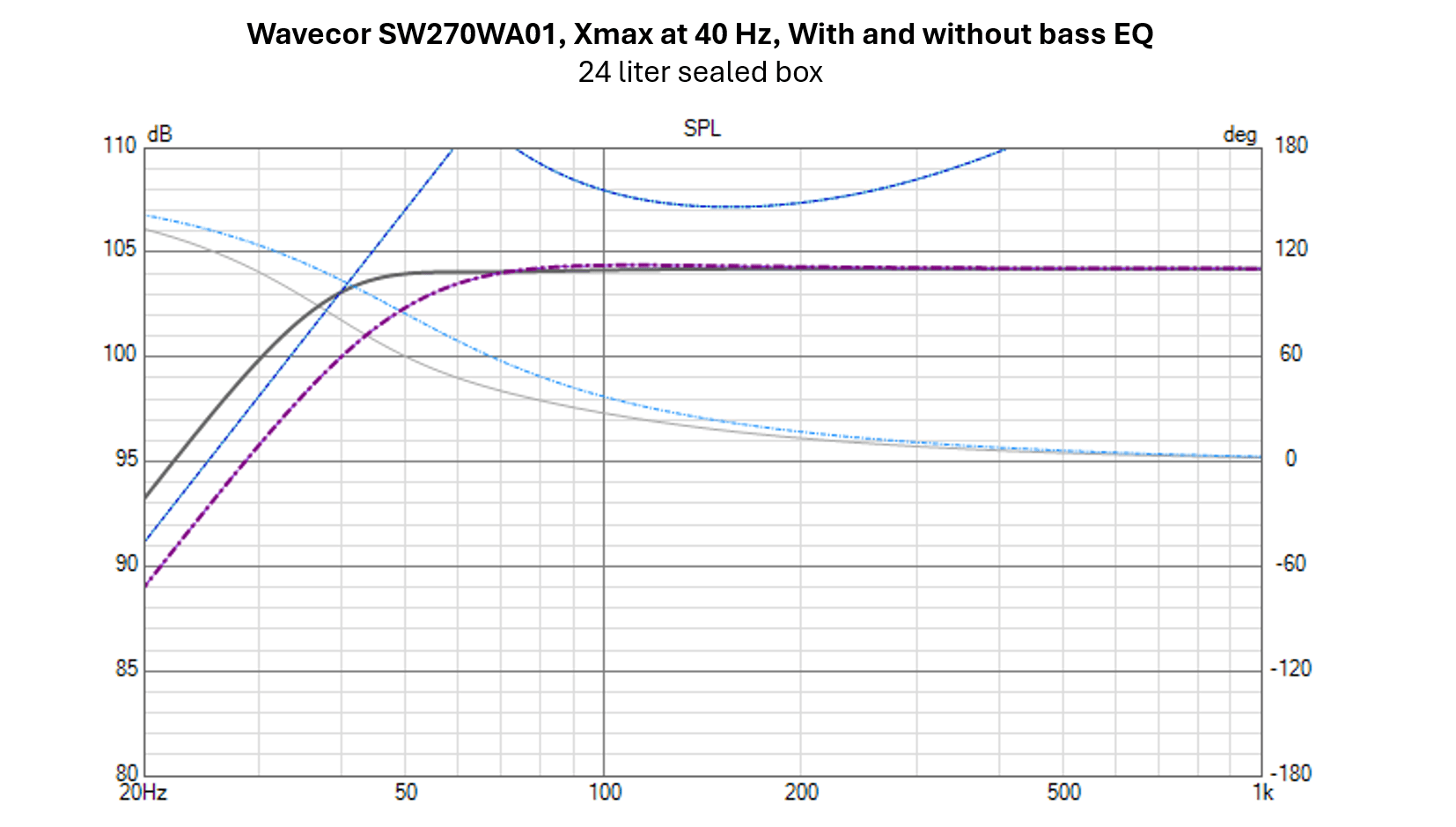

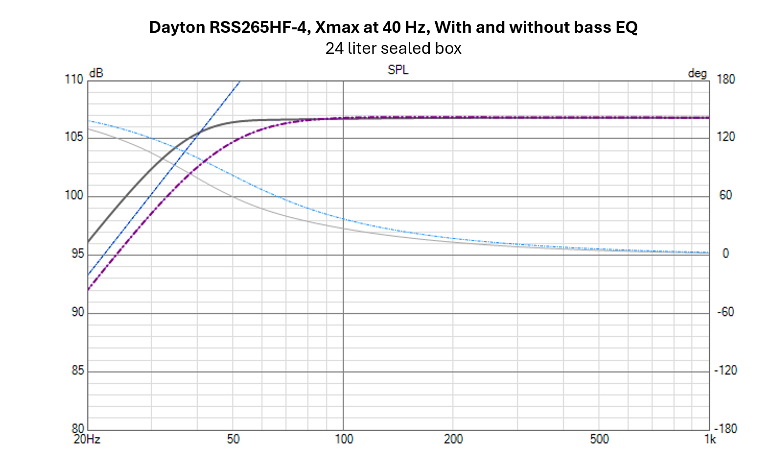

I have simulated both drivers, and the RSS265HF has about 2.5 dB more SPL capability at 40 Hz, assuming both drivers are driven to Xmax. The bass EQ which would be needed is modest, about +4 dB.
My impetus in starting this thread was to see if there was any distortion data available on the web that I was not aware of... or if anyone had specific positive or negative experience with either driver. If I am limited to the information I have in front of me, the Dayton driver is the obvious choice.

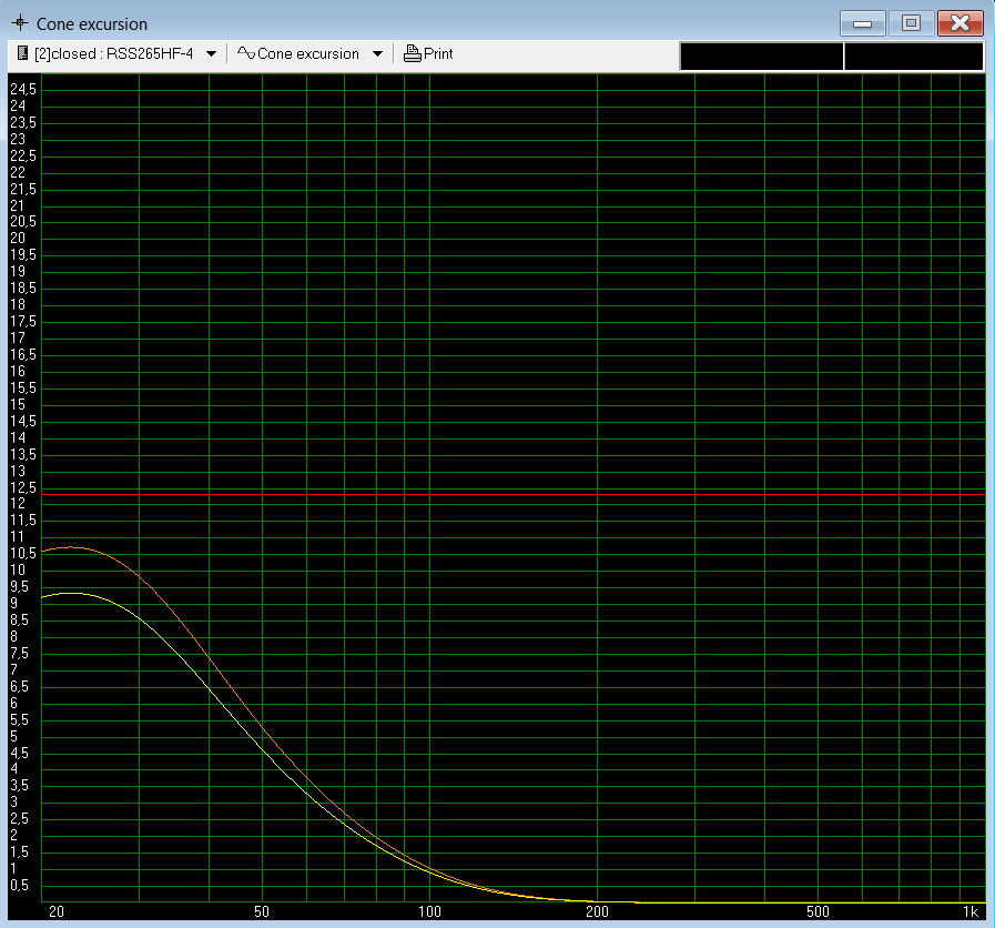

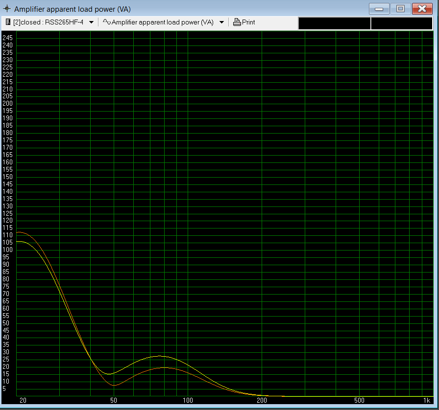

This is in 24 liter box, LT at 30Hz with 1st orde HP at 25Hz and 4th order LR filter at 120Hz.
For no particular reason, it's about the relative comparison anyway.
Orange: Wavecor
Yellow: Dayton
Cone excursion seems to be a hair better for the Dayton, but the Sd is also a hair higher.
Which could be as simple as using a different definition/calculation for the Sd.
(I haven't seen the drivers side by side in person, so I can't tell)
So it will really come down to BL(x) and Cms(x)

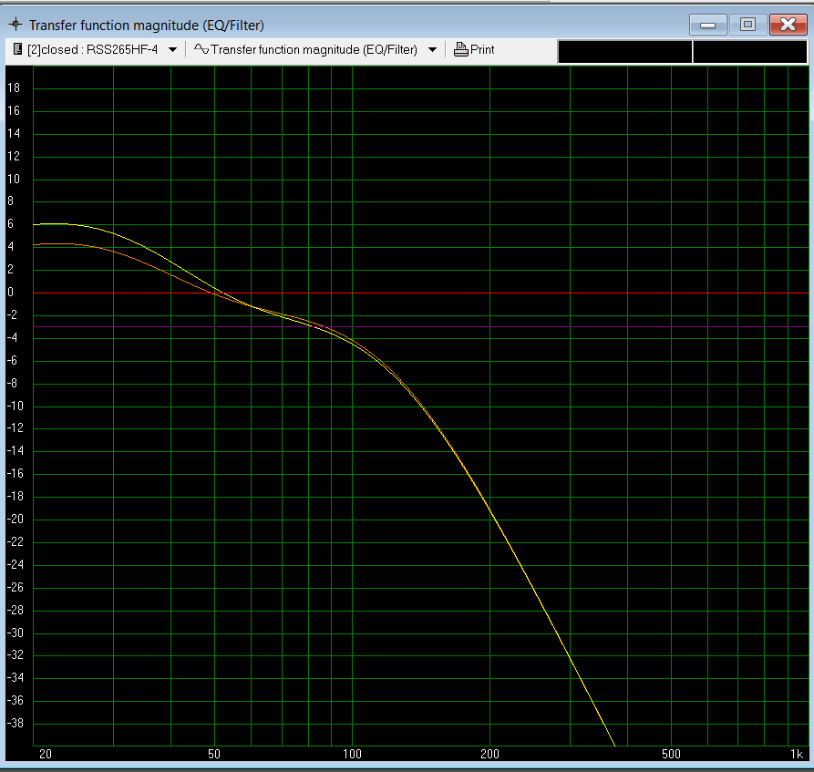

Important note; don't do this with the current version of WinISD it has a major bug with LT EQ filters, giving wrong values.
Going a little smaller is fine, but not smaller than 15-18 liters, otherwise you have to EQ over 6dB.
Current EQ with settings from above;
