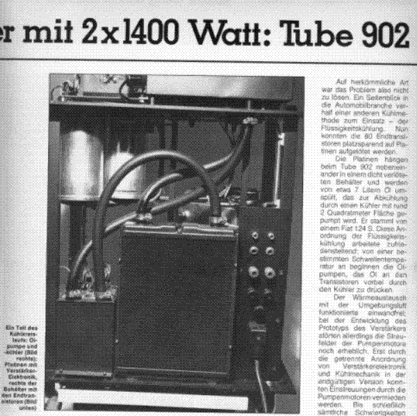

That's lovely, do you have more pictures or the entire article?
Hi Eva,
1980 one of my friends put this 80kg monster for "testing" to the german hifi-magazine HiFi-Exklusiv, they done some measurings, the thd was not so famous : At this time a had no meter:confused:
Btw, I think this was the last time for technical tests....other mags started only with hearing-"tests":cannotbe:
The article is german written, it is scanned, but for details the pics are too big to put it here.
Regards
Heinz!

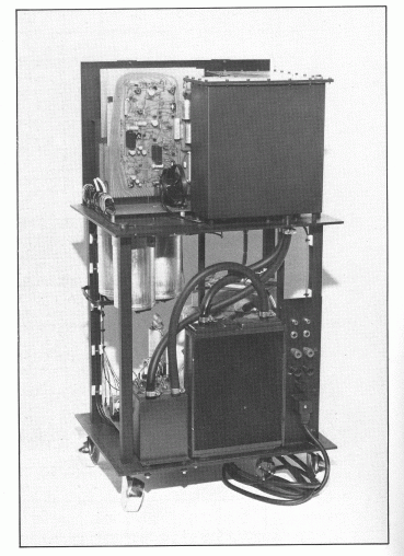

powerbecker said:
Once upon a time......
in 1979 I build a 2channel poweramp with 80 workinghorses in two half-bridges.......
powerbecker said:
.....further components :
1 EI-transformer 4kVA
2 heat-cooler from Fiat124S
3 7l transformer oil
powerbecker said:
..the expansion vessel was in the container at the top, together with the 2N3055´s. It was made from a folded Perbunan skin also the the tubes must use this material, because the hot oil solves plastics..
Amazing. 30 years ago.
Heat-cooler from Fiat 124S
One amplifier with the power of cars. Like :D
