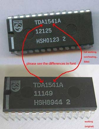

do you see the feet of the number "1" on my photograph ? No horizontal base on the feet of the 1 with the Taiwan and horizontal base base on the others !
different font than all the others chips... but indeed it means Nothing ! And my Taiwann is also different than you said genuine one in the bottom of the photograph
look again : http://www.diyaudio.com/forums/swap-meet/308095-wanted-tda1541a-s1-s2-crown-4.html#post5089470
yep 10 years apart indeed, so not a prove but why change the marking ?! (font are near but not the same as you see, the old one are thinier and in the meantime has this base tray on the 1 number)
This is more my ears who said to me it has a problem... if not I never will see the difference at close inspection as you didn't see it at once on the post 36 photograph !
if the AYA distors in the mid-treble with it (sort of H3) i have no this problem with the S1 and others less transparent normal TDA1541 ! I should sent it to Pedja Rogic, or maybe the balance of my hifi is sensible in the mid-highs, dunno !

If you look at the other side, you can look at a marking which was maybe the injection plastic port : they have all the same width on all my tda chips but the Taiwan 98 at the left which is larger (around 1/4 widther) : so defintly not the same machine Tools for production or from elswhere !
Any ideas or testimonials ? Hope also it can help other members to source good ones ! But my idea is many bad tda chips you can see on the EBay markett are perhaps second sorted choice after quality control ! It could be cool if some guys of Philips whom read us have any idea ! (not vendors)
As said before, I bought the last box directly from Philips when they were about to abandon one of their locations in the Netherlands. I was offered all inventory. When I examined the list I found what I absolutely did not expect to find. A very large quantity of various TDA chips was listed. I only bought TDA1541A. These were made when Marantz CD7 was about to be produced. Marantz CD7 was introduced somewhere in early 1999. All machinery for production was transferred to Taiwan and some runs of TDA chips were made. The 1998 Taiwan chips that went to EC Designs were original ones. When I got the box it was unopened, I was the first that opened it. I lost 85 of them to a chinese scammer, some were sold to private persons and the bulk went to EC. These sound fine, you are the only one complaining. People that buy these like them. They are certainly not fake. Maybe you understand some of the reluctance to show production numbers as showing pics of genuine numbers possibly gives scammers new ideas. I assume the 85 chips were rebranded as S1 or S2 as I later found out that the "buyer" was dishonest and notorious (under various other names).
So people that bough these from the mentioned source don't need to worry. It is also very likely that no other source sells chips with these exact markings. I would not buy any TDA chip on Ebay as that is the main channel for selling rebranded IC's.

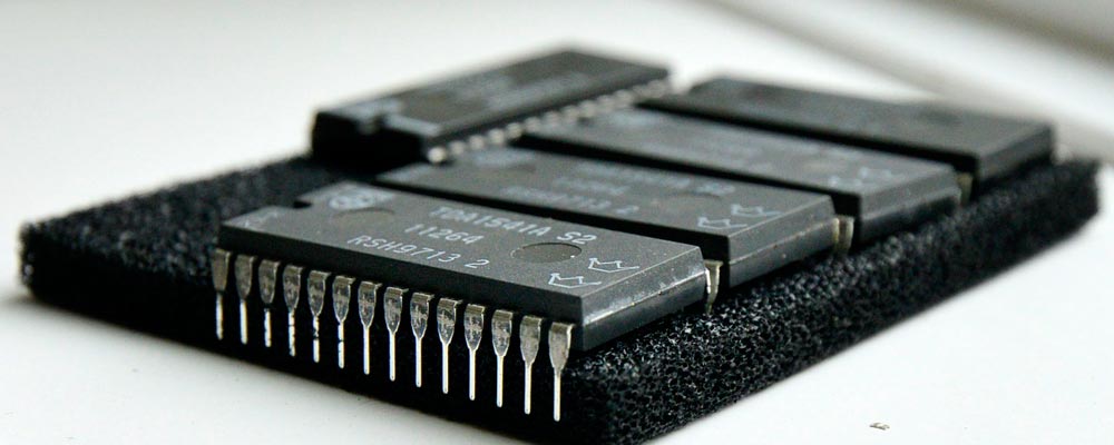

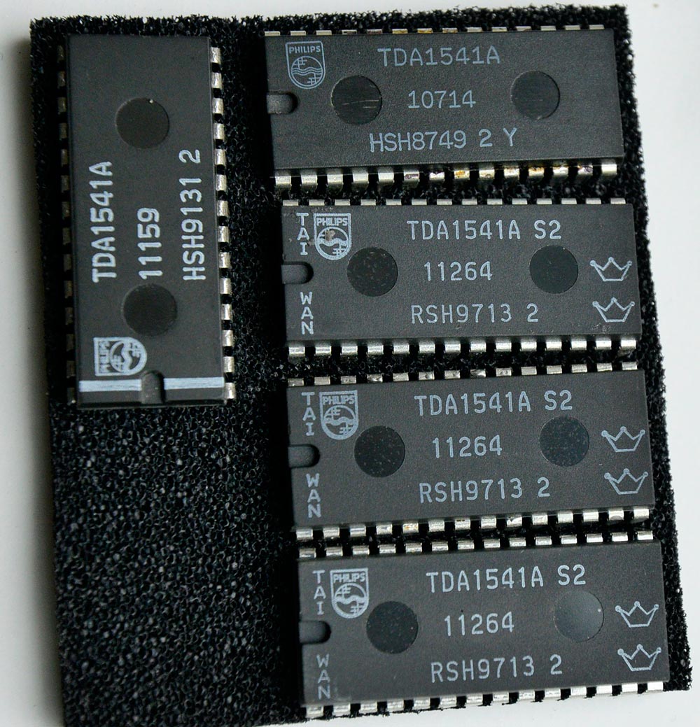

If anyone's interested I have few of those chips available. Guaranteed to be genuine.
I'm interested, send you a PM... prices?
Wow, you kept a few 1997 Taiwan S2 and that are the best TDA1541A one can find. The ones I mentioned are only non S1/S2 marked 1998 Taiwan chips.

JP; I thinks these guys are artists to make fakes, don't need me or you ! They can mistake even museum directors : they now where to dig the clay in the original place to make a counterfeit, how to old it, etc... they are clever if not honnest. The font on your chip is exactly the one on the top left chip on Peter Daniel photograph ! As you see it is whiter, thicker, a little different : it looked odd to me !
I believe it's a great opportunity you offer to members.
True but as explained there is little chance of buying a fake one with that date code and numbers except when buying from Ebay and the like. The more sources the more chances one buys a flaky one. Simple. 85 of them got lost in China and are likely stamped with one or two crowns.
Same with the S2 chips Peter offers, I got my S2 from that same source and they are genuine.
