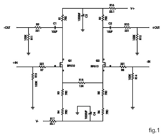

Have you considered Nelson's Balanced Zen Preamplifier?
Look, Jam! No transformers! :D
I've seen it before. In visualizing this circuit, if I were to tie the +in & -in together & apply a test signal between the GND & ‘incorrectly’ tied inputs, I believe that the outs would still leak the test signal, instead of being canceled out..
Have I visualized the circuit incorrectly?
The circuit is just a classic differential input pair. It's primary function is to amplify only the difference between the two inputs and reject anything that's common to both inputs.
How much common-mode signal gets through it will depend on the particular circuit. Nelson measured its CMRR at "slightly greater than 80dB." That's using its output balanced. If you use the output unbalanced, it only does about 20dB.
I wouldn't expect to be able to do much better than that if you're planning to use just two active devices in the circuit.
