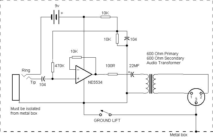

Hi all!
I have been looking for a schematic on a D.I box.
After some googling i found a couple but none of them had GND-Lift, phase (not hard to add, i know), Ratio etc.
The also lacked component quality.
Does any one know of a site that has more info on D.I box construction or is sitting on a service schematic (good inperation)?
Best regards, Hampus
Here's one I've built several times:

The all op-amp DI boxes are cheaper to build, but you lose the ground lift ability, which may or may not be a problem, depending on what you are trying to do. Running a keyboard, guitar, or some other instrument direct, the non-transformer DI will work fine. Trying to run direct from an amp may require the ground lift to prevent ground loops.
Why? The ground lift is just a switch, just as it is in your schematic. Why is it any different for the op amp circuit?
The transformer is what isolates the grounds. The op-amp's output must have a return path. Since the - supply is system ground, that is the return path. They do make special isolation amplifiers for data acquisition systems that have built-in isolation transformers, but I think they are quite expensive.
Ground "lifting" really becomes an issue when stage equipment is on a different mains supply than the mixing console. There can be an AC potential between the two "grounds" of several volts, causing terrible "ground loops" and lots of noise. If this kind of situation will never exist (as in a studio or small clubs where the sound board is on stage, etc.) ground lifting may never be needed. Also, if the instrument is only plugged into the direct box and it's monitor is being fed from the board (no stage amp) ground lift isn't needed.
I believe you are confusing isolation and grounding. Yes the no-xfrmr circuit does not isolate one side from the other, but no the no-xfrmr circuit is capable of operating with the ground lifted thereby cutting the ground loop. If not, nobody would ever bother with balanced lines.
Yes, the 'ground lift' switch doesn't remove the ground connection, it removes a SECOND ground connection, which prevents earth loops that can cause hum.
So the cable is still fully screened, and everything is still grounded, it just stops the hum.
As suggested, a transformer provides isolation, this breaks the ground connection totally - so there's no need for a 'ground lift' switch.
Instead of a 'ground lift' switch, you can do the same by using a lead with the screen disconnected at one end - but it's a GOOD idea to mark these clearly - or you could confuse yourself :cool:

Sorry to lift this old thread, but on this site ESP - Direct Injection Box for Recording and PA Systems
they write about this schematic:
Note that in some cases (especially with older equipment of US origin), pin 2 is 'cold' and pin 3 is 'hot'. This connection scheme is not recommended, and should not be used. The above is as close to an official standard as you will find, and should be used in all cases.
What does this actually mean? Something to care about?
