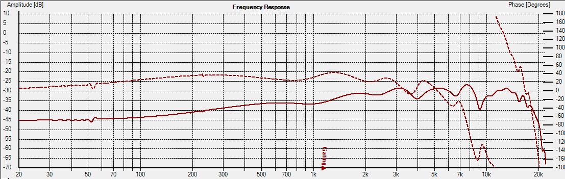

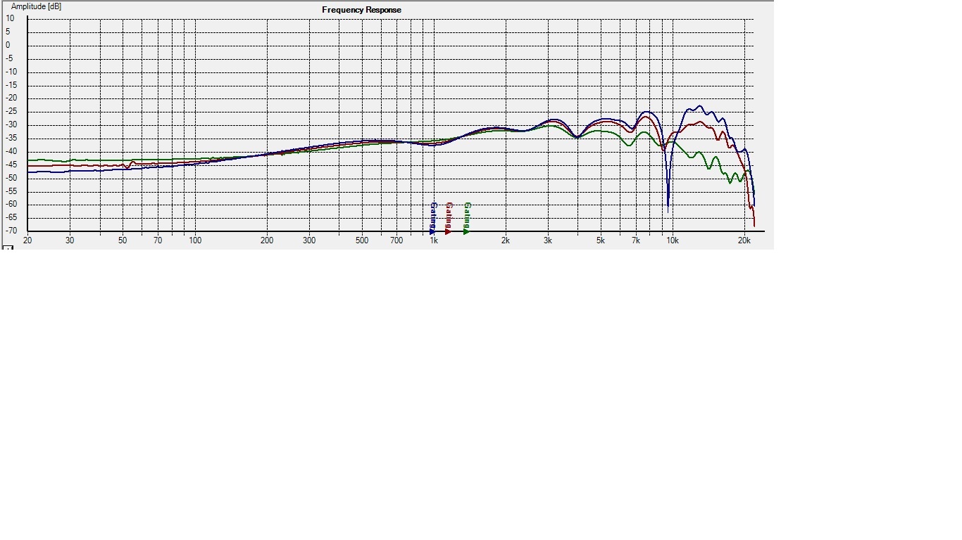

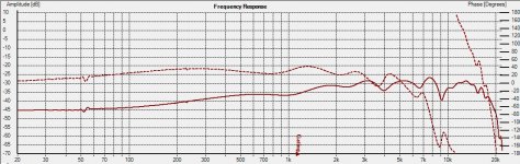

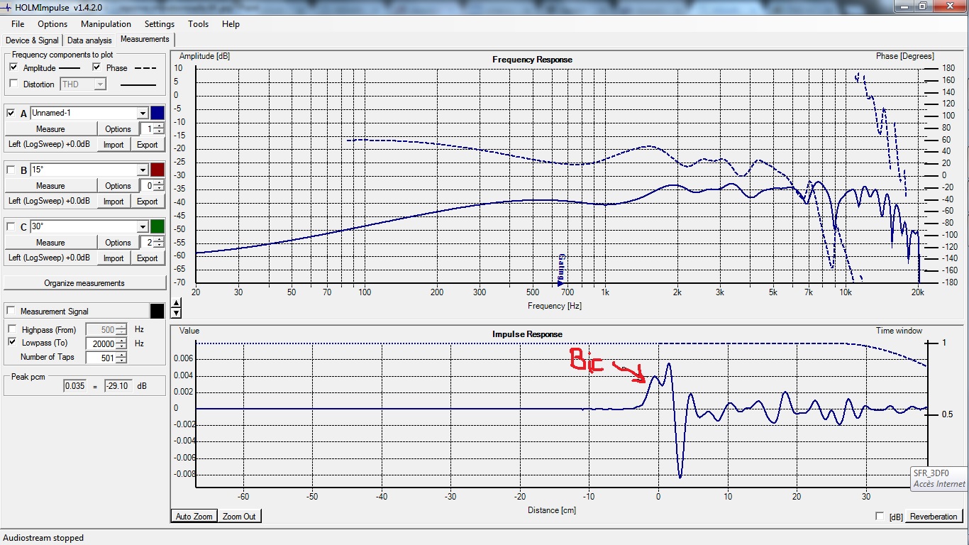

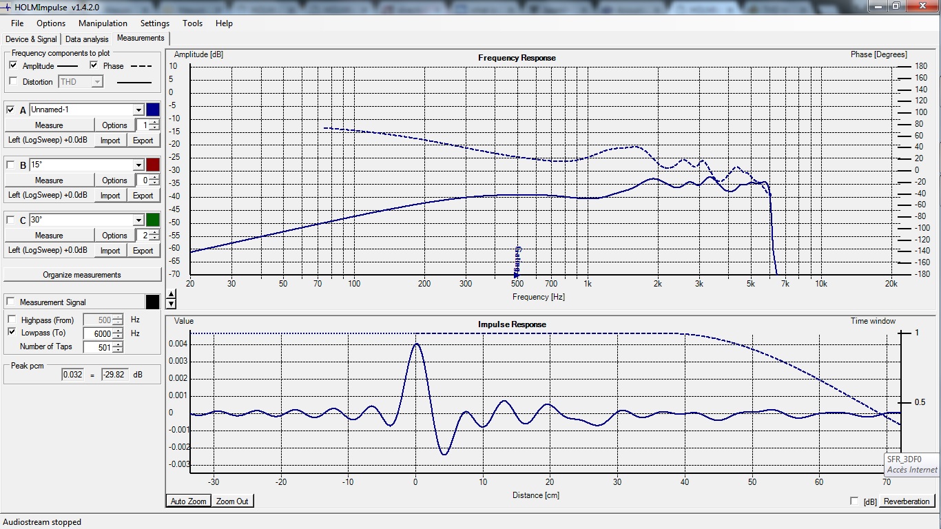

Hi folks,
some measurements here. I've mesured it on a 70L BR 50Hz tuned, reverberant place.
regards,
seb

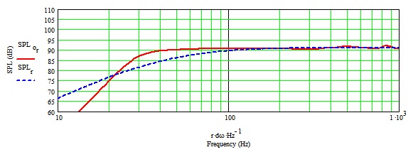

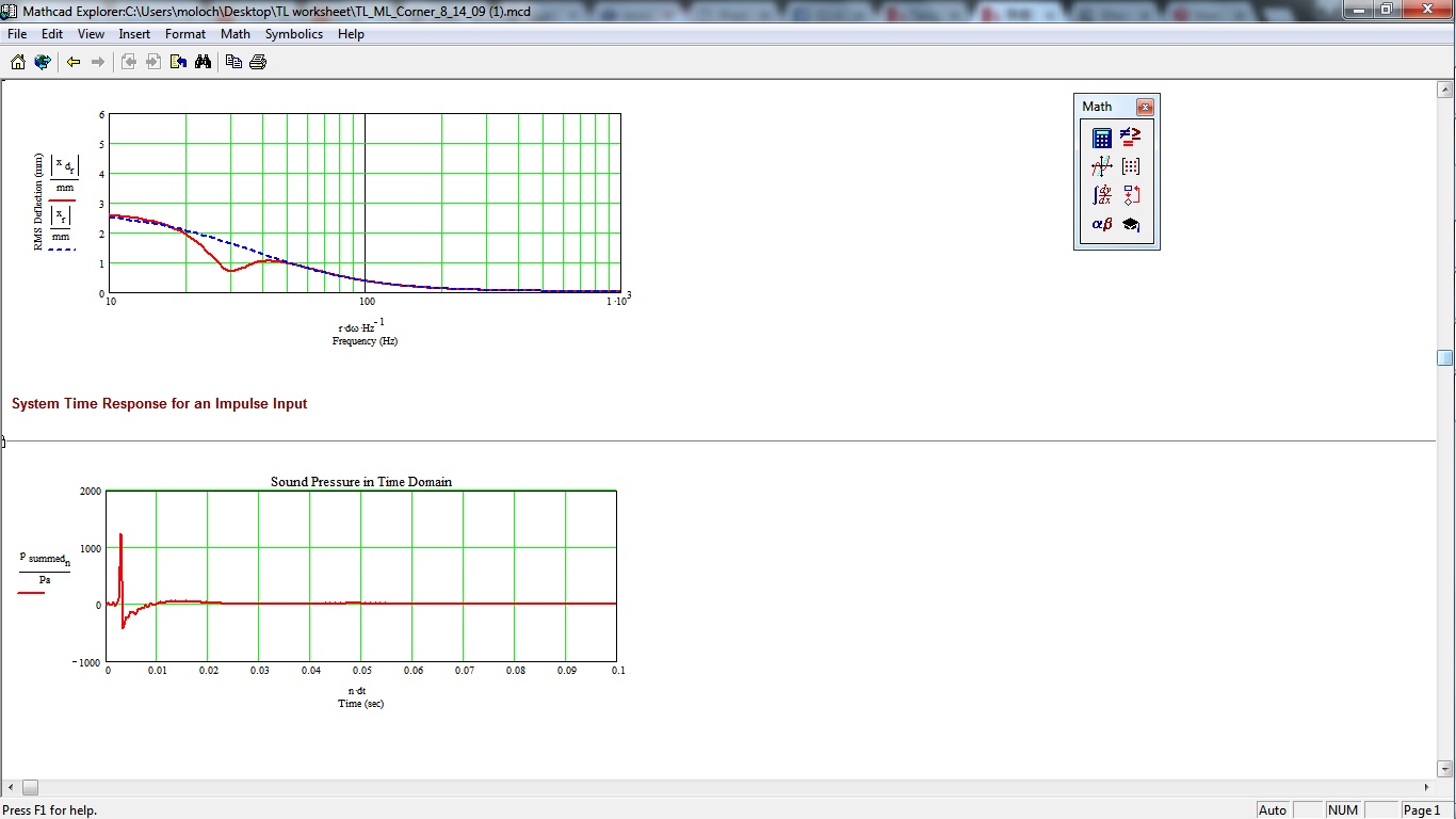

I design a MLTL for the W8 2145
30Hz@-3dB
length: 143cm
CSA 880cm²
driver 62cm from the top
port: 110cm² area, length: 12cm
stuff the up 2/3 with 1Kg of fiber.
regards,
seb
