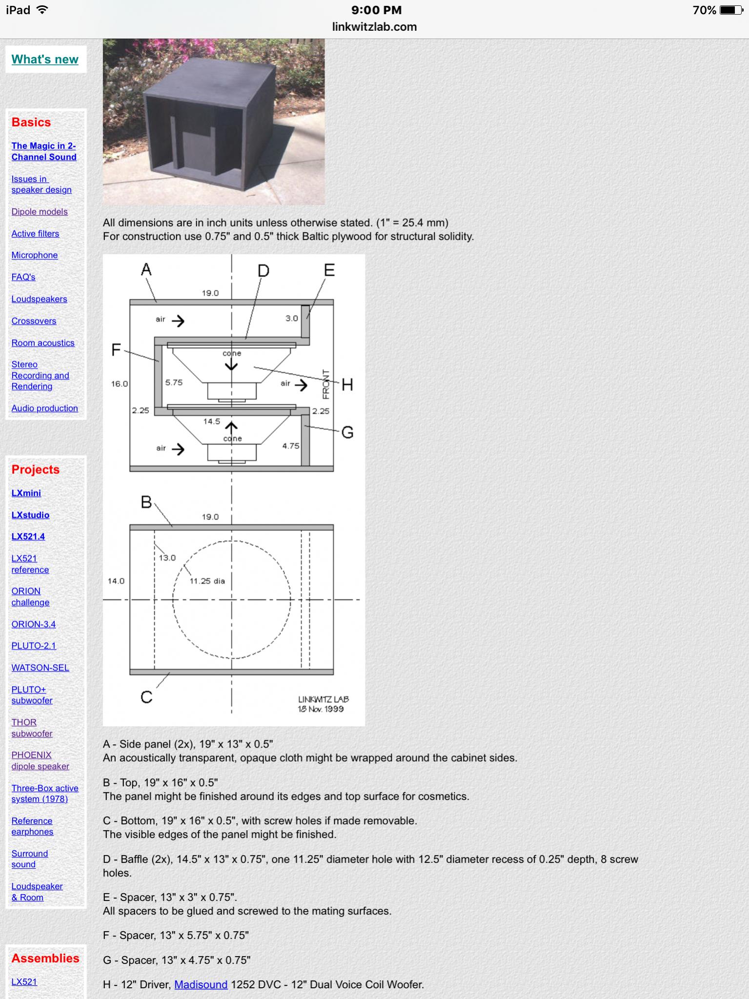

Hi, I've been reading lots about dipoles, hframes etc. I like the W Frame that's listed on Linwwitz site (Phoenix). He uses 2x 12" woofers.
I have on hand 4 Eminence Eminator 2515, I've been considering various alignments for a long time; but I finally have wood now too, so I'm close to cutting now.
These drivers appear to me to have Qts, Fs, and Le that would be appropriate for a dipole, so I may give it a try.
Here's my questions. Please refer to attached pic. The pic is the Linqwitz "plan". I want to be able to use 15" woofers.
Can I simply increase the dimension of panel "D" to something like 17" x 19" to accommodate 15" driver?
Do I understand correct that the "tuning" of the box is mostly determined by the length of panel "A"?
My theorie is that if I leave panel A at 19", that this determines the length of separation between the front wave and back wave. Also it controls the length of the 1/4 wave inside the box. Therefore, if I don't change that length, it should work.
am I on the right track, or should I scale the entire box larger? I have not found a w-frame sim or other design tool yet.

What makes you think these driver specs are appropriate for a dipole? The fs and qts do not allow a simple 2nd order crossover so dsp is going to be required. And the 6 mm xmax isn't much for a dipole sub.
The slots are going to create a cavity resonance, that's not the "tuning", this resonance will occur higher up in frequency, hopefully above your intended passband. The longer the cavity is, the lower in frequency the resonance will occur. Unless you simulate the effect and have a plan to deal with it, you ideally want the cavity(s) to be as short as possible to push the resonance as far above the passband as possible.

Note that they ONLY way he was able to achieve a flat passband with a simple 2nd order filter is because he wisely chose a high qts driver with a reasonable (high) fs. if you have dsp none of this matters so much except xmax. Also note that he limited his cavity depth to 7.5 inches so he could deal with the cavity resonance effectively with his chosen bandwidth with his simple 2nd order filter.
There are a few examples of software that will allow you simulate U baffles, a couple will do H frames, but it's not so easy to simulate the W as shown unless you simulate it as an offset driver mirror image H baffle. In that case I think it would be easy enough to simulate with TL.app or Akabak.

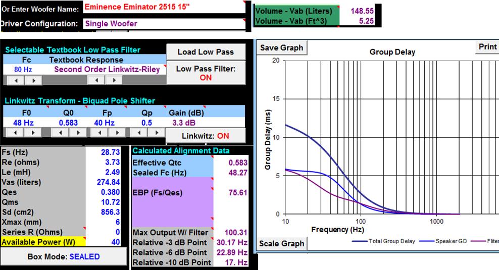

Just a guy, Thank you much for simming that up! I got a copy of hornresp a while back but I haven't found the time to learn how to use it.

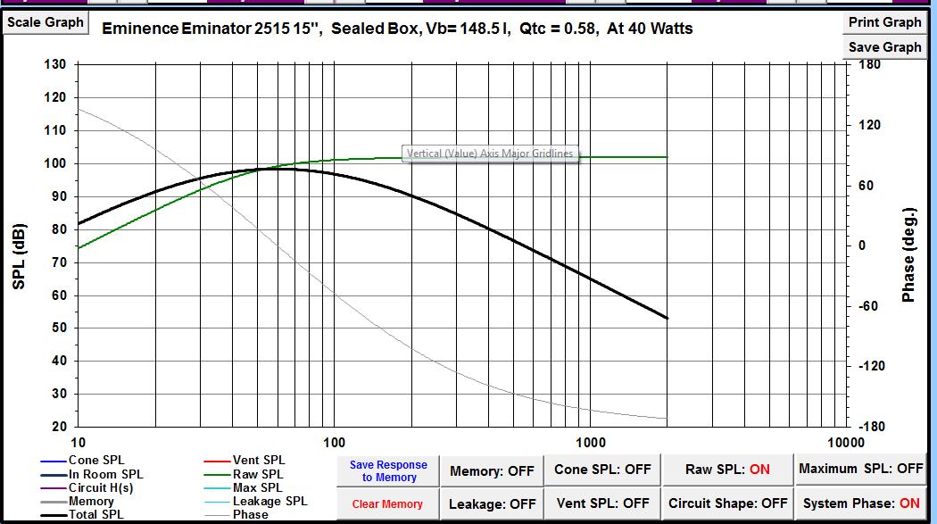

I have an interesting comparison, which is that one of these drivers in a ~145 liter sealed enclosure makes a similar output. ~96dB 31Hz at 6mm excursion. Note that the output was actually higher (with an f3 of around 57hz), but I ate up some of that SPL with a linkwitz-transform filter to achieve the lower frequency. I thought the sealed alignment might have a little "tighter" sound than the BR cabinet that they are currently in.
Being that output is nearly the same between a sealed alignment and the dipole sim you made, I wonder which would sound better to compliment a pair of full range drivers? I guess I could corner-load the sealed box, maybe get a couple more dB of my small / medium sized room. People who love dipoles talk about how clean their sound is, which is a quality I'm looking for....
In the end, I'll likely end up building a car box and sell these car speakers to some kid, meanwhile I'm trying to find the best compromise to use these indoors. At least these drivers were very educational which was a big goal.

I get 102 db at 30 hz from a single driver in a 145 liter sealed box, which is 6 db more than your sim and 4 db more than my dual driver OB sim. In both cases this is not "nearly the same", it's a large difference.
If you are looking to get more spl out of your sealed box then OB is the opposite direction you should be going.
But it depends on your goals. OB does sound lean and clean but they are severely spl limited.
If you want a similar sound to your sealed boxes but you want more spl you could make a ported box with essentially the same frequency response of your sealed box. It would be smaller and it would go much louder if you have the power available to get it to xmax. People usually build "max flat" ported alignments and that's why they sound boomy in room but you don't have to build them that way.

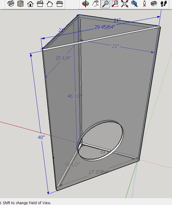

As far as a tapped horn for the Eminators goes, here's a quick stab at a large design that can be a single fold, as simple as it possibly gets. But it's huge at 616 liters and tuned pretty high and might not have any advantage over a ported design. You might be able to get something smaller or a more complex design might have advantages but 2 minutes is about all I have for this. Take the Hornresp inputs and play with the sliders, it's very easy. Then compare to a ported box and see if it's worth the bother of making a horn.
Shown at about 75 watts, single driver single fold design.
I would probably suggest figuring out what is wrong with what you have now and fixing it before scrapping everything and starting over.

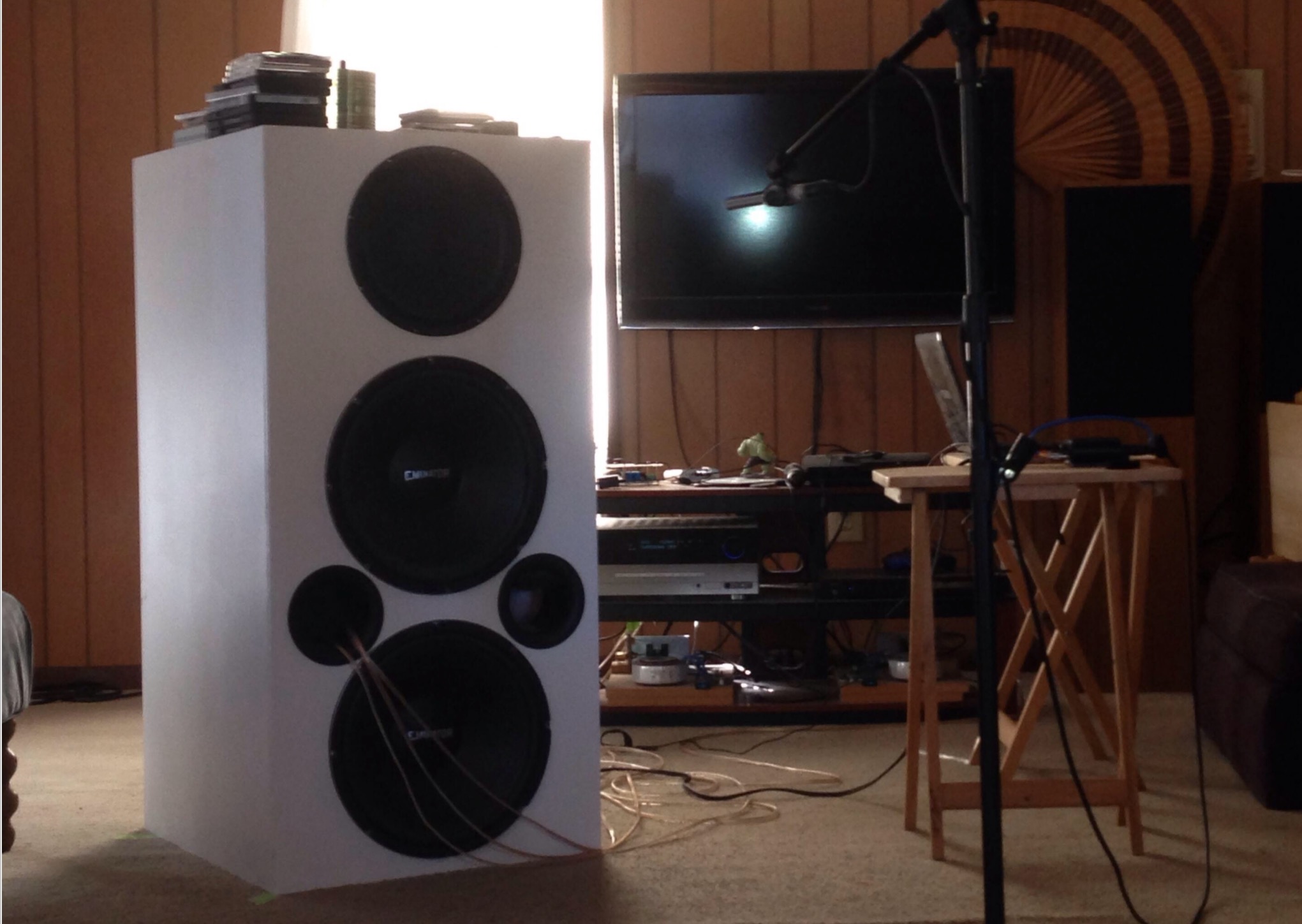

I'm not completely giving up, just changing direction a little. It weighs nearly 250 pounds, and barely fits through a door (see pic). I was dead set on designing my own, my goals were primarily about high efficiency. They're just too big though.
I plan to repurpose the cx12 following a different box plan that others have followed with success. They'll go in the shop, and won't need the woofers. Having lived with cx12 in the living room for half a year or so, I understand what people mean when they describe it as a little forward or shouty.
Full Range will be fun, but this time I'll follow a proven plan and not try to design my own.
To use the 2515 for bass, I think it will likely be temporary until I can upgrade to better woofers. A simple sealed box makes the most sense.

You know you can just stuff those ports and you have a sealed box, right?
You can also add stuffing or solid fill to the box (with or without blocking the ports) and shorten or extend the ports to play with the alignment a bit.
You can also play with the crossover. There are programs that will give professional design results if you can measure impedance and frequency response.

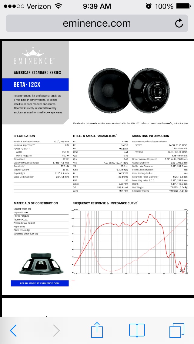

i have no idea what a cx12 is.
Beta 12cx is the midrange w/coaxial tweeter I have in the top of the loudspeaker in the picture above.
