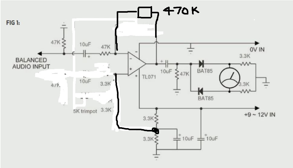

P { margin-bottom: 0.08in; } I've just tested the (original) circuit (s. Attach). It makes absolutely no difference, I still have no meter reaction until really high volumes. Can it be that both meters simpy have a very poor reaction/are really insensitive, as epicyclic (#22) wrote? Considering purchase of another meter!

Just tried it. Absolutely no difference
OK, lets find out why not. I take it you haven't a scope ?
The circuit as redrawn has a gain of 10. Try connecting headphones (with a series resistor to limit volume) across the 47K at the output. That should let you prove the opamp is working OK.
Have you tried reducing the value of the 3.3k resistors ? Go as low 100 ohm, just to see.
You really need to test the meter (its sensitivity) and use a scope to see what's going on in the circuit but you surely should be able to get the meter to move.
A scope makes it very easy as you can see what is going on. If it only moves at high volume then you need to increase the sensitivity (gain). You can increase the 470K upwards and/or also lower the 47K that goes to the inverting input. The ratio of those sets the gain. Its got move at some point. I would also look at whether the diode arrangement is OK. Anything above the turn on voltage of the diodes and the meter should be moving.
O.k., with 470K replaced by 1M it works!A scope makes it very easy as you can see what is going on. If it only moves at high volume then you need to increase the sensitivity (gain). You can increase the 470K upwards and/or also lower the 47K that goes to the inverting input. The ratio of those sets the gain. Its got move at some point. I would also look at whether the diode arrangement is OK. Anything above the turn on voltage of the diodes and the meter should be moving.
So you needed more gain You can go higher still with that if needed.
