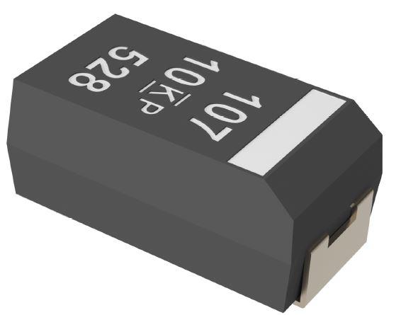

Has anyone tried this?I have used OSCON (Polymer) caps here for their low ESR with good results. They are hard to get in large 1000uF size though.
KEMET KOCAP Polymer Capacitors have become the go-to capacitance solution for applications seeking low ESR, high capacitance, long life, small case size, low profile and high ripple handling. The use of a solid electrolytic capacitor in combination with a conductive polymer cathode yields the most energy dense capacitance solution available in the world with the lowest possible ESR.
http://hu.mouser.com/new/Kemet-Electronics/kemet-kocap-capacitors/
