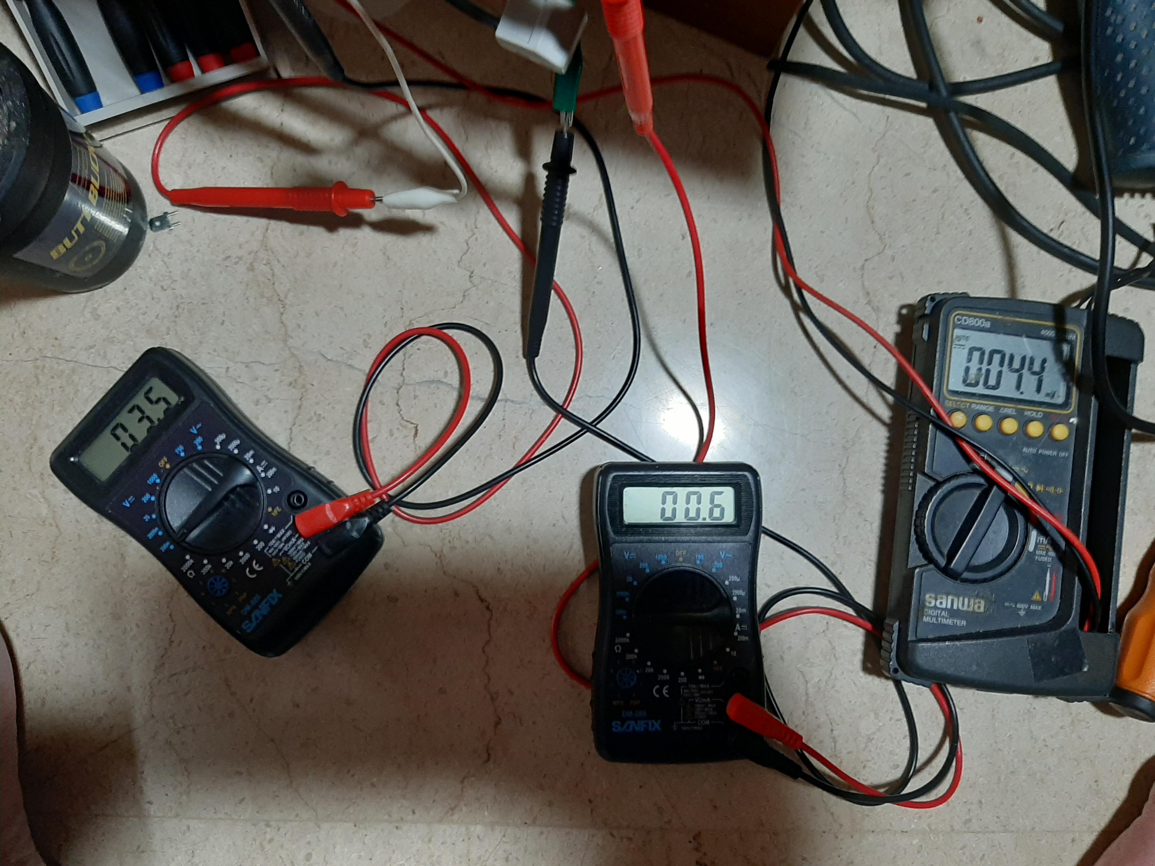

You seem to try to use my USSA/FSSA manual techniques which consists in testing stages in steps before final assembly. If that is the case, can you be more precise on which components are installed or not. Also, the stages tests technique from my manual need to be adapted for different amplifiers. If you do not have the output transistors installed then your front end circuit may be floating...

You are being cautious
Have you tried to connect temporarily a jumper between output and middle of D1 and D2 so to have a closed loop.
Also, your J112 may have very different IDSS values where one is much lower than the other. You can replace the one with another J112
It is an easy circuit to troubleshoot so no worry this should be quite easy.

I have no idea what voltage you are showing. 3.5mv is not 35mv...
With power off measure R3 and R4 as really being 470 ohms as per schematics.
Put a jumper between OUT and junction of D1 and D2.
Set power ON and measure voltage cross R5 and then R6. Divide value by 3300 ohms (as per schematics). This will give you the set ID for each J112. They should be similar value and about in the 1.5ma range. Thus voltage across R5 and R6 to be about 4,95 VDC.
