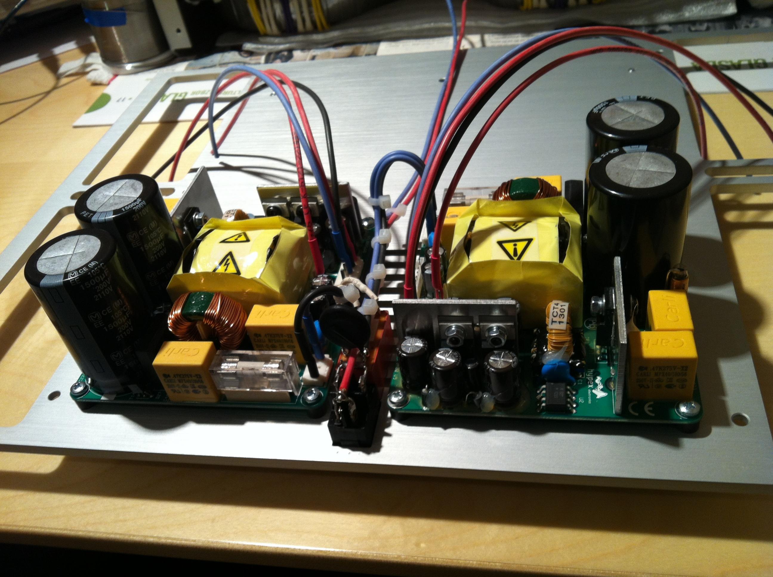

About VSSA building. I will probably finalize my build and listen within 2-3 weeks. So I will hardly be the first one with a working VSSA.

About SMPS. All Hypex SMPS seem same, unregulated. (aux output regulated sometimes) On another dutch forum some speculated that they sounded better than regulated SMPS, and I don't think Hypex is unable to make regulated onces...
Back in march on this forum it was assumed regulated SMPS would be even better than the Hypex SMPS400-180 and would be tried soon. I missed those post about other SMPS that were tried, maybe in Peeceebee tread? Or just too many posts here that I could not find them? Two modified Hypex SMPS 400 will cost me around 250 euro, the coldamps are close in price I believe?
