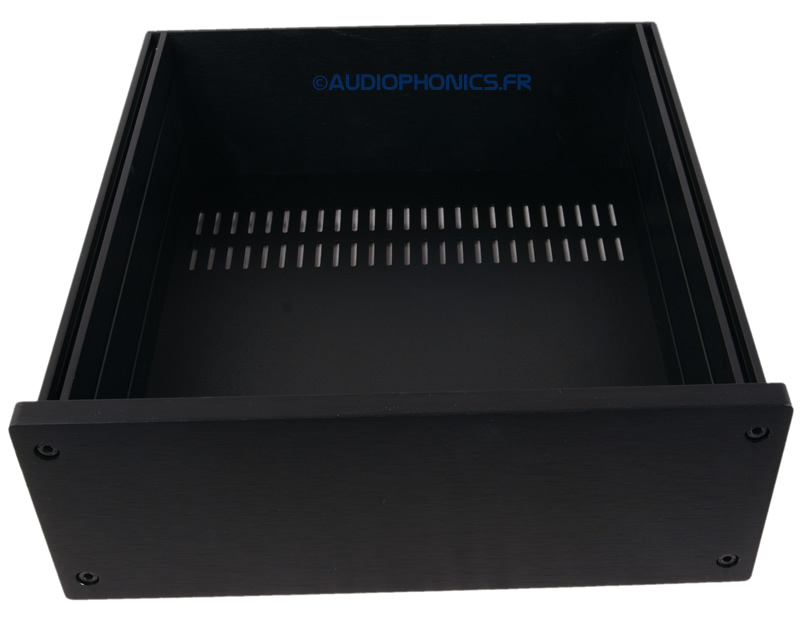

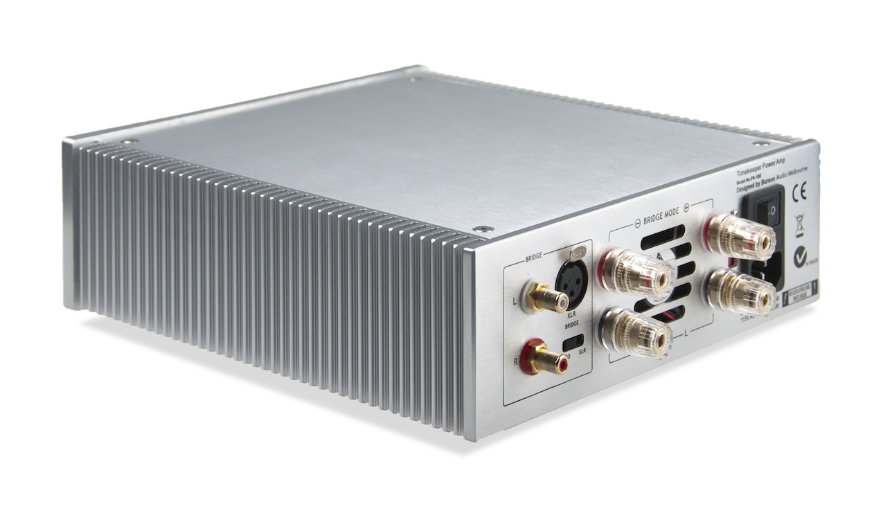

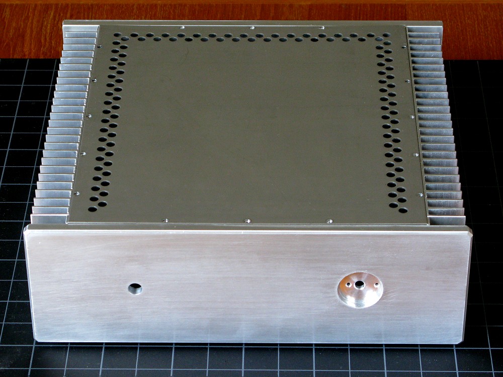

I just received the two little VSSA gems I ordered.Thank you LC!Now the problem is to find an enclosure of the same quality.I personally prefer something like the Timekeeper amplifier of Burson Audio.Any ideas?
That would be great enclosure for VSSA.

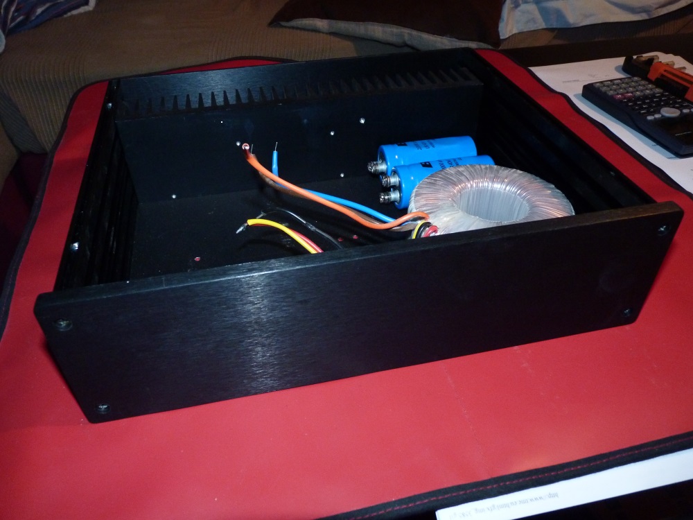

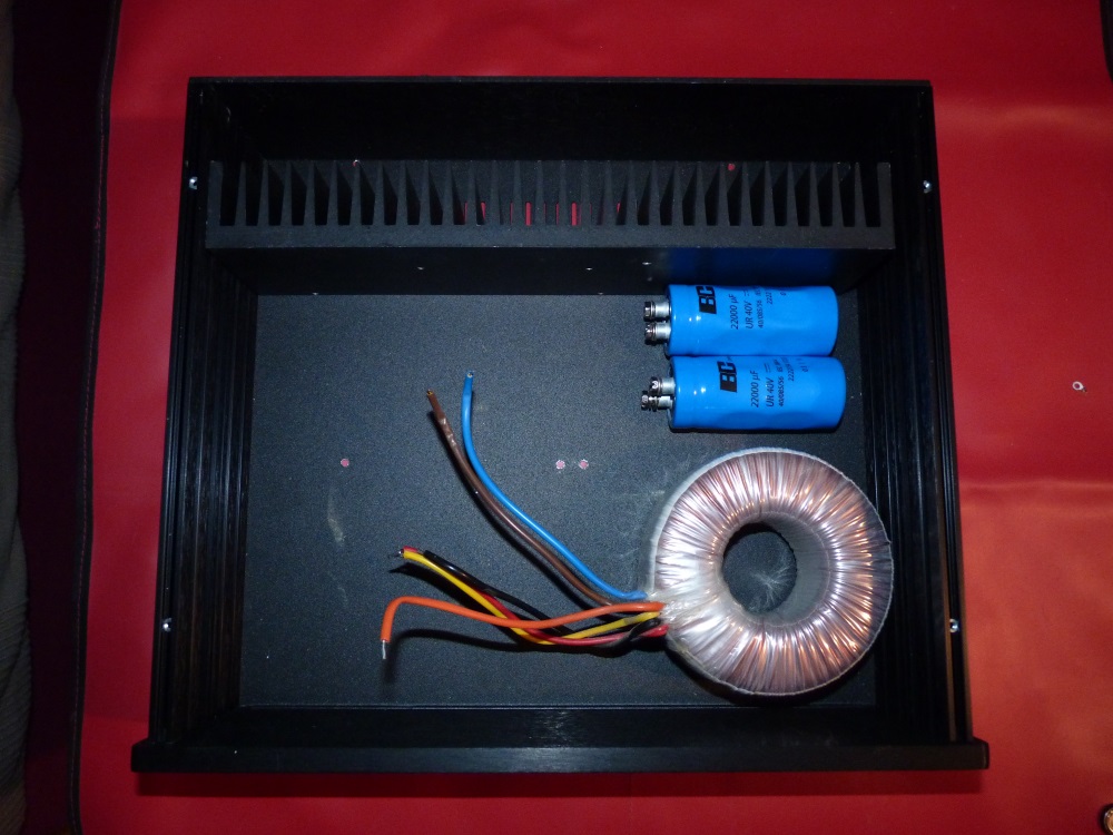

I have for next months not so many time and budget to put in Diyaudio so i decided to explore my basement stock to see what could be use to build LC-VSSA on faster and cheapest side. Two picture above what i selected
- 2 enclosures 330x80mm face and 280mm deep
- 2 FISCHER ELEKTRONIK SK56/75 rated 0.45K/W each
- 2 toroids rated 300Va 2x25Vac
- 4 BComponent 22.000µF/40V screw caps

looks like modushop slimline
in forum store its called quasi heatsink due to the exstruded alu sides
I had not thought of putting the heatsink inside
but might be a great idea if its properly vented
Not exactly....it's galaxy line from same company. As you can see on picture the under cover is vented as the uper cover the same way. These vents holes cover the whole heatsink fins son no issue for me.

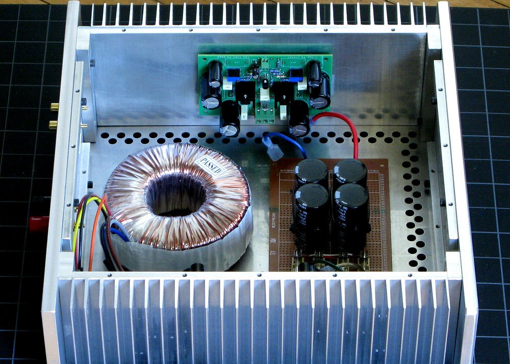

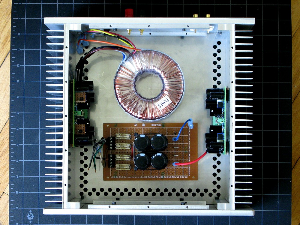

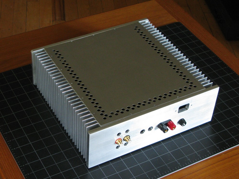

Yes, find a friendly local machine shop. They are a great resource, and these days they can usually use the business...Now the problem is to find an enclosure of the same quality.I personally prefer something like the Timekeeper amplifier of Burson Audio.Any ideas?

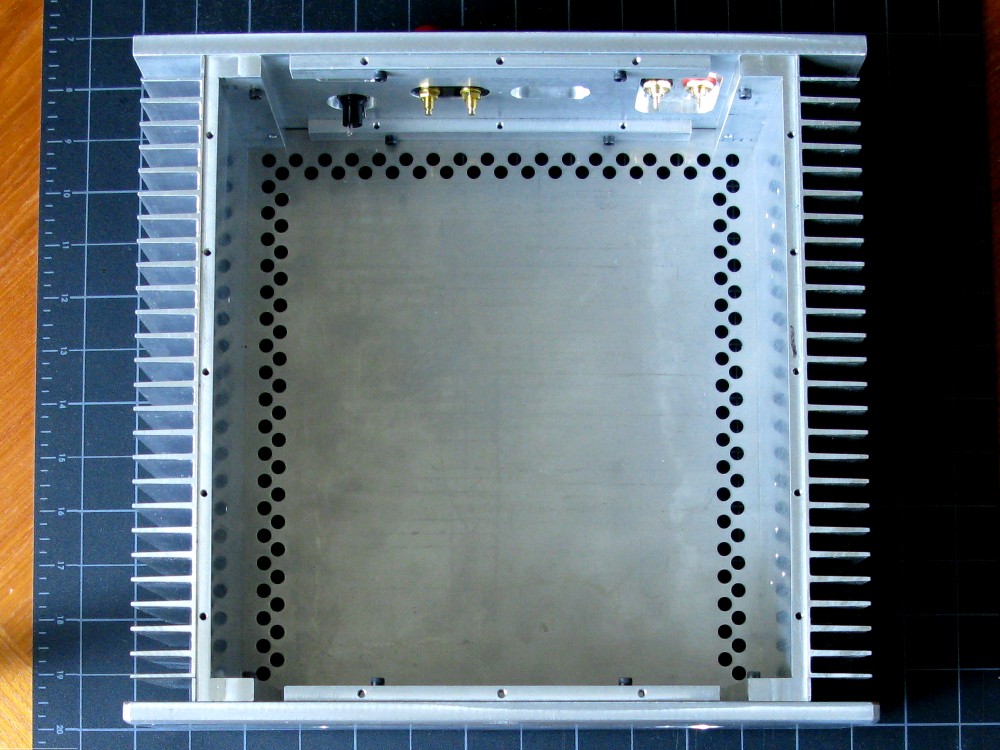

I like that look too. Simple, clean, practical. The pics below are a prototype of my new chassis. There is no finish on the metal parts, and the transformer and simple supply are there just for scale in the pics. Almost the same size as the Timekeeper, I think. For VSSA, I plan to use the same thing, but with a different rear panel and a simple front.
The board in the pics is my through-hole version (see Shaan's Pee-Cee-Bee thread), but LC's boards will go in the same place in a chassis the same size.
One word of caution: The Timekeeper has a 300VA transformer and a closed chassis. I think it depends on a fan for cooling at its rated output. I am depending on vents top an bottom, and I will probably need more than those shown. Something to keep in mind...
Marc
ah, yes ofcourse
Slimline is a new enlarged version, mixing Galaxy and Pesante parts

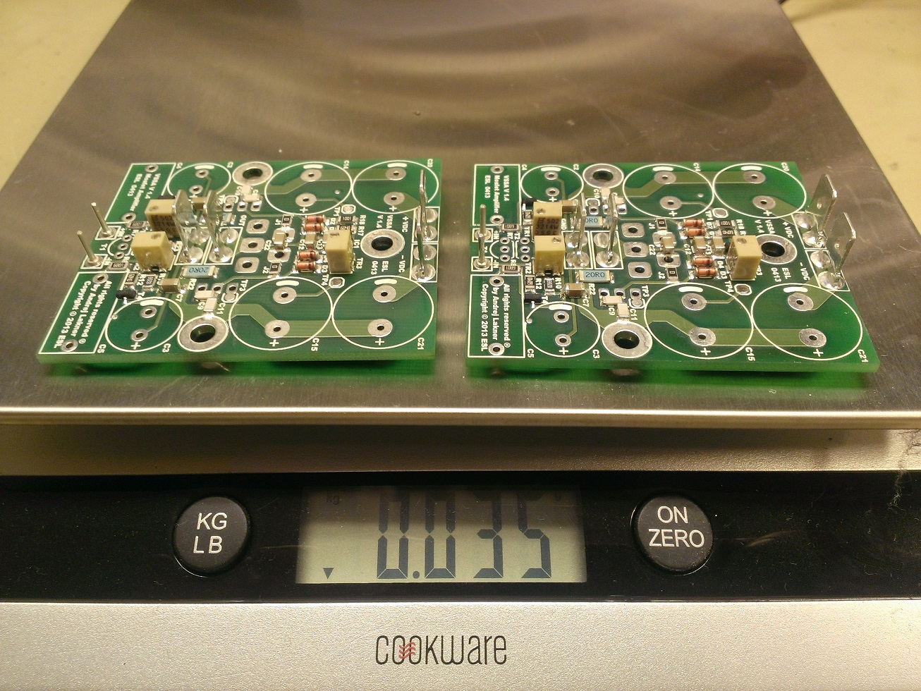

Featherweight Audio ... Weight increase this weekend.
35 g for stereo
Please weight and show us both finished PCB modules.
Hardly wait to see your final implementation.
