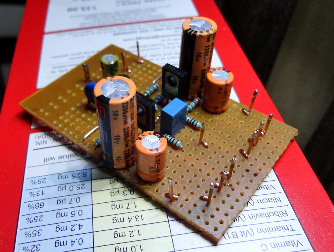

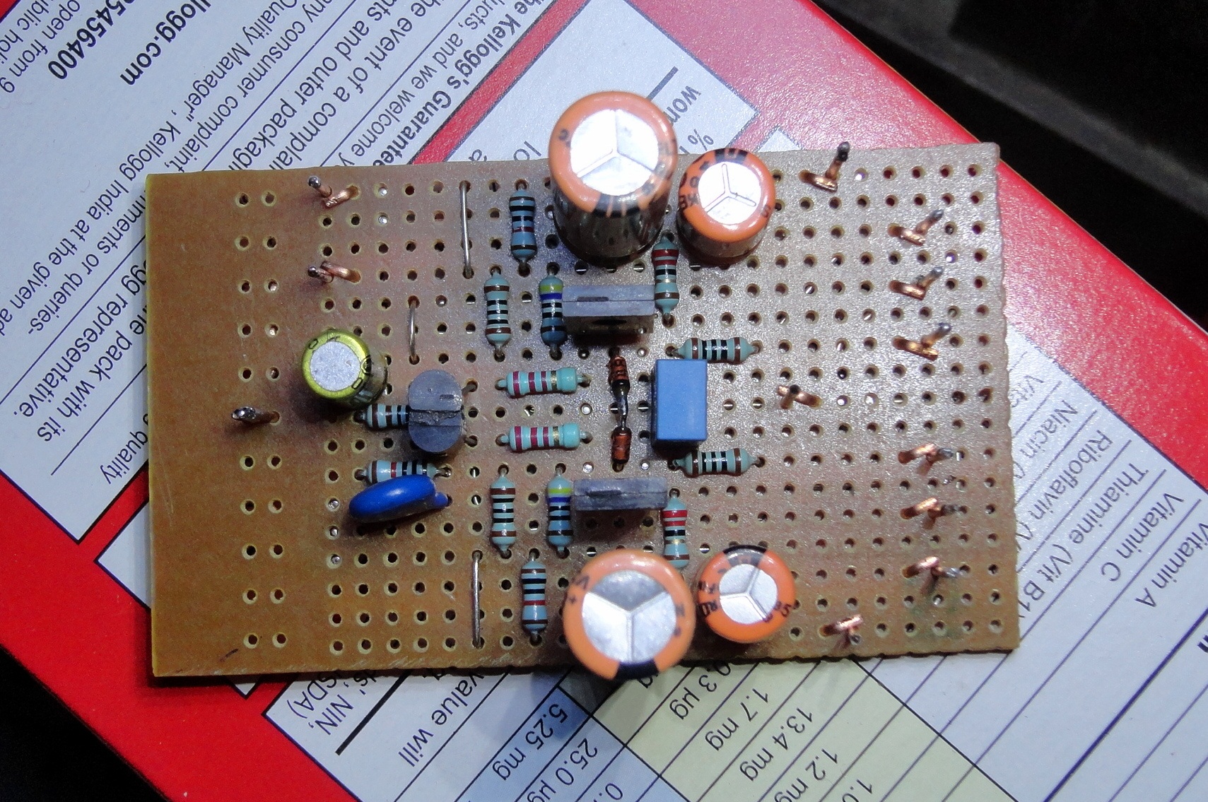

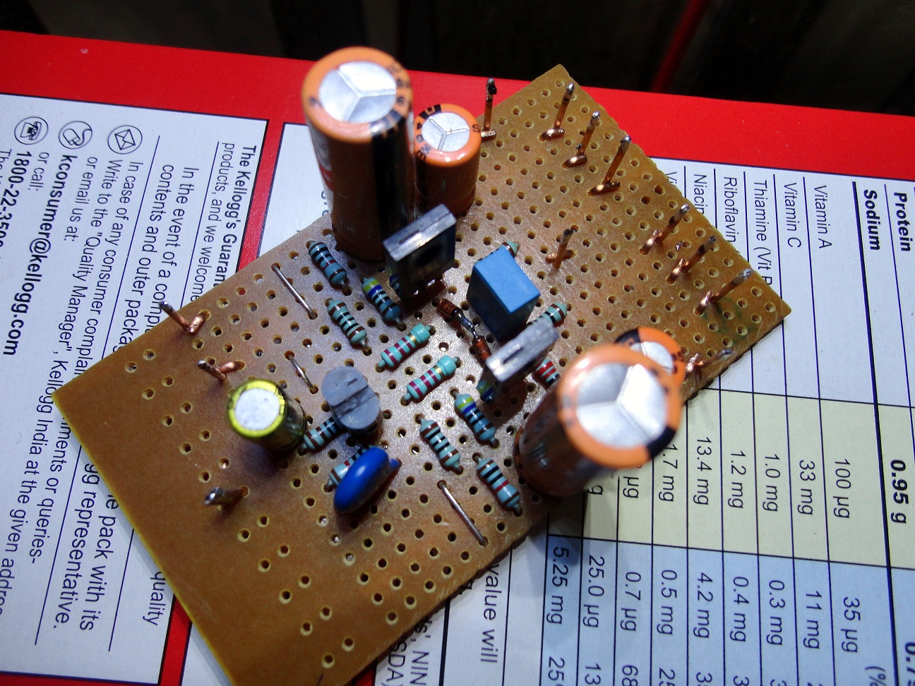

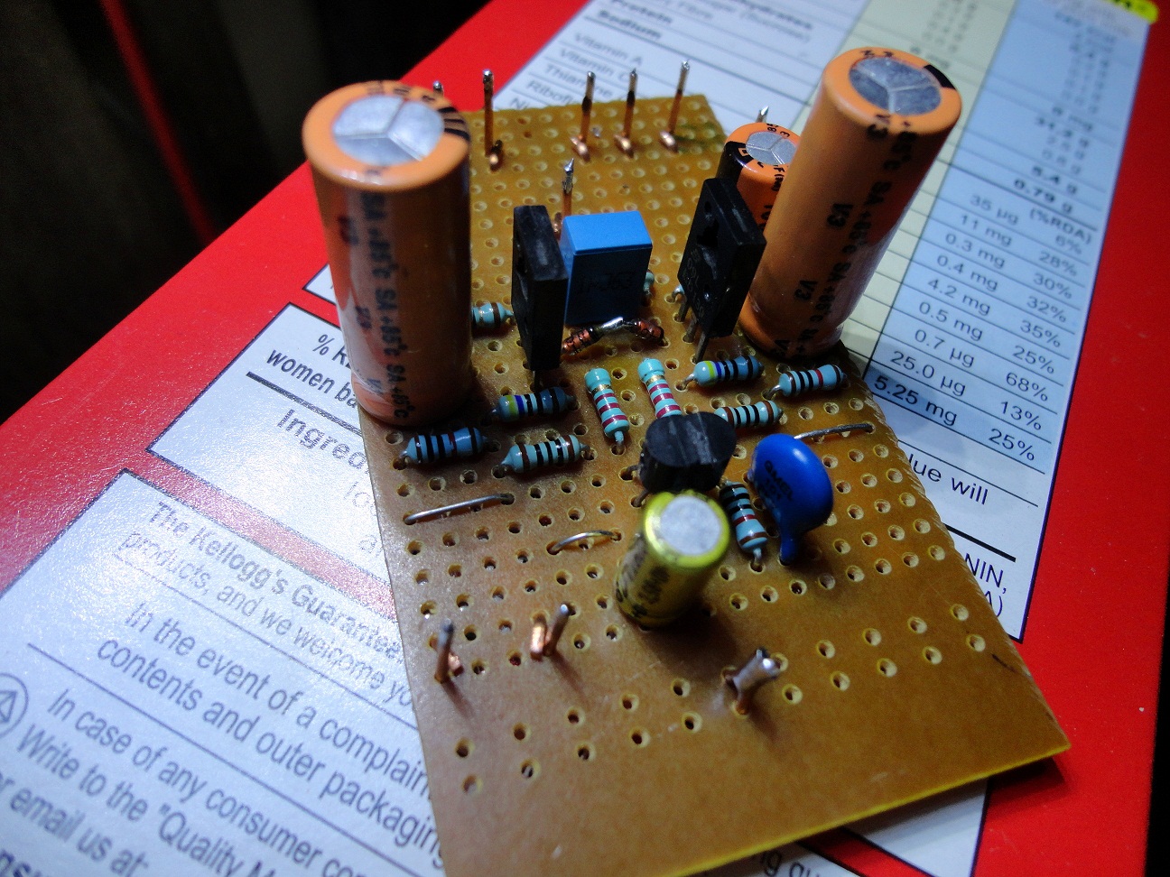

Here are some shots of my poor-man's VSSA on vero. The under-board connections took the least time among all SSA attempts. Very Simple indeed.
Cheers...

Hi Shaan,
Is that the 1.4 version of VSSA? what current source did you use?

Very nice build, congratulations Shaan!
So, wich one sounds best to you - your version of the SSA or the VSSA?

Hi fred.
Here are the details. My build is closer to the attachment of the first post of this thread, with some preferences which are:
1. 10uF nonpolar electro coupled input.
2. 16V psu. Hence 10k current source resistors(I thhink 6k8 would be more adequate for this voltage, though).
3. 2k2/100R feedback network.
4. 2200uF/16V feedback cap(alone, nothing in parallel).
5. BD139/140 VAS, no heatsink.
6. 22ohm VAS degenerator.
7. 100uF onboard supply decouplers.
8. No Zobel.
9. Hitachi FET output.
10. Two diode FET bias(old habit ).
11. And just a 200k in parallel with the -ve current source resistor locks the offset to +1mV.
Thanks Paulo.
VSSA, although that simple an amp, has the same 'standstill' effect as the SSA, i.e. the whole music piece feels live, especially with eyes closed(causing goosebumps), huge soundstage(what you too have noticed in your SSA). I can listen to it all day; no fatigue.
So, to me, both these amps are equally excellent sounding gadgets. But VSSA wins the trophy as it has superb offset characteristics and gives the same level of quality and satisfaction with almost half the parts count.
