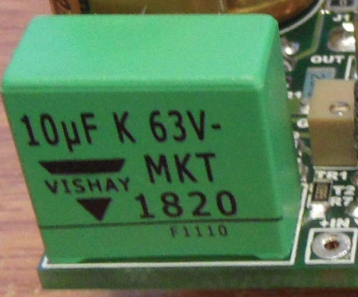

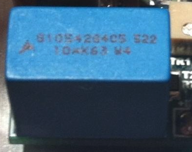

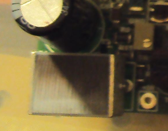

More spy info see picture from "First One" prestage. If it's SMD-film, SMD-ceramic or changed since don't now (Link: http://www.diyaudio.com/forums/solid-state/239708-vssa-50-a-5.html#post3598917).
Replaced with Vishay film cap, just as in VSSA. All parts individualy tested for new First One amp, priority is of course sound quality. Right now first new First One PCB is in assembly process.
What about 2m2F//10uF SMD//small film caps, like 0n3F to 1uF?
Where do you guys source your Vishay's?

A try, the first i bought myself (WIMA) and fits 100% and at same it's Mouser Chile link, last four links to Farnell (Element14) Denmark then change countrysite and see if it works, good surfing...........Where do you guys source your Vishay's? ..........
MKS4B051004J00KSSD WIMA | Mouser
MKT1820610065 - VISHAY ROEDERSTEIN - CAP, FILM, 10UF, 10%, 63V, RADIAL | Farnell Danmark
B32562J1106K - EPCOS - CAPACITOR, 10UF, 100V | Farnell Danmark
B32522C106K - EPCOS - CAPACITOR POLY FILM 10UF 63V 10 | Farnell Danmark
B32523Q106K - EPCOS - CAPACITOR, 10UF, 63V | Farnell Danmark

Hello Max,
I bought them here:
5x MKT Kondensator radial 10uF 63VDC RM15 ; RoHS ; MKT1820610065 | eBay
