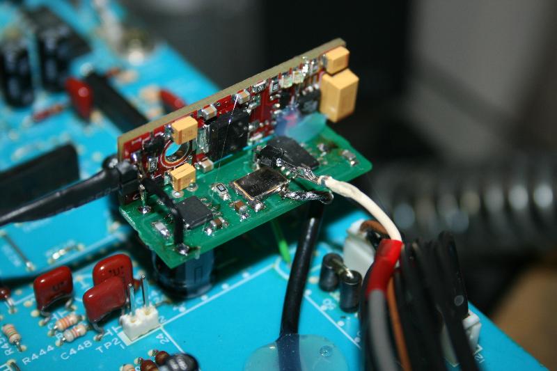

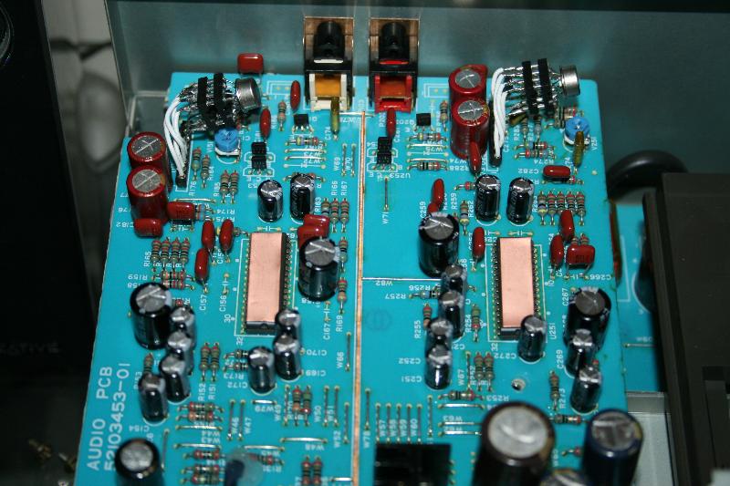

Hi Pani
I've just modded my friends VRDS10 and its very very good.
I myself have a heavily modded philips CD960 (same as marantz 94) and it was annoyingly close in std form!
I have reclocked using an audioupgrades.co.uk C1.This feeds the original location (I forget the Sony chip no) and also directly feeds the SAA7350. I also use a /2 clock output to drive the pair of TDA1547 (DAC7) direct (not via all the other chips).
I've recapped the DAC board completely using Rubycon ZA's for decoupling (mainly 100uf but a few 220's) and used panasonic FC on pre reg as smoothers. I've also hooked in LME49720's to replace the std horrible opamps.
What a difference! this player something to be beheld! I'm pretty certain i'm only scratching the surface. No dedicated regs as yet (except the clock supply).
1 word of caution, the belts (2 of them) on the deck will wear and need replacing, but then what belts don't eventiually!;)
You can see the caps, clock feed to the TDA and the opapmps below!
