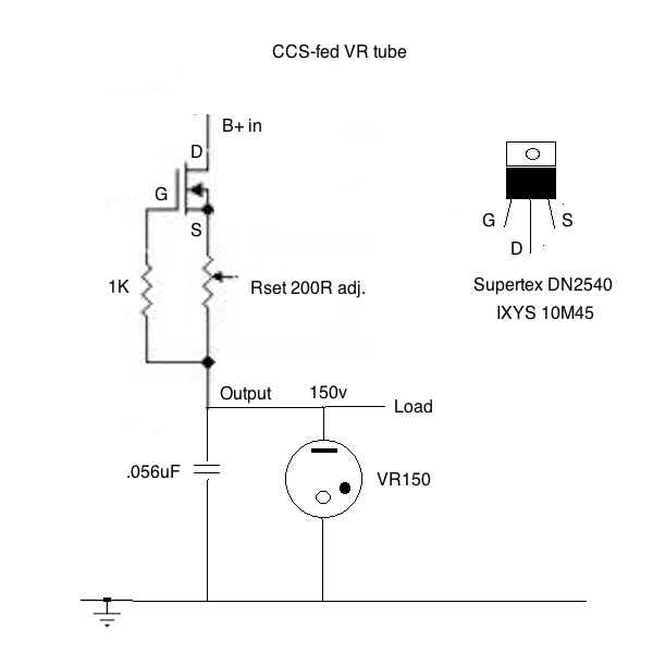

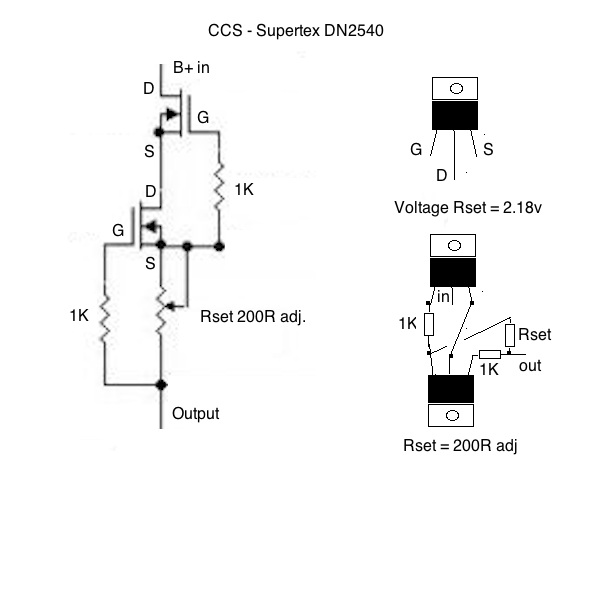

I tried feeding a VR150 with a DN2540 and then with an IXYS 10M45. Both worked OK. For 58mA (36mA load plus 22v for the VR150) with a dropper resistor the B+ before the resistor is 200v. With the IXYS it's 180v. With the Supertex it's 172v. In all cases the VR150 lights up.
The stated strike voltage is 185v with a resistor. In both cases, with the active devices, the strike voltage is less than that.
Can anyone explain this?
Explain what? The voltage drop across the upper element during normal operation has nothing to do with striking voltage. Striking voltage is the applied voltage at which the regulator begins to conduct, thus reducing the applied voltage. This tells you nothing about the voltage on the other end of the resistor/CCS.
I think it's fair to ask for an explanation of how to use VR tubes with a CCS - there's nothing in the data sheets or application notes about this since they were written before such devices were used. We know the voltage on the load which is 150v in the case of a 0D3, and we have the "headroom" needed for a VR to strike with a resistor, which is 35v above 150v.
My question is what headroom do you need with a CCS? In previous posts it's stated "apply any voltage to the CCS and it will do it's job", but is there a minimum voltage that needs to be supplied to the CCS above the 150v? And does this headroom change for one or two devices?
Any CCS will have a minimum voltage for normal operation, but remember that a non-conductive VR will take very little current (almost zero) so the CCS will probably have very little voltage drop across it at first. However, once the VR strikes the CCS must be able to supply the required current.
Your question is actually about CCS, not VRs!
If the CCS drops too much voltage for VR striking but is OK when running normally then you can add a resistor and diode to fix this situation, provided that the supply rail is above the strking voltage. The CCS feeds the load, whatever that is. A high value resistor (few hundred k ish) feed the VR and ensures striking. A rectifier diode connects the two junctions together, arranged so that it is reverse biased before striking but forward biased once the VR pulls its side down. You can see a similar arrangement here, although for different reasons.
