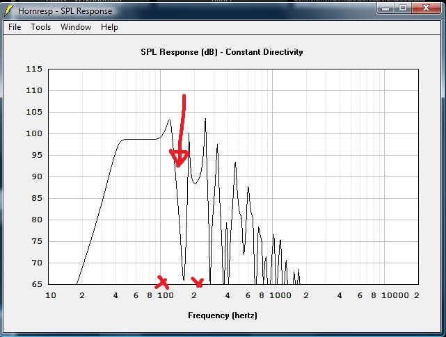

Do you care to elaborate? Where does this occur, what frequency?
See attached image, which is the sim'd FR of the Volvotreter 6.5 TH, with the recommended series inductors (it's worse without the inductors). I've illustrated the problematic area, which occurs just above the 100 Hz passband.
It's quite likely that this notch can be avoided with a properly-designed offset TL or MLTL.

Interesting, thanks. My aim is to make a pair from these TB 6.5"s and cross over at 120hz. Both designers say that the simulated irratic FR is less noticeable in real life and the design of the THAM series says he crosses over at 200hz.
I am in my infancy of speaker design, I am competent at bass reflex (thanks to your help), would the design styles you mention be punching above my skill-weight?
The reason I have looked at this is it would be an interesting first time foray in to tapped horns. Also, space is an issue that the Volvotreter design fits perfectly in to.
I can honestly say that the notch is not really there. (on both designs) And I did REW measurement in my home from 10hz to 300hz. I will try to find them on my laptop. but it was years ago.
If the notch was not there, then that means that the sim does not match the actual build, another reason to avoid it.
Look, I'm not saying that these designs are bad. I'm saying that it should be possible to do better - basically come up with an alignment that had a smooth response for about an octave above the upper part of the design passband, which will make x-over work a bit easier.
Thanks Brian. Yes, that is logical. I think redesigning it is a bit beyond my realms of skill. However, can I pass(band) the gauntlet to you? hehe
I totally agree with you Brian. both the Volvo and tham6 designs can be improved a lot or can be surpassed by better other designs
