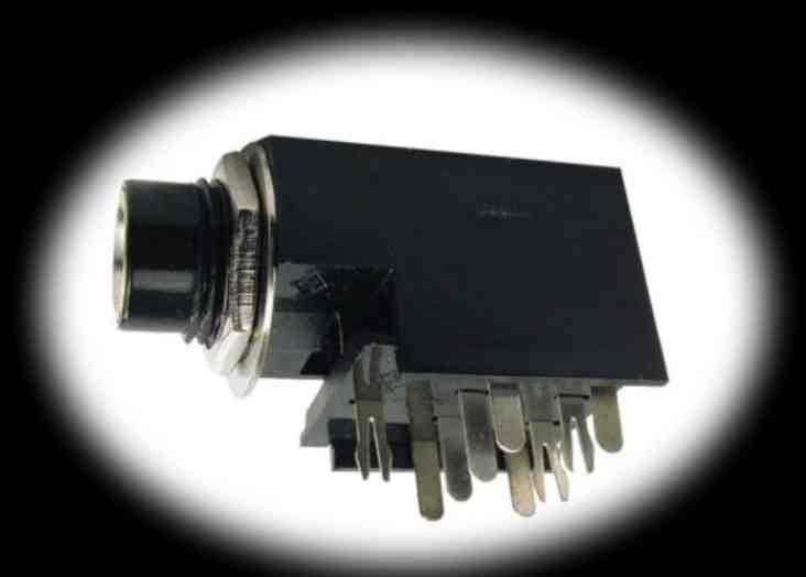

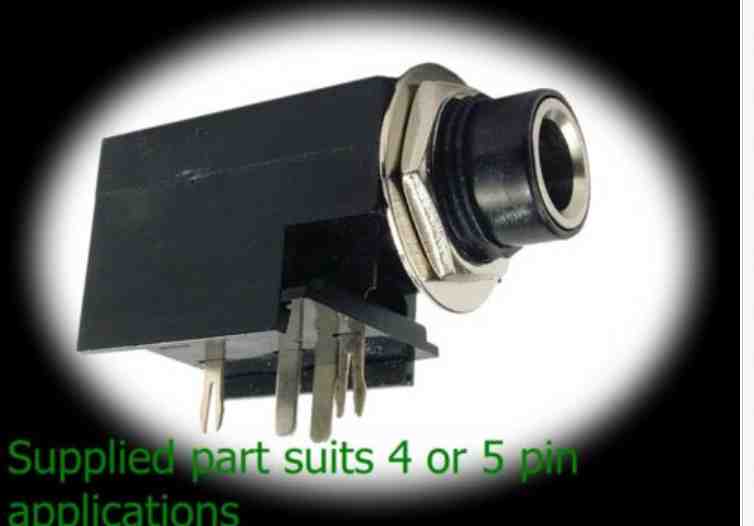

I was looking for common faults on this amp and came across this thread. I also had the fault with volume changing between high and low, which started after 10~15 mins of heating up and would keep varying every few mins or so. I found three possible causes, all mechanical. I fixed all three at the same time and this cured the fault. It was either fault, 2, 3 or 4 below. The most likely cause of my fault on my amp was the loop level switch. I say this because my amp was going from two distinct volumes, not varying slowly. If the switch goes open circuit due to bad contacts, it will set the line out to high, and line in to low level, and the amp will go very loud.
Since I couldn’t find any advice on common faults, I’ll pay it forward here’s what I found when I put in the time to investigate. These will be common faults on this amp if its never been looked at.
1. I bought mine new in 1988 and one of the front ¼” jack sockets had broken off many years ago. It still worked so I left it until recently. It was much easier now (with the internet) to find replacement ones on ebay and swap them out. The front sockets are all stereo ones and look like the replacements shown in the attachment (the one with more tabs) The original had pins where this one has tabs. Its easy enough to file the tabs so the fit the PCB, just use a fine file though. All the plastic ¼” sockets need replacing. The plastic just crumbled as I unscrewed them from the panel. You need this type so they will fit physically, although it is always possible to work round it if you are desperate.
2. The ¼” sockets on the rear of the amp all need replacing. They are all mono and look like the other attachement (the one with less tabs). The power amp in on the effects loop (rear of amp) has the preamp signal going through it all the time. Dirty contacts in here are a potential source of the volume fluxuations. You could try contact cleaner and pushing a plug in and out but the socket needs replaced by now anyway because the plastic will have deteriorated.
3. The speaker impedance selector switch on the rear needed cleaning. It is possible to undo the tabs on the switch body so you can open it up and clean it properly. This could be a source of varying volume.
4. The loop level switch needs cleaning. I was amazed how dirty he contacts were. Same as the speaker impedance switch, you can dismantle the switch by bending the small tabs and pulling the back off. The contacts will fall out so be careful, but its obvious how to put them back. The signal out of the preamp will go through this switch at all times, even if you don’t use the line out feature.
