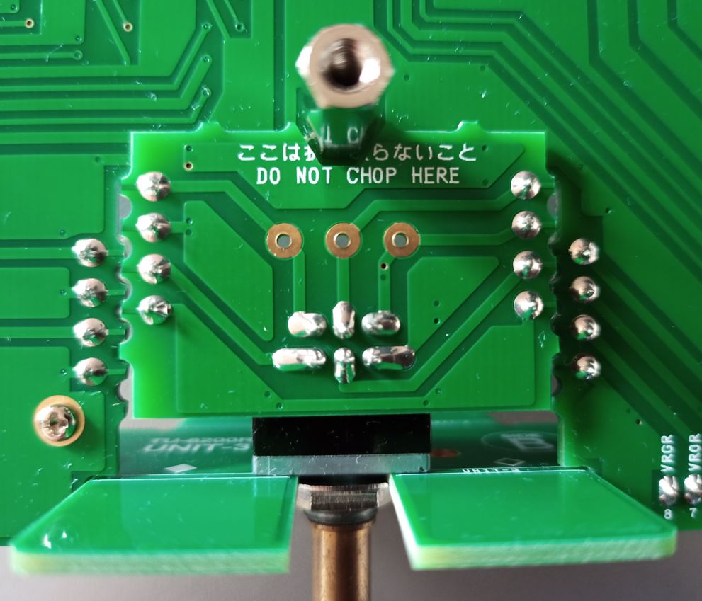

I did an Alps R27 in my original TU-8200. Requires snipping off the board where the pot mounts, then I used 8 leads cut from a capacitor upgrade (Mundorf). As it was over a year ago I don't recall the exact order but I seem to recall it was a royal pain - lots of work and rework in getting everything to fit properly. I think I soldered the pins to the snipped off portion of the board first, then mounted everything, and finally soldered the pins to the remaining portion of the Unit 2 board.
I only have one photo of the assembly with me right now and it is hard to tell exactly what I did other than my memory of lots of swearing.

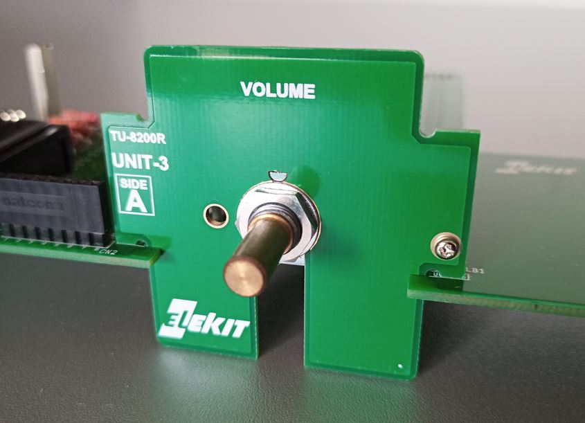

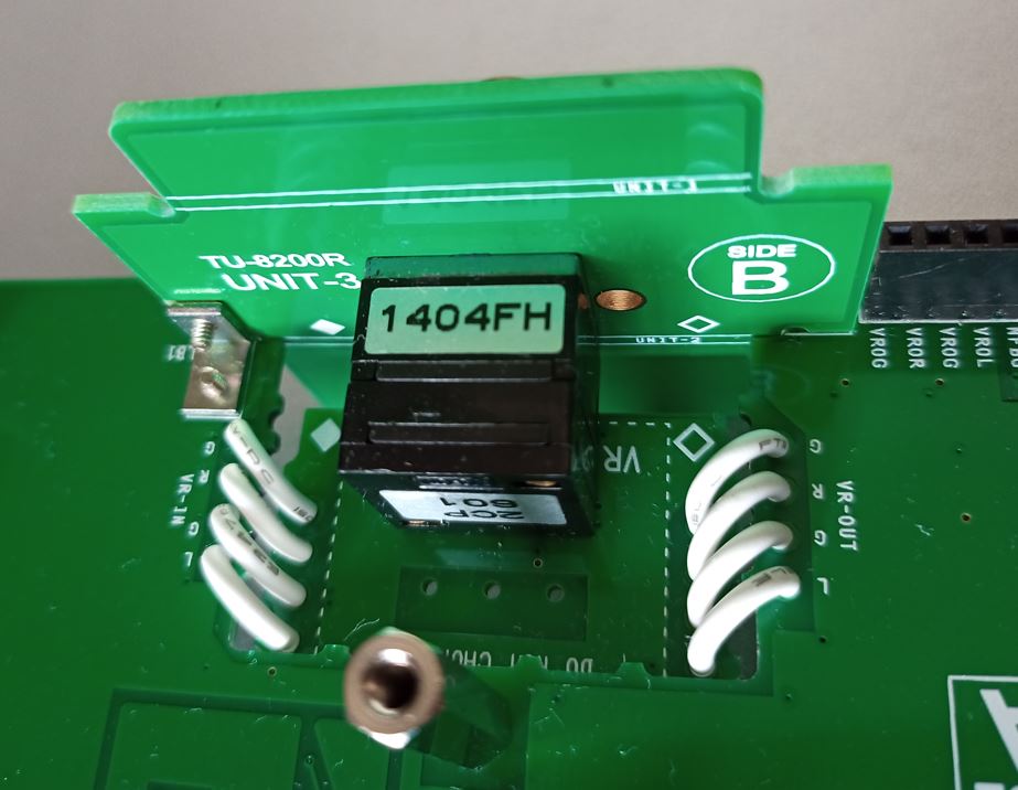

I did it on my TU-8200R. Maybe my photos can help you.
Thank for the pics milanstastny! Ive read how to do it, but was never sure enough. Great help to actually see! I have a small stepped attenuator that will have to be mounted like this.
blimey that is a neat neat job. Top of the class. This has inspire me to look at the TU-8600S I have. Thank you.I did it on my TU-8200R. Maybe my photos can help you.
Hi friend, thank you very much. I think for the TU-8600S you need a special unit 2 PCB for TKD pot. It should be easy to install it. You can buy it from Victor or I can send you mine for free, as I will not need it very probably. I can give you one new TKD 2CP601S as well.blimey that is a neat neat job. Top of the class. This has inspire me to look at the TU-8600S I have. Thank you.

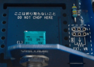

Not enough space for TKD or ALPS R27
Reg. TU-8500: Just wondering, can't the "DO NOT CHOP HERE" piece be cut out to fit a bigger pot, like a TKD or ALPS R27? Wires would then go to the holes on the right of the picture.
