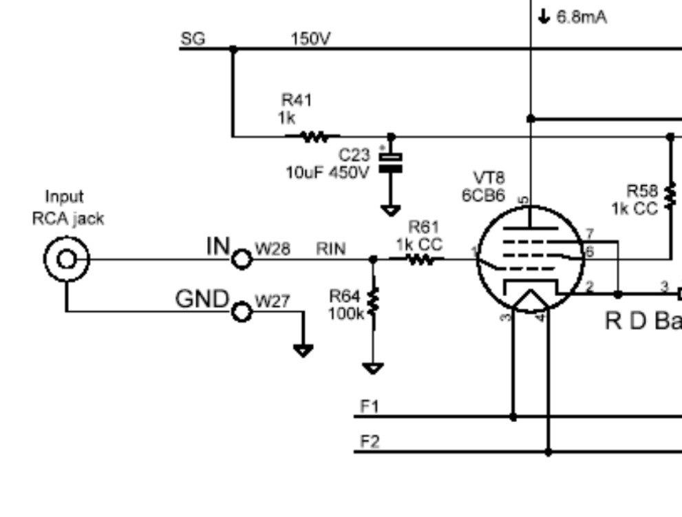

I’ve recently (almost) finished my amplifier, and I’m having trouble with the volume pot. I wasn’t going to add one, but my current phono pre amp doesn’t have one, so why not…
It’s an Audio Note 100k log volume pot, so not some cheap thing. Under normal circumstances it is pretty scratchy sounding particularly in the left channel only when adjusting the pot. I normally leave it at full volume except for vinyl listening, and bias checking, so the scratching sound is not too big of a deal. Today I was listening for about two hours, and noticed a scratchy sound; I was listening with a low input volume, and the scratchy sound was pretty loud. I adjusted the volume pot slightly, as I immediately suspected the pot, and got a very loud noise on the left channel. No abnormal temperatures, voltages, or bias anomalies.
Did I get a defective part, or is there another likely explanation?
I have the wiper of the pot going to R61, and the full resistance of the pot basically replaces R64

Sounds like thunder, correct? It seems there is some direct current present across the wiper, ie the center tap of the potentiometer, originating from the source or the tube’s grid. Any potential on the grid stop resistor will cause a small current to flow. A signal coupling capacitor between the wiper and R61 is one remedy.
DC seems likely; although I haven’t attempted to measure anything yet, sound with no signal has to be originating somewhere. It would seem to make sense that it’s coming from the amp, as it’s scratching just the same with no input. It is also the same from my music streamer, or from the DSP output of my subwoofer.

Not too keen on a coupling cap, but could try it. Would a high value (~1M) resistor from the wiper to ground help?A signal coupling capacitor between the wiper and R61 is one remedy.

Yes. If the wiper loses contact, the grid has no DC path to ground. That causes the loud noise.Not too keen on a coupling cap, but could try it. Would a high value (~1M) resistor from the wiper to ground help?

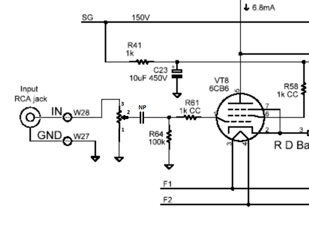

I made my intial response under the impression the potentiometer was new, so I’m glad to read it is. I would draw a schematic and calculate the time constant if I was home, but the first approach I would investigate would be as follows: After the input RCA jacks would be the input RFI lowpass filter, then the signal coupling cap, then the pot, then a ground reference resistor and the series grid stopper leading to the tube’s grid. This setup assumes there is a residual DC from the source, but it could be something to do with the grid itself.
should've left (the original as-per-design) R64 in place.... see post No. 7I have the wiper of the pot going to R61, and the full resistance of the pot basically replaces R64

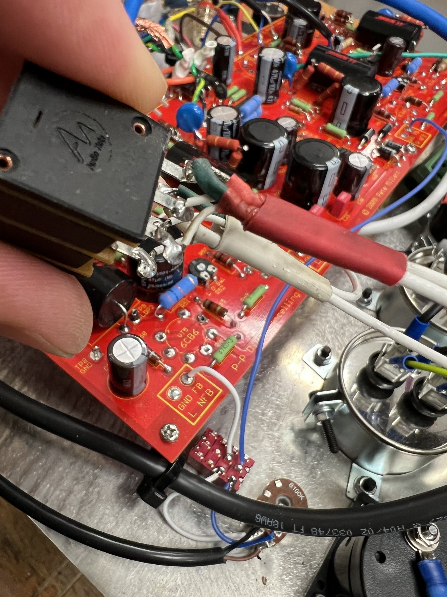

Thanks for the thorough explanation. I tried it again today while the deOxit is on order, and the problem is worse. I did figure out it’s both channels; I’m just closer to the left speaker when adjusting. I don’t think I have any leaking capacitors, as they’re all new, but it’s possible. I did order another set of driver tubes, as I did fry one (or just had a bad one) when initially testing the amp.
Tomorrow I will bypass the pot to test if I have a tube problem, as I can live with my digital source until the problem is resolved if it’s just the pot.

This will provide a ground reference and grid current path, while keeping the screen current off the wiper. It would be best to use a capacitor that is not polarized, preferably flat stacked film or a NP (non-polar) electrolytic. An audiophile radial film capacitor can lead to noise pickup and instability in this position.
Thanks! If the problem persists, I will be likely trying this. I found some deOxit locally, so I tried it on the pot this morning and added R64 back in. I had to use 220k resistors for now, as it’s all I had in a decent quality resistor.This will provide a ground reference and grid current path
There is some noise near the middle of the pot, but much better than it was. Been running the amp for an hour now, and the bad noise it was making hasn’t shown up. Needs more testing to be sure.
That is the correct way to do this. Deriving the grid voltage through a pot, especially via the wiper is asking for trouble. A 2.2uF non polarised cap will give you all the bass you need with R64 at 100K. It also protects against any source device that might have a DC offset which would get amplified by the valve.This will provide a ground reference and grid current path, while keeping the screen current off the wiper. It would be best to use a capacitor that is not polarized, preferably flat stacked film or a NP (non-polar) electrolytic. An audiophile radial film capacitor can lead to noise pickup and instability in this position.
Thanks guys. I have a few more things I need to try as the problem returned after a couple hours of run time with 220k grid leak resistors in place. It may be a cold solder joint, or a bad driver tube as well; I’m starting to suspect the scratchy pot and this noise are two separate issues, although they sound the same.

That could be it. One thing which I find telling is that the problem returned after hours of runtime, because normally leakage through a capacitor reduces with an increase of time in which it is being charged. I would start with re-seating the tubes in their sockets, and if that does not reveal the cause it may take swapping the tubes with new ones, one-by-one. If you do not have extra tubes on hand, you could reflow the solder joints. I reflowed every joint in a television once to fix a progressive problem with the picture cutting out.
If you have an oscillioscope with appropriate rated probes it could find this audible problem rather quickly by making it visible.
