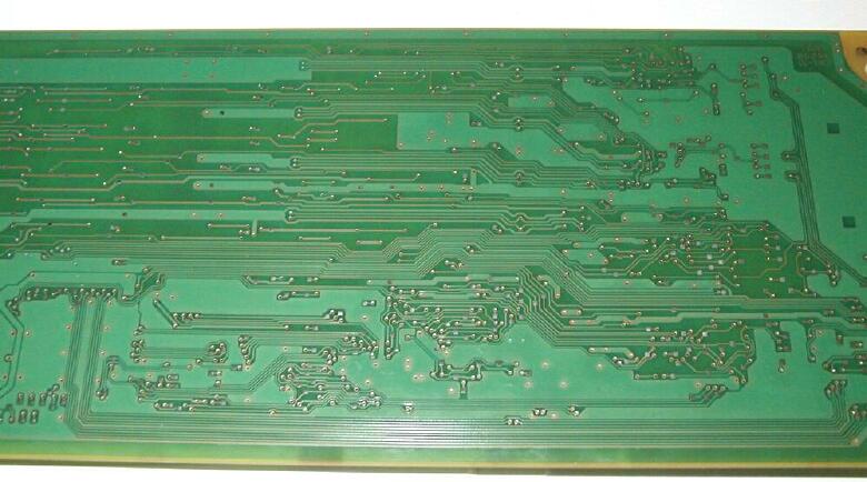

Mixed grounds
One of the hardest grouding projects I worked on in telecom.
Digital, analog, EMI radation reduction, and transient current from lightning strikes of tens of amps that were not allowed to corrupt digital circuits. All this on a two layer board. Over two years in the making and I nearly lost my mind. I did learn some neat things about grounding, EMI, and crosstalk though........
H.H.

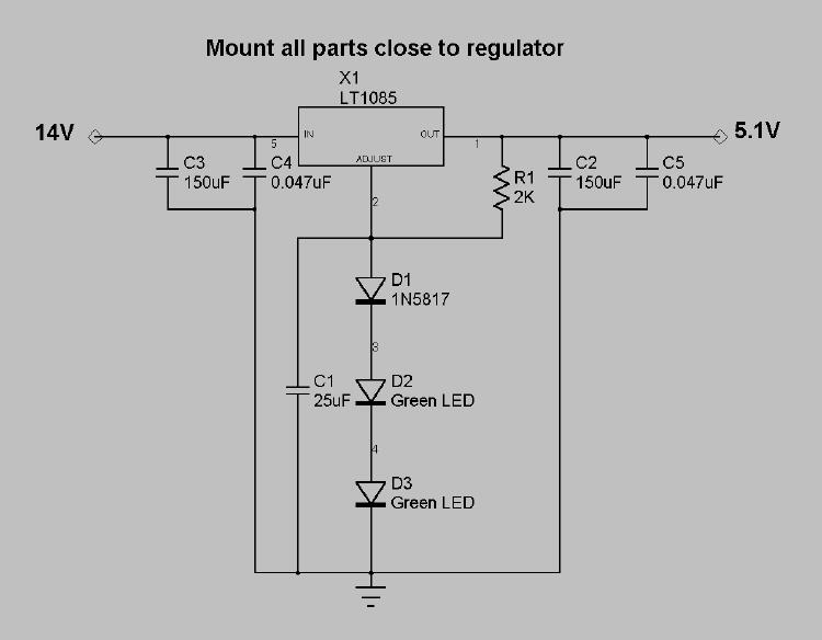

decided on LT1085
You want 5 volts out at what current and input voltage? I may have an hot rod LT1085 circuit that is pretty simple....... As three terminal regulators go it is one of the best. Make sure you get the LT vesersion and not a second source like the LM1085 from National
H.H.

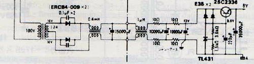

Simple Emittor Follower regulator without Feedback
Peter Daniel said:
Does anybody has an experience with a simple regulator following it? I was tempted to try it as well but eventually decided on LT1085.
Hi Peter,
For digital +5V circuit I am using the similar LT1086.
The simple emittor follower I use in my old Tandberg 10XD open reel recorder for +18V supply.
Tandberg originally used a very noisy 18V zener that I replaced with the capacitor bypassed zener emittor follower circuit.
Also I am using the simple emittor follower circuit; without feedback from the output; in the KWAK-CLOCK [low jitter crystal oscillator for CD-players] just as Jocko suggested and in your picture {TL431, NPN transistor}.:)
I realise that such a circuit has very poor load regulation, if any, but that should not be a very big problem in a clock circuit with a constant current need. :)

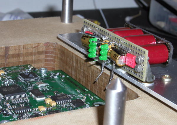

Yes as would the failure of a resistor or zener or even the regulator IC. The LEDS are run at very low current and are actually very rugged, what is your concern? You could put a 5 watt zener selected for about 0.5 volts greater than the output voltage across the output and fuse the inputs before the decoupling cap on the input of the regulator for additional protection if desired. Most logic circuits will take up to 7 volts on the rail without failure.
Actually I'm using two regulators. One is 5V for digital, second is 10V for servos. I had to do some changes to original schematic to achieve required values. For 5V I used 2 LEDs and 1K resistor and for 10V I had to use 4 LEDs and 200ohm resistor. So in second case the LEDs are quite bright, but still OK. When I was soldering them in a vise, I pressed too hard and one failed, after checking the circuit I noticed the higher voltage. So that's where my concern is coming from. If for some reasons one of them fails the whole CD-Pro goes down (pre reg. voltage is like 16V or so). That's why I started to think about using maybe resistors, they more rugged.;) But then my impression is the LEDs probably sound better.
I made my best to keep components close to regulators. They are under Cerafine caps.:bfold:
