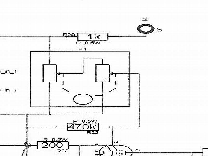

wonder what would happen with 2 LDR's in series per side with middle connection as the output. In at the top, gnd at the bottom.
An LED on each LDR and a voltage adjuster on top "L" & bottom "R" led's to set balance.
Then volume adjust top and bottom LEDs togeather on left or right.
Just a thought.

good ideas here and certainly getting me enthusiastic as an alternative to pots.
Have to have a look at availability and price of the LDR's.
