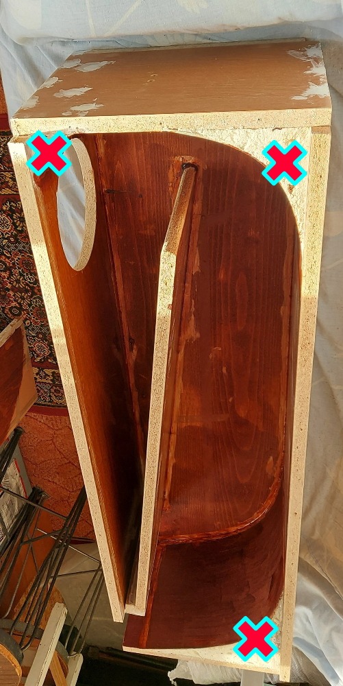

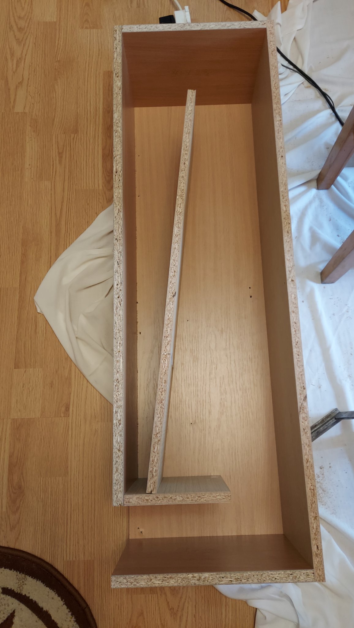

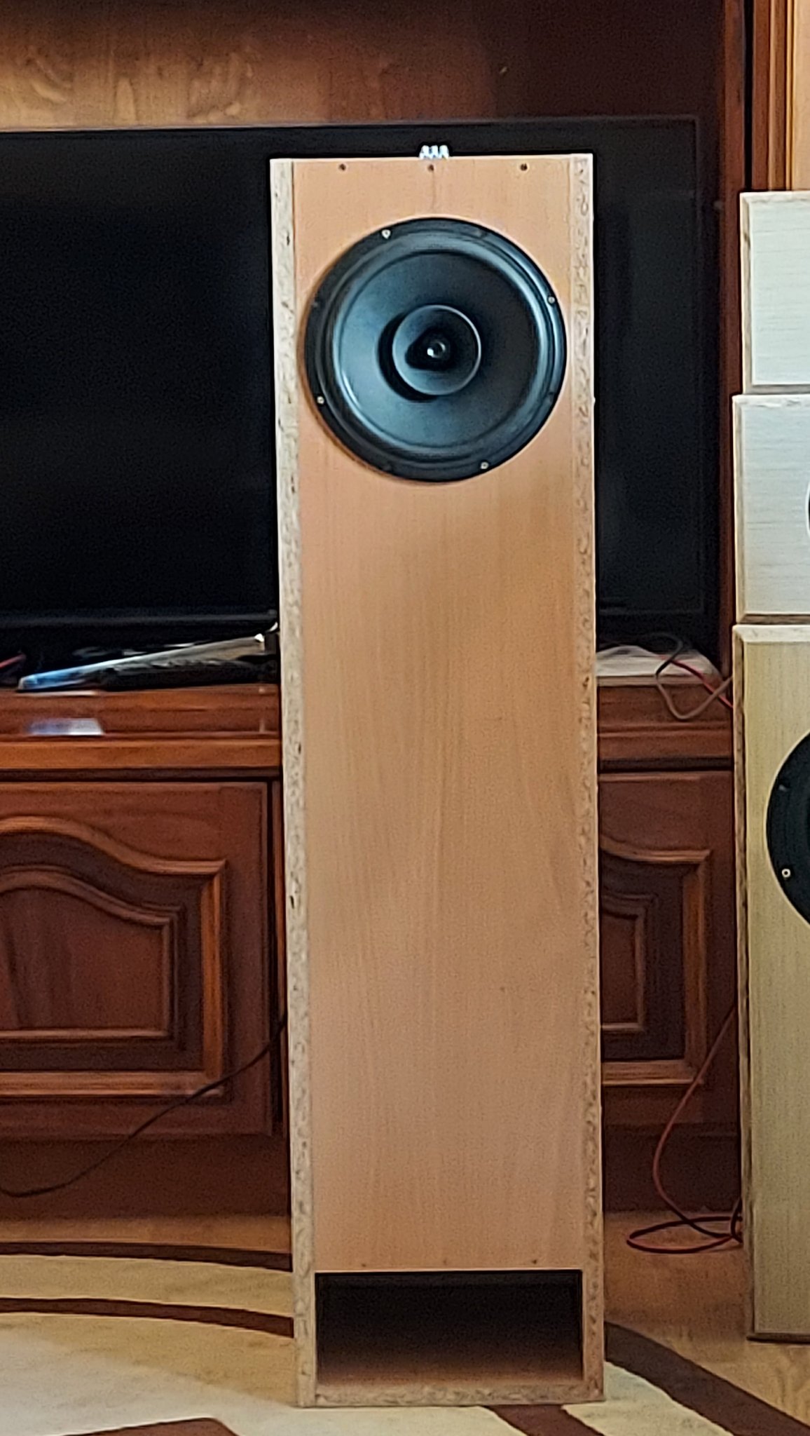

Hello,I'm happy to spend my time doing my own speakers even if the result is unlikely to be very good.
For my age and my skill it must remain simple,verry simple.
I did after a public project with TBW8-1808 two TL enclonsure (VTP) using BG20 .
I like the gain obtained for the bass, the pleasant sound and the simplicity of the construction (without the complication of filters).
Now I ordered SB20FRPC30-8 and I want to repeat this project for another destination.
It can be the same but it can't be that easy ,to use any driver and expect good results.
Here your help can be welcome if it is possible.
That's only if you can tell me simply
" try to change these dimensions" "or tune the speaker by doing this"
It's a bit late to start studying acoustics, it only matters what I can get now .
Thank you.

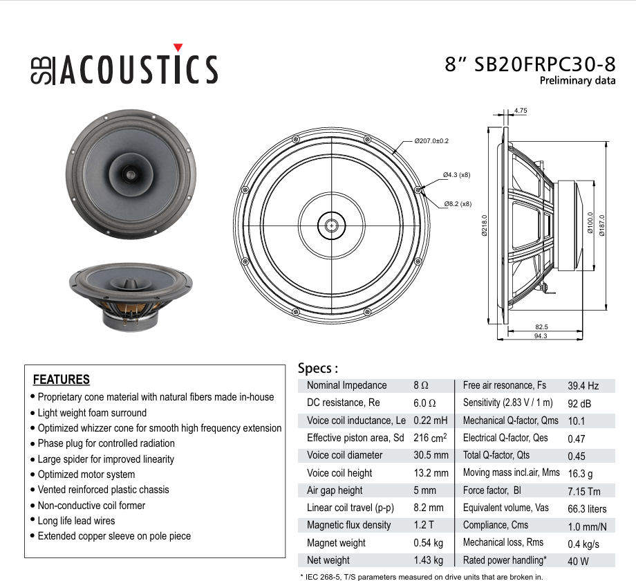

Ok,thank you, it's a good start and makes my work much easier.
What is missing is the size change required when changing the driver.
Except the price... BG20 it does not have such different T/S parameters compared to the original driver project TBW8-1808 .
SB20FRPC30-8 the same.
Ex : Sd 214 vs 220 vs 216 cm^2

Counterproductive actually as the corners act as crude acoustic HF filters.
The effect is very small.
Roundings has the effect of stiffening the cabinet, adding mass (especially if filled with led shot or sand) and making it a wee bit more efficient (even if bass waves can’t see obstacles much smaller than their wavelength in open air, they are affected by them in constrained environments, like a tube).
But overall the time and energy is often much better spend elsewhere.
The square corners most important effect is not as filters but in spreading out the resonating bandwidth of the cavity. So in essence you trade a bit of efficiency for less “one note” resonance.
It can make sense to round the corners if you for example want a smaller design and/or you have a small, low compliance suspension driver.

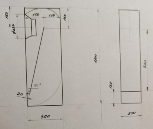

-for a good back loading of the driver, the height of the outlet mouth must be smaller with...
Smaller height of the mouth gives more mass loading, resulting in lower tuning of the cabinet and better filtering of higher frequencies, but also lower efficiency.
-or Sd driver requires increasing the cabinet section by (?2%?)
In modern designs crossection of the pipe is not directly related to Sd.
If this cabinet works well with BG20 any driver with similar specs will be ok.

I've very little time to devote to the forums nowadays and maybe future as well, so best to search by subject matter for mine and others knowledge. ML-TQWT, etc., originated with Martin J. King's work from a purely technical POV, ergo is the 'Gospel' with mine being from experience and the very simple ROT's* that I derived from it, so in comparison mine are acoustically 'fat' whereas MJK's have no excess, so preferred for smallest footprint/folding.
Re height/width ratios, the pioneer's concluded that a 1.0:1.4142 ratio was the limit before it starts to impact airflow performance and 1.0:1.4142:2.0 ratio for a speaker box, so for high aspect ratio cabs the 2.0 gets increased at an acoustic ratio (math on the net and in some audio textbooks, but no time for searching for them).
?? You do what you got to do to fit the driver and maintain the desired cavity net Vb.
?? Dunno, ask the designer.
* I design a textbook BR alignment for the above acoustic ratio box and extend it to suit my desired driver/floor height with the driver at an odd pipe harmonic offset based on the needs of the app. Can't recall ever publishing this except piecemeal, though with try to make a compilation as time permits, though again, MJK's is most technically correct.
I assume that the T/s parameters of the driver are important when designing the TL.
What would be the parameters that require special attention when replacing the original driver so that no dimensional changes are necessary ?
Sorry, I dont have a simple answer.
Modern designs are based on Vas, Fs and Qts. Just like closed and vented boxes.
Even if they are different, they can be in such relation to each other that two drivers needs a box of almost identical size and tuning.
Things are not that critical, 5-10% of tolerance wont make significant difference in performance, and fine tuning is achived by stuffing.
Theres also tolerances in drivers specs, effects of room acoustics and speaker placement etc.
So you really dont have to go for pin-point accuracy.

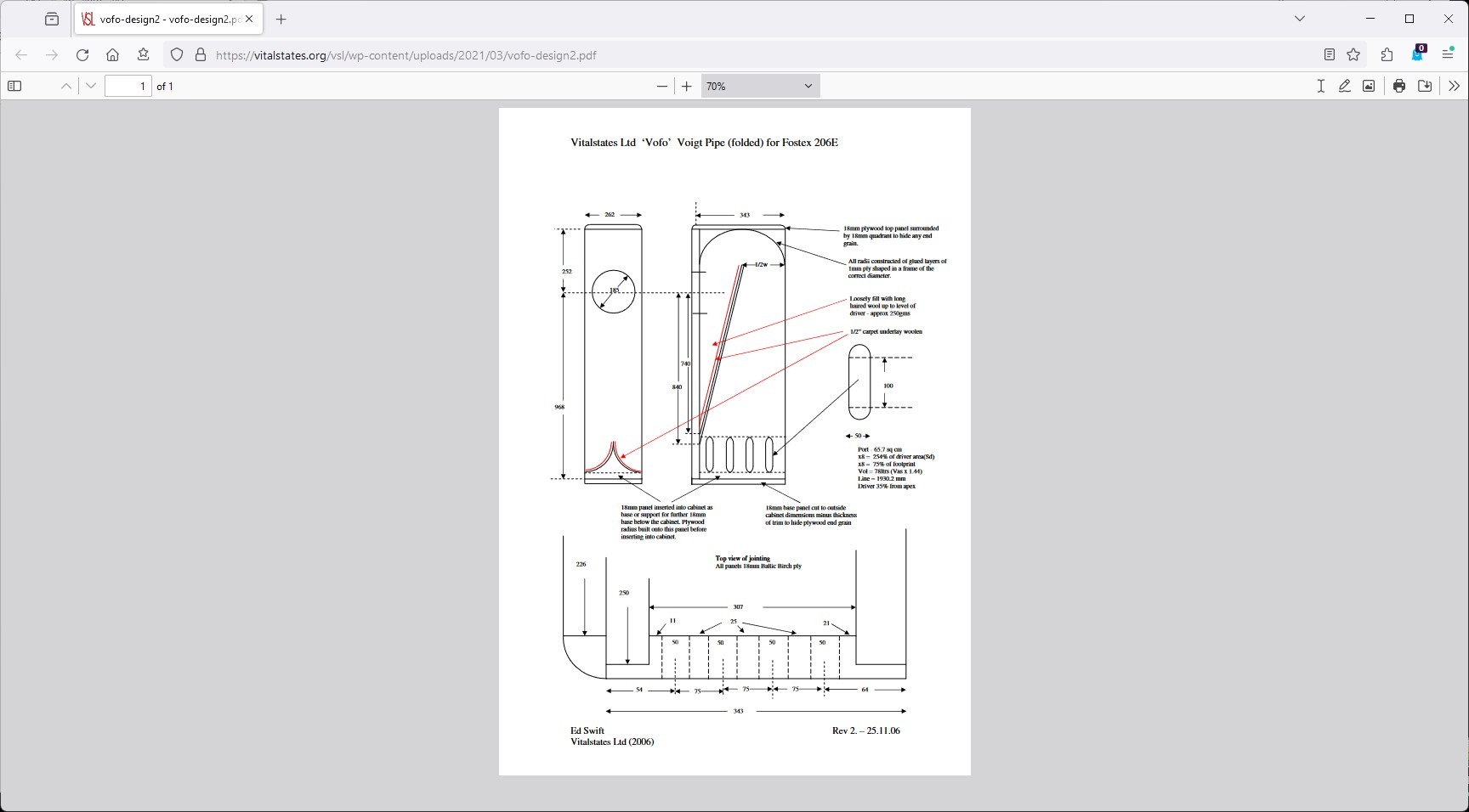

As GM said, work by M.J.King is the most recent. If you want some good guidelines, I recommend you the article "Classic Transmission Line Enclosure Alignments" from 2021.
But the best way to design such cabinet are modeling programs like
Hornresp.
Reactions: 1 user

"5-10% of tolerance wont make significant difference"
Very convenient for me and I will choose this, no other simple choice.
Even if Vas for TBW8-1808 is 88L and for SB20FRPC30-8 it is 66L- the difference is greater than 10% .
I assume that part of those 5-10% percentages can be solved in the tuning stage.
Optimization by arranging the absorbent material and
adjustment for driver protection so as not to exceed Xmax
(here we only have the possibility of adjusting the height of the exhaust mouth IF necessary)
