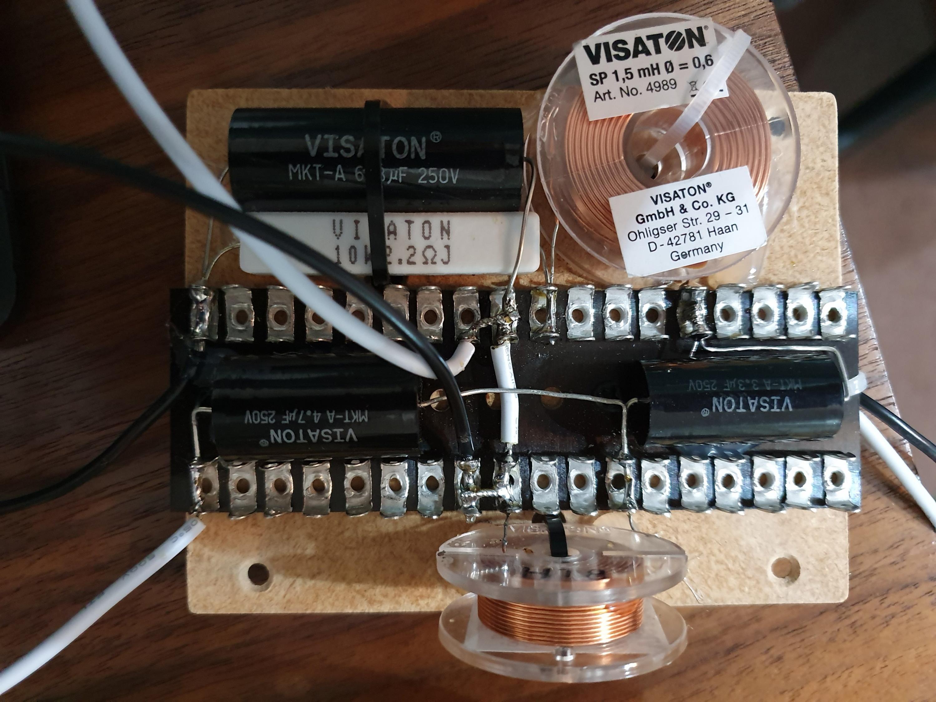

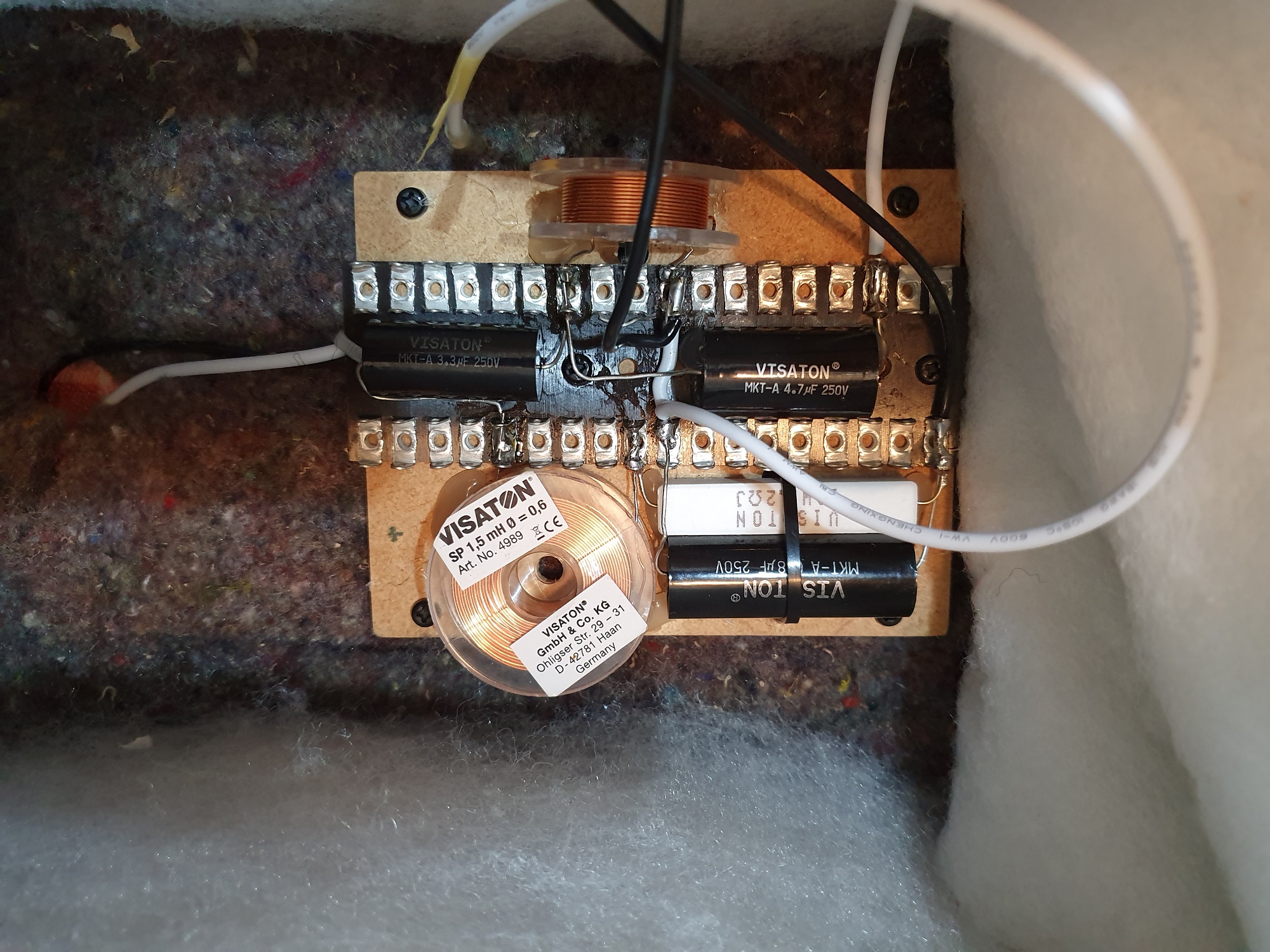

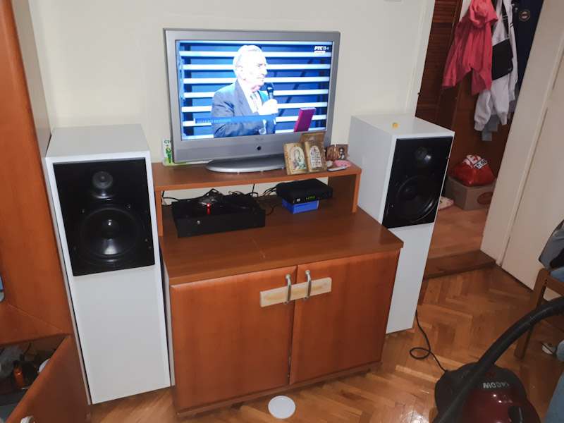

Mission completed.They sound beautiful....at least to me:D Thanks a lot for the help Steve:cheers:

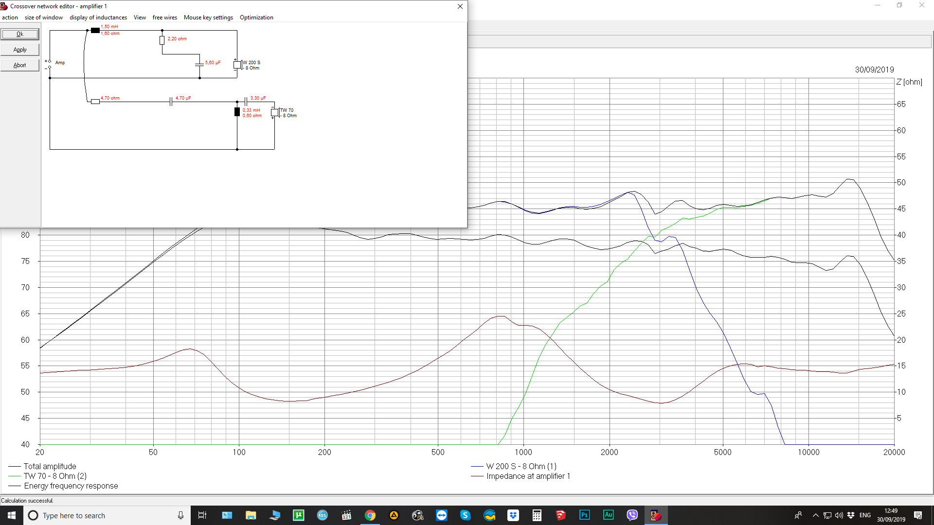

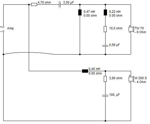

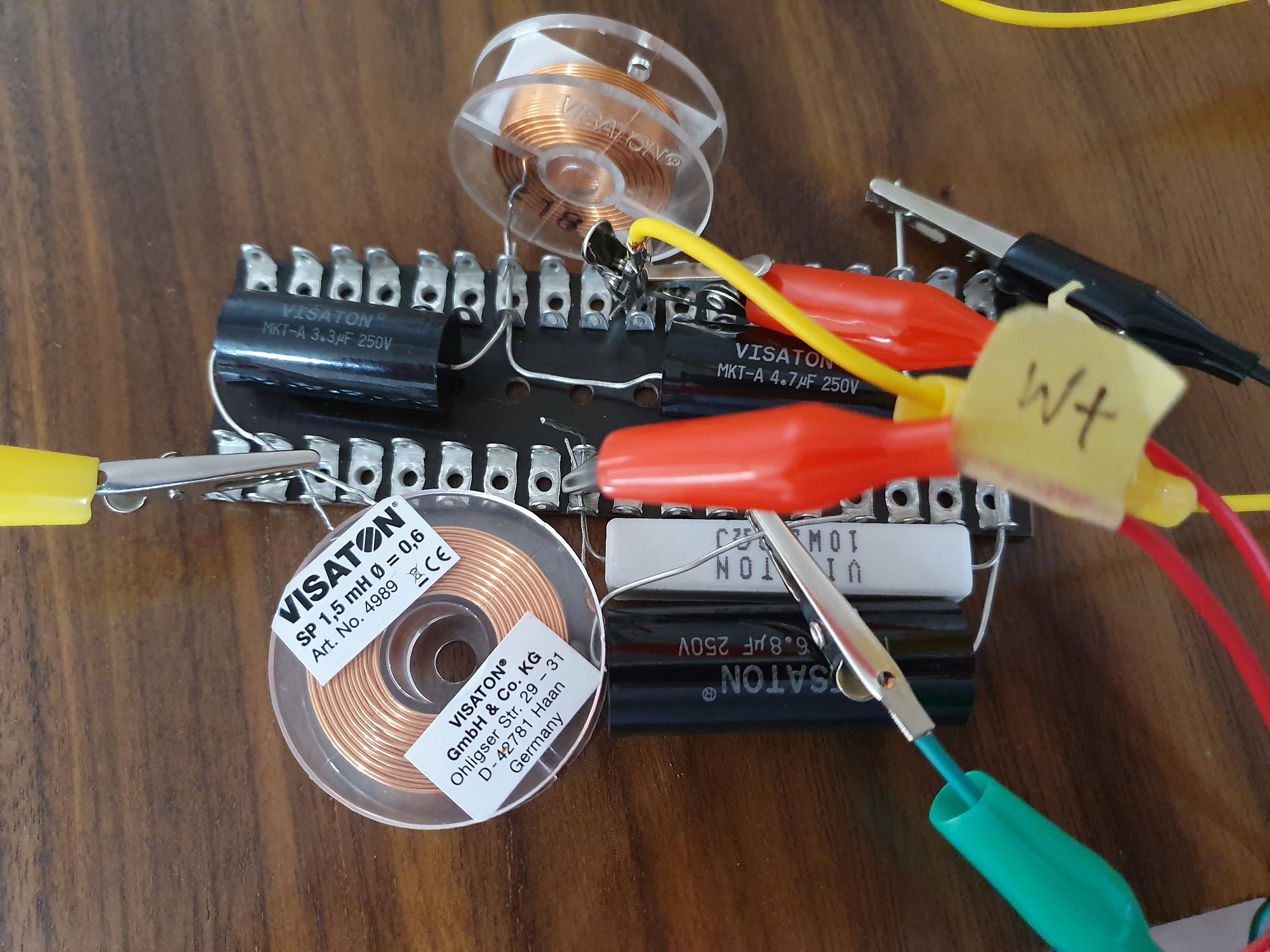

Congratulations, that is a buatifully looking veneered cabinet. I suppose you are fine with it although could be worth a try to modify the 1.5 mH inductor (0.6mm wire=1.9 Rdc) with a 1 mm wire version. According to Visaton, difference in Rdc between the two is 1.3R.
edit: How is the final circuit now?
Yeah, as I said before I'm totally new in this. I didn't realise there is a different thickness wire. I guess less resistance is better in this case? Is it going to be noticeable if I do the change?
I'm going to take a crack at this.

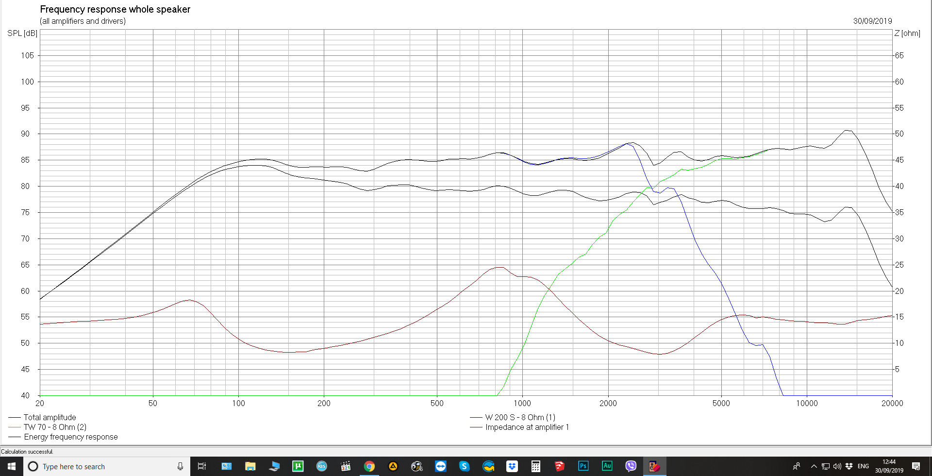

With the 0.6 mm inductor:
Power going to the driver is down 1.6 dB. You won't hear this, but it means that a lot more power is dissipated by the inductor. For an average power of 15 W into the speaker, 4.8 W is dissipated in the inductor.
With the 1 mm inductor:
Power going to the driver is down 0.6 dB. The power dissipated in the inductor is a much smaller percentage of the power going to the speaker. For an average input of 15 W, only 1.9 W is dissipated in the inductor.
Furthermore, you will be able to drive more power into the speaker with the 1 mm inductor (I think by about 22 %).
As far as sensitivity is concerned, sensitivity is 2.2 dB less with the 0.6 mm inductor. Using the theoretical 88 dB for the driver at 1 W, at 2.83 V, the sensitivity is as follows:
0.6 mm: 87.6 dB
1 mm: 89.8 dB
You will need to adjust the tweeter accordingly, but again, with the 1 mm inductor, you will use a smaller value resistor on the tweeter and therefore dissipate less power in that.
I hope I'm accurate...

I think I should just add that I don't think it matters at all. 15 W average power is something massive, probably in the region of 200 W peak power. According to this thread it looks like most people are happy with an average of only a few watts.
It should be an obvious improvement for the better. Perhaps you can source magnet wire somewhere cheaply and build the inductors yourself. Would be a great exercise though.

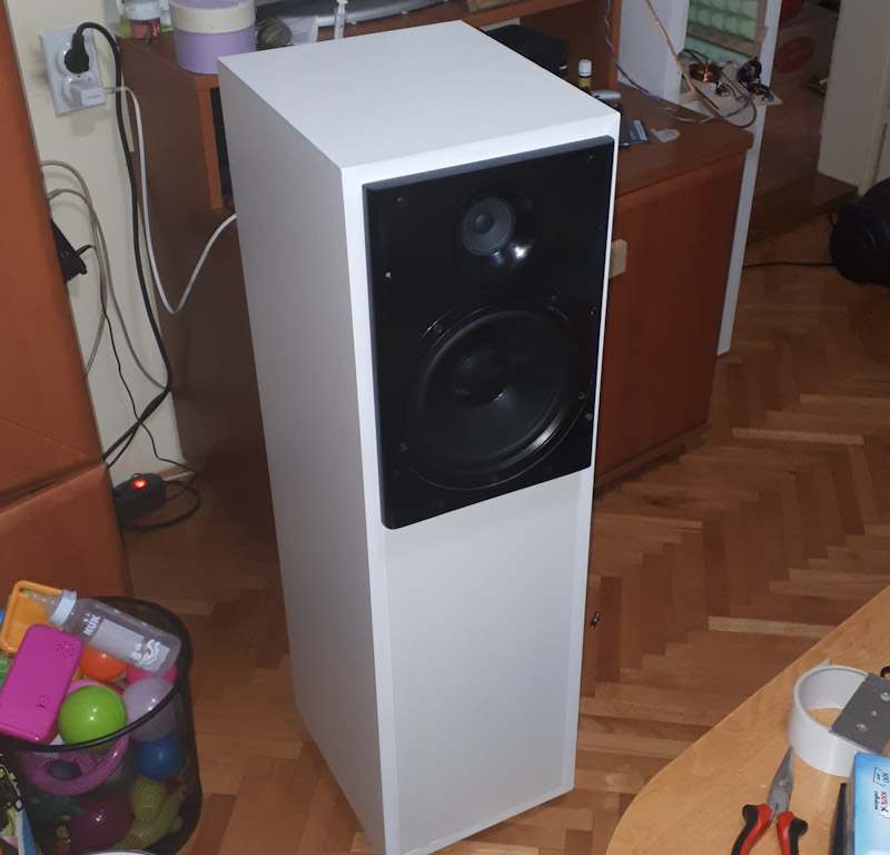

Thanks a lot for the info guys! To be honest I didn't expect much when I start building them,but they they turn out good at least the cabinets.And with some corrections they sound good as well.Probably I will change the inductors and see if I can hear the difference :)

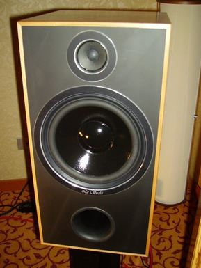

When I first saw the WLM La Scala, I just wondered how those guys were charging 3,000 Euros for something with a ten buck tweeter! :D
