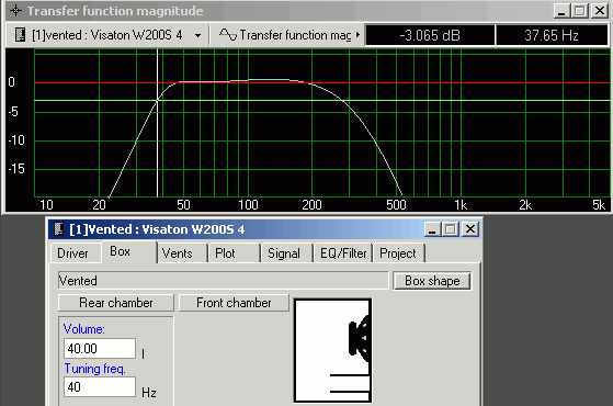

I want a pair of floor standing speakers for my bedroom (~15 m^2) and no subwoofer as my neighbours are quite sensitive. I prefer quality over quantity (90db is more than plenty). I'm also on a tight budget (about 150$ per speaker) so this is what I've planned:
Bass Visaton W200S (winisd simulation attached)
Mids a pair of Peerless SDS134 (two because I like rock/metal and such music requires good midrange power handling)
Highs any tweeter below 25$ (Visaton DT94 and SC10 are candidates)
Crossovers points 350hz and 3500hz (or 500hz and 5000hz), 4th order LR. Low-mid amps are LM3886 per channel/band, not sure about highs yet. Maybe LM3875 would do. Or some simple Class A solid state amp.
So, what do you guys think?

Btw, could someone please tell me what's wrong with the setup I suggested in the first post?
