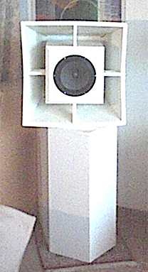

Hello,
it is not simple as you wrote,
i have good experience with different
Visaton driver,
the B200 was one of the best FR in
my Sat-Horns specially for classic
listener because the B200 has no double cone,
look a few constructions with measurements.

Hello,
"The bass of the B200 is muddy, especially in comparison to other FR drivers. The mids are a rough ride to handle - they are lacking there - a real problem. The distortion diagrams are much worse than Alpair or Tangband and you need a gigantic box for them. I do not see one reason to use them."
may be you understand the driver not, the only way to get the driver sing,
don´t use it in bass, lift between 100-400 Hz with 12 dB roll off, to use
the 96 dB over ~1kHz, in my sat-horn you will get it,
or in my double horns down to 30 Hz, it works because the B200 horn is
only a real low mid horn.
