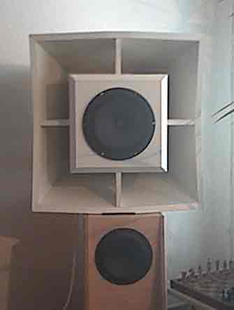

Hello,
are you know my experience with the B200,
sat- horns over 100 Hz, the Trumpet (measurements)
the horn (measurement by Visaton), Schalmei,
double bass horn RDH20 down ~30 Hz,
between 95-98 dB 1W 1m
