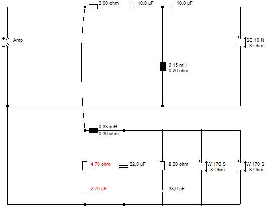

Either way, if you want better simulated frequency response, a BSC can be added in the form of a 0.33mH and 4.7ohm in parallel, and that little thing in series before the RC impedance correction. Also, the 2ohm tweeter resistor can change to 4ohm, and the 22uF can become 10uF.
With less effort, the 22uF can simply become a 10uF, but the only issue which may arise is cone break-up due to raised response >4kHz.
I still like the raised response in the higher mids. It works well in-room. I'll have to measure anyway.
ETA: I wanted to mention a sealed box here would be Q of 0.88.

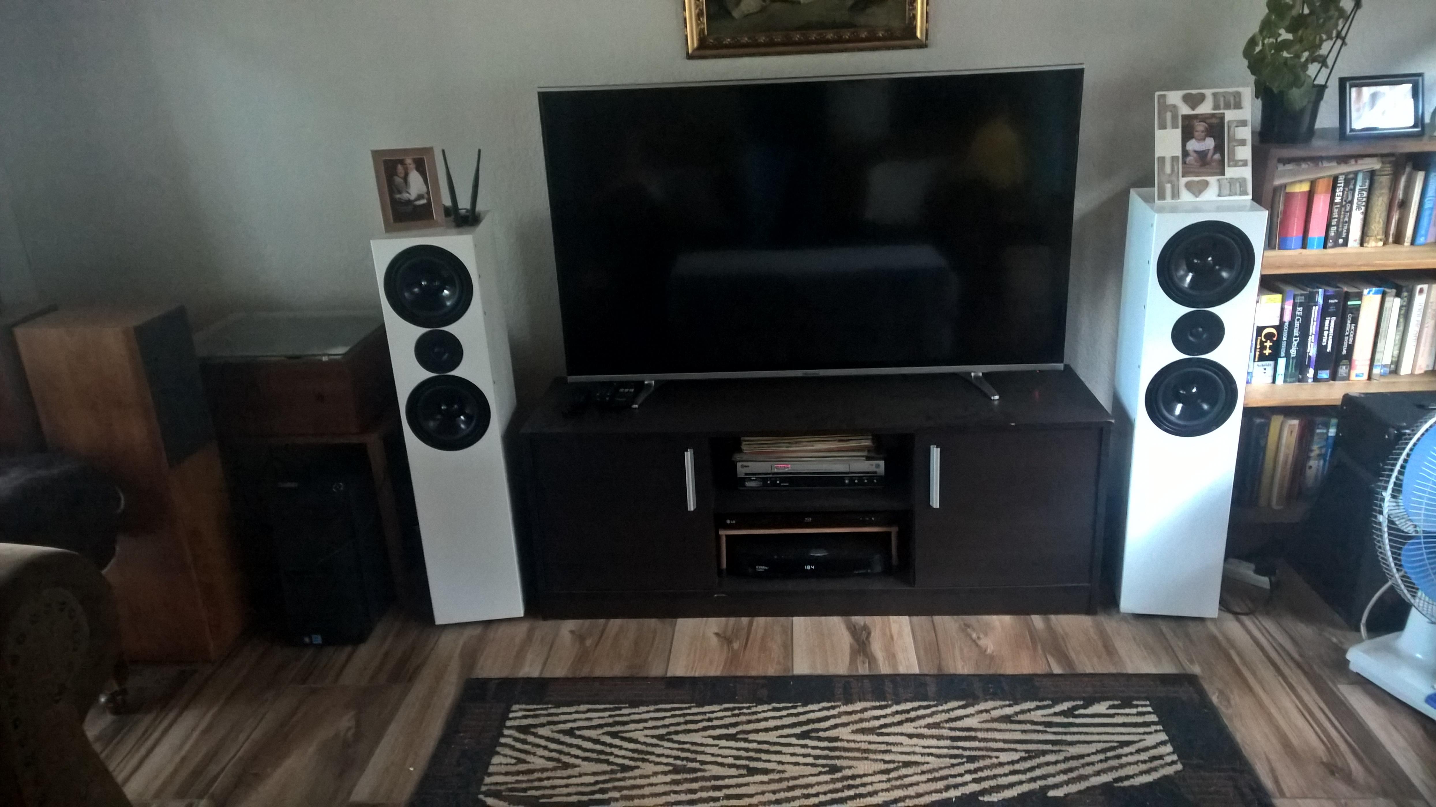

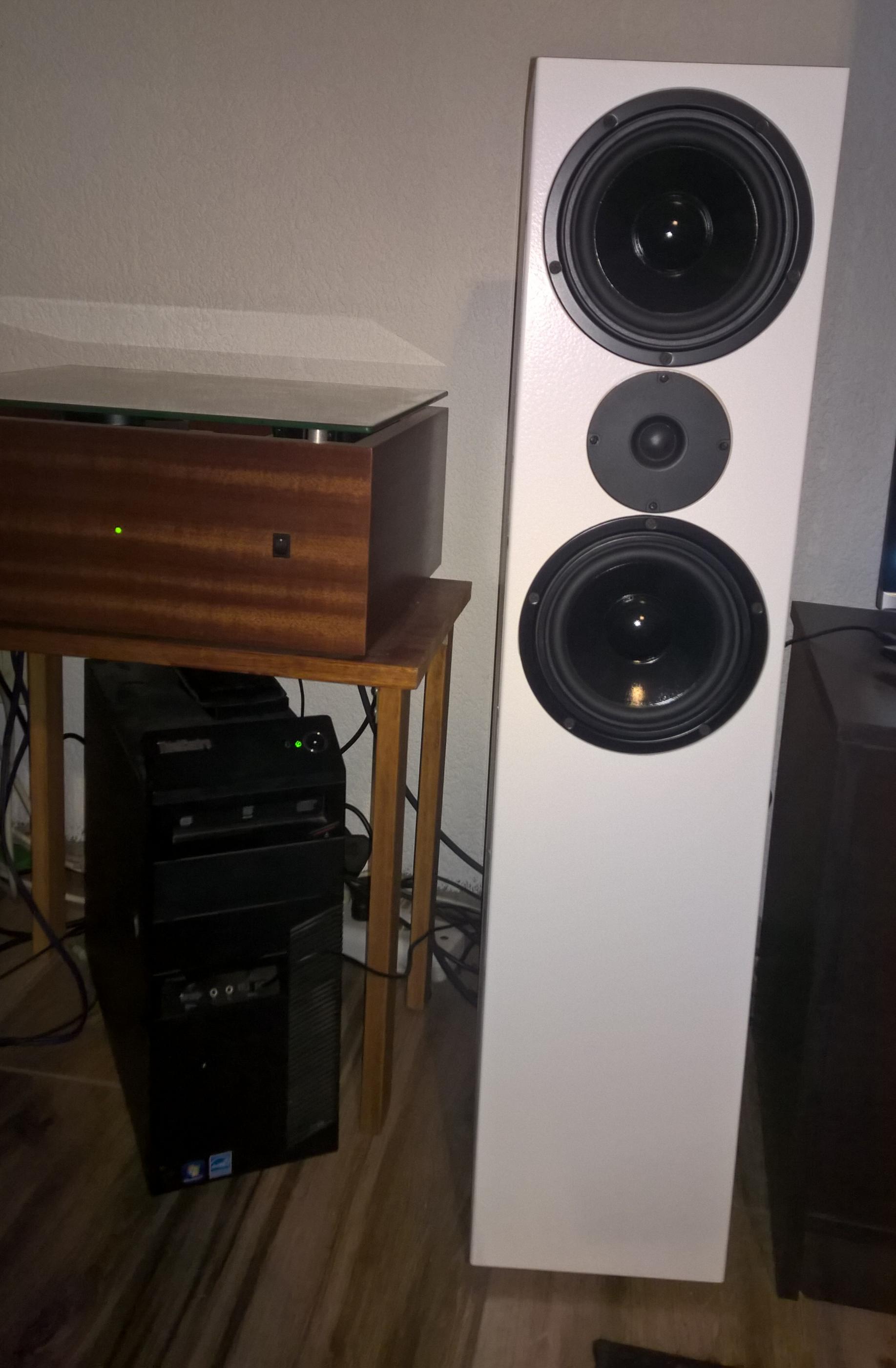

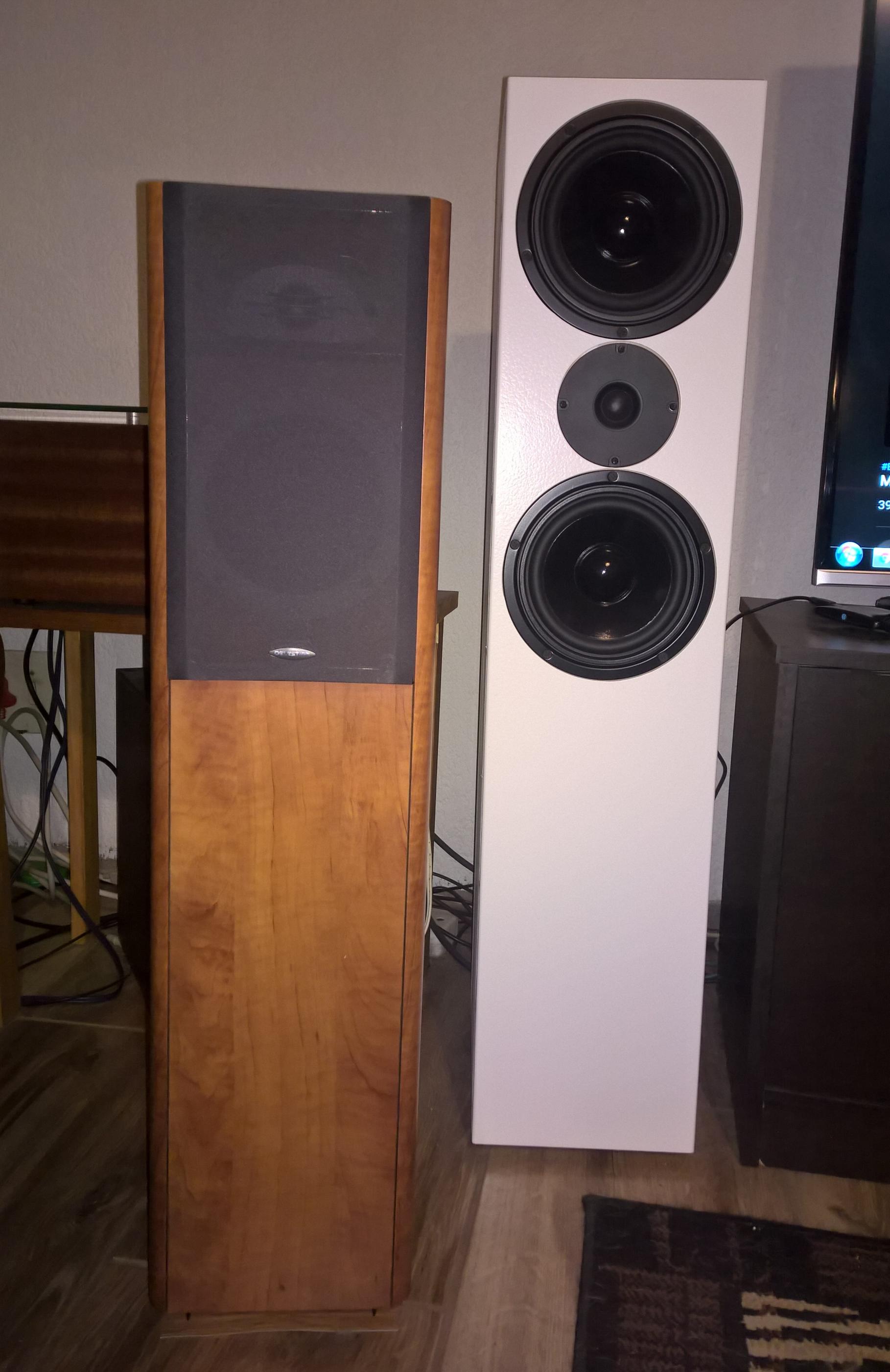

I can't believe I never posted more. I finished and painted the speakers ages ago.
Tonight I auditioned monitor audio bronze 6, silver ss300 and B&W 603 side by side. I came home to compare my speakers, and truly, I like mine the most. The silver 300 blew me away out if the three at the shop.
To finish my speakers, I doubled the baffle thickness, primed them, and sprayed them gloss white.
I want to add the port again, but I'm building a little sound room, so I'll wait until then in case sealed will be better in the small space. I'm going to rebuild the cabinets one day with thicker panels, possibly plywood, but I'll see.
Enjoy attached pics.
