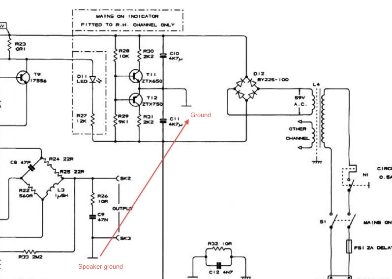

Quad 606 floating ground
...I found the schematic for the Quad 606 (I have no idea about the details of that amp...) floating ground setup. Can anyone give me a bit of insight as to the relative merits of the approach we've been discussing and this circuit?

Safety Earth & Virtual Ground
The chassis, if conductive, MUST be connected to Safety Earth (Protective Earth).
If the speaker ground in Quad's 606 schematic has an exposed conductive part then Speaker Ground MUST also be connected to chassis.
Similarly, if the input socket has an exposed conductive part, it too MUST be connected to Chassis.
This is why I asked in post13, "do you need to? "

if the audio terminals & connectors are not composed of exposed conductive parts then I believe the regulations allow the Virtual Ground to be isolated from the Chassis.
However,
what happens at the other end of the cables that are connected to this amplifier?
For the Safety of other users, visitors, children, I would always connect these insulated parts to the Chassis by way of a Disconnecting Network.
The advantage of the Virtual Ground is that all 3 poles of the dual polarity supply are isolated from the chassis. This leaves open the designer's choice of which to connect to Chassis, It does not have to be the Virtual Ground that gets the connection. You may obtain better performance by using one of the +/- voltage poles to the chassis.
what do you think of the quad schematic? I'm curious to get feedback on efficacy as it'll be cheaper to do, vs the use of a LM3886?
It's an active circuit as Andrew said, but a really limp-wristed one, with performance even worse than the simple passive circuit shown earlier.
The goal of any of these virtual ground circuits is to keep the DC voltage on the virtual ground as close as possible to half way between the positive and negative supply voltages, even if there is some DC offset current.
Two weaknesses of the Quad circuit are:
A) It allows the voltage to drift about +-0.7V from where it should be before the active devices (the transistors) even turn on.
B) The transistors are current-limited to about 25mA. If the DC offset current is larger than that, the voltage error will quickly get large.
Below is a comparison of roughly how much voltage error to expect on the virtual ground for each of the three circuits, for different amounts of DC current:
Active circuit (post 8):
1mA DC => 1mV error
10mA DC => 10mV error
20mA DC => 20mV error
40mA DC => 40mV error
Passive circuit (post 3):
1mA DC => 50mV error
10mA DC => 500mV error
20mA DC => 1V error
40mA DC => 2V error
Quad 606:
1mA DC => 700mV error
10mA DC => 1V error
20mA DC => 1.3V error
40mA DC => 23V error !!!
The Quad circuit is still quite rational, though.
If the DC offset current is less than about 25mA (which seems to be their assumption), then the voltage on the virtual ground will be within about 1.5V of where it should be.
Points in favor of the Quad circuit are that it's fairly simple and inexpensive, and it should run cool without wasting much power.
If required, it could always be improved at the expense of some added complexity.
