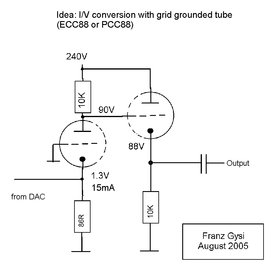

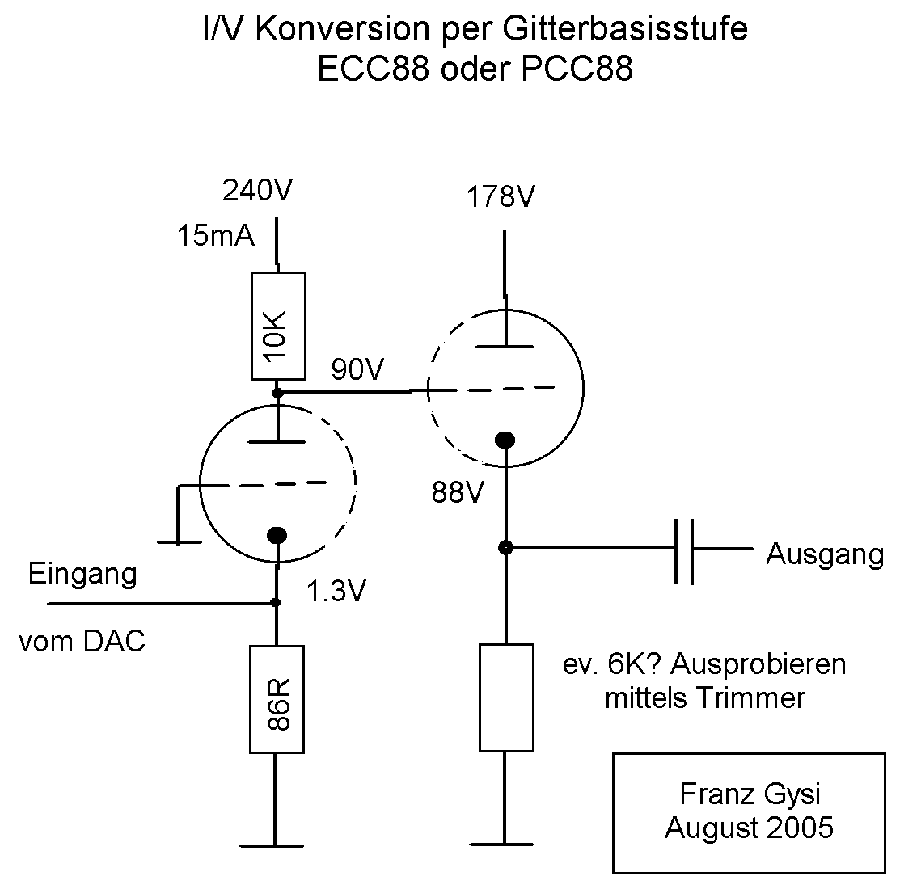

If the DAC is a true current output, 1,3V couldn't harm.
Coming back to the simple idea, just a 6C45 with cathode resistor, and therefore 1.3 to 2V at the output of the TDA1541A, I consulted again the datasheet of the DAC.
Concerning the output (4mA), they add the following note:
"To ensure no performance losses, permitted output voltage compliance is +-25mV maximum."
Does this refer to the resulting output swing or possibly to bias like above?
Franz
Franz
I suspect the swing. This would require an input impedance of 12 ohm or lower.
