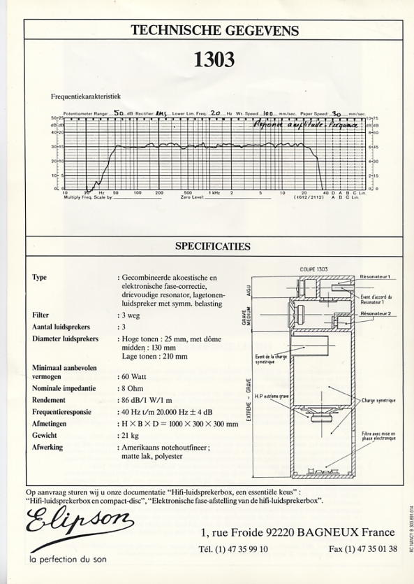

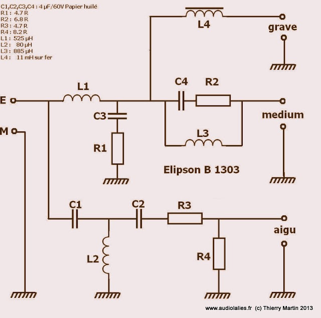

Yes it has a large coil which nicely cuts the bass down low. Why is that the dream of DIYer's? Because they're expensive coils?
No, I think, it's because it's what they call a 2-Way (Elipson 1302 being a real bookshelf 2-Way). Anyway you missed the point, the dream is having a speaker crossover-less or with a few components, being a 1. order (with only 1 crossover component) already difficult to find. But I digress... Now they call it a 2.5-Way. In this case is different. The woofer, that is the same for mid and bass duties (2 drivers connected in parallel each with 15 Ohms?? :scratch1:), said woofer is in a bandpass enclosure working as an acoustic crossover with LF bandpass and midbass rolloff. If this makes sense to you. I would like to see the speakers and crossovers. Can you post yours? (or is it the same posted above?)
The speakers: It's like early versions started with 2x13cm drivers, then later 17cm + 13cm Mid, and later a 21cm Woofer + 13cm Mid.
  • 1303D: with 6 drivers 2xWoofers, 2xMidbass, 1 Mid dome and Tweeter
  • B 1303: with 3 drivers, 2x17cm + Tweeter.
  • 1303X: with 3 drivers, 1x17cm Woofer + 1x13cm Mid cone + Tweeter.
The tweeter used (with reference Siare, for previous 1303) was later replaced by a HD 12X9B25 Audax (??) this one being for sale now.
