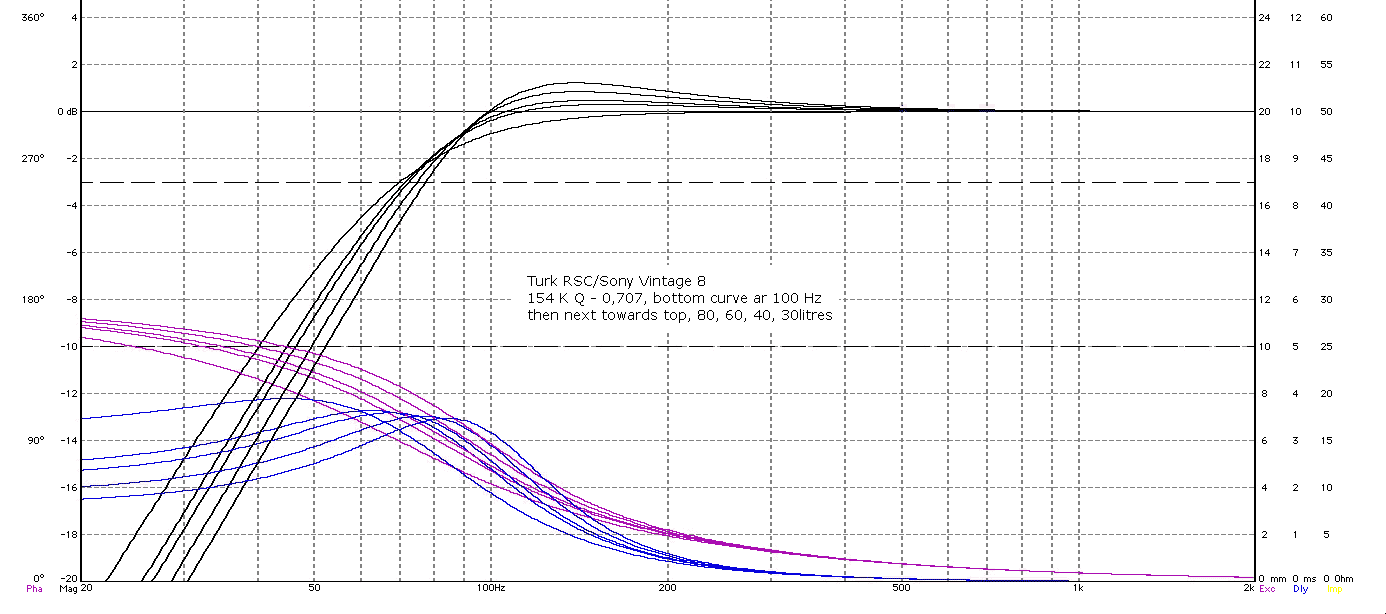

Sealed Sims based on the measured numbers. Note that this is without damping. Dapingwillknock the Q down somewhat (heavy damping can make the box appear to be as much as 20-30% larger)
There is no wrong answer, just that the larger the box you can live with, the flatter the bass response. An infinite size box would take the Q down to the measures 0.7 (unperceptively different from the bottom curve).
Note that a smaller box is easier to build such that box resonance issues are moot.

40 litres = 40,000 cm^3.
As an example, it is simple to create a set of dimensions for a golden ratio shaped box.
Take the cube root of 40k = 34.1 cm, given it is sealed and endvolume is uncritical choose 34 cm. Multiply by Golden ratio, = 1.618 to get 55 cm, divide by 1.618 to get 21 cm.
So a box with internal dimensions of 34x55x21 cm would do the job. Unlike a reflec box you don't even need to worry about space taken up by drivers or braces.

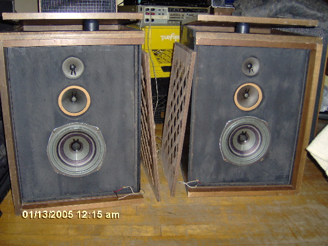

well not sure if this is significant to identifying the driver source but the frame is similar (almost identical) to a marsland 6 inch so it could well be old Mcbride spec. made stuff.
wish greyhorse would reply; sure would like to communicate with his father for historical research.
still knee deep in the Clairtone story...

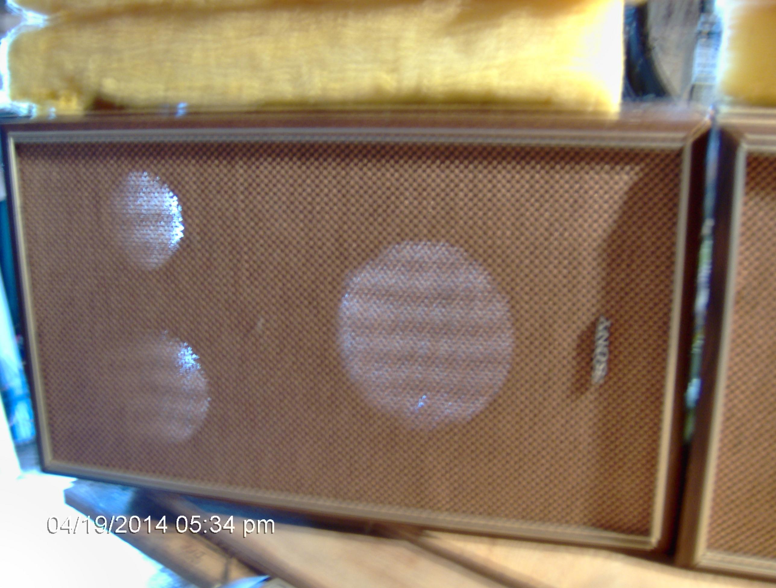

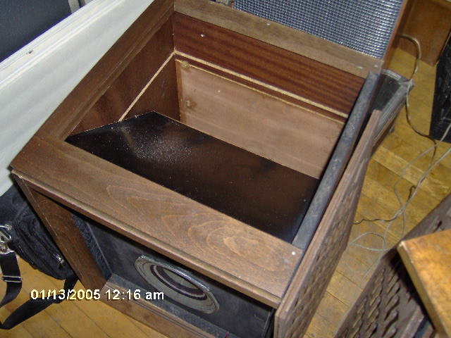

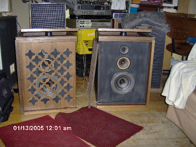

so this project morphed into the combination of needing a new home for these "Sony" drivers and getting rid of an old console!
i cut the ends off the console giving me a much larger enclosure than i wanted but the flip up access doors allowed for opening and closing the mouth of a backloaded horn of sorts.
after spending time on the synergy threads i think that what i originally thought was a mistake in manufacturing was intentional. the woofer cutout was smaller than the driver and acting as a low pass filter making voicing the mid and tweeter via low order x-over much easier/better.
- vintage Sony speakers made under liscense in canada?
