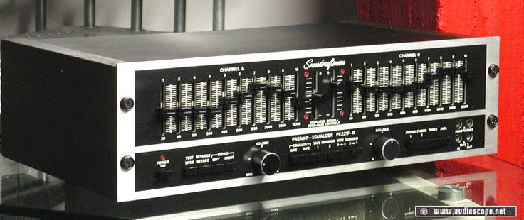

Soundcraftsmen EQ I haven't seen one of them in years. I spent a lot of time with them in my younger years. A band I ran sound for had one for the stage monitors.

I was referring to the EQ and analizar, i do not remember the model, I borrow a description of how it worked, calibrating the sound of the room by means of a microphone.

It helps if you know how to use an EQ though! :D
Soundcraftsmen made that process a lot easier, with a "test disc" release. I can't remember if it's a double LP or just a gatefold, but on the inside cover are detailed instructions for how to use the recordings to properly adjust the EQ, as well as some other aspects of system set-up. You just follow the instructions and use the recorded tracks, setting one band at a time until each one (all of them) has been set. The process isn't difficult to get right, with that disc. You can find it in secondhand record shops sometimes, or listed on the big auction site; it isn't all that rare.
It's amazing how much better a lot of systems become when properly "dialed in" that way. Most people just play with settings until it "sounds good", and often they are pretty far off from what is optimal.
Soundcraftsmen also made a slightly more complicated "EQ/Analyzer" that had built-in tone generators and such. You would plug the supplied microphone into the jack on the front, and put the mic in the listening position. Then you'd generate the tones through the system, and adjust each channel; the visual indicators gave you a more accurate setting than guesswork ever could. I have this unit, too, and think it's great, except that the microphone I use isn't the original, so I cannot be sure that the settings are accurate. Double-checked against the test record, though, it seems pretty good.

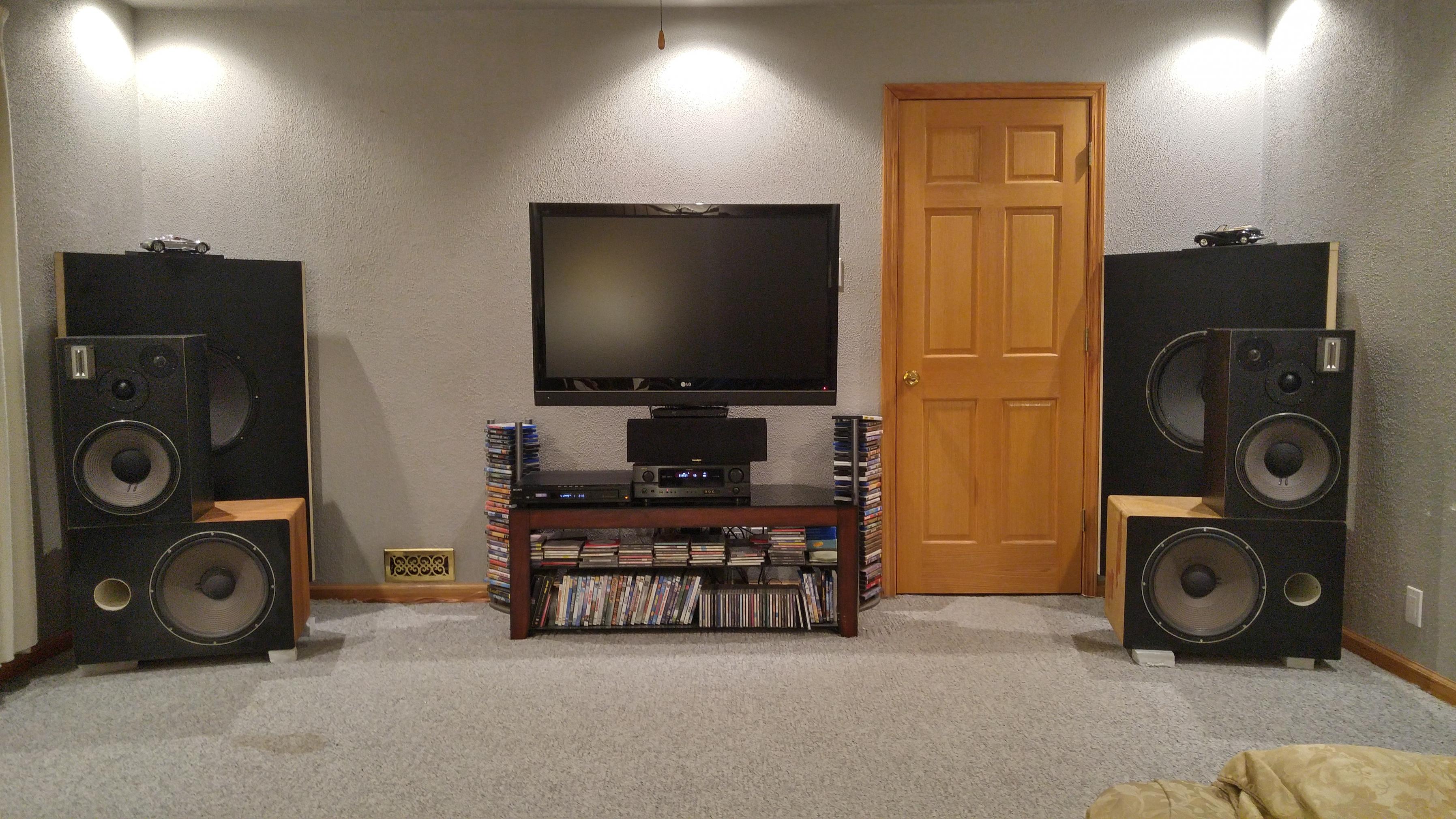

It was a JBL 2245h qts .27 after adding weight to the cone fs 12.5. Tuning ended up at 17 with 6db boost at 17 2 pole hp filter. My son has that sub now and lives next door, so I still hear and feel it playing. I am still looking for another JBL with those specs, I just got lucky on that one. Here is my current system still need to make grills.
I see excellent specifications in that speaker ...

I have bought several 2245h drivers in the 30 plus years since I got that one and none have come close. Unfortunately JBL does not make that driver any more, so I buy blown up drivers off eBay and recone them. I found that the 2245h and the 2240h use the same basket. The sad part is I have bought so many I could build a duplicate of my front system for my rear.
I have looked had for a replacement to that driver. It seems most companies want to build high Q drivers (.4 to 1) and use a light cone. In my opinion the light cones just don't have the drive behind them for low frequency reproduction and the light cones have a tendency to deform when driven hard. But I will keep looking.
Brian, that is a nice driver and would like to try one in a EV Patrician folded horn. Even thought the specs are good and has the ability to make a great sounding sub. It falls more into the horn or TL cabinet design. Both designs I wish I had time to play with.
I look for drivers with the Q down in the .25 to .27 range with fs below 20hz. The other part of the old JBL 2245h is the micro gap on the voice coil. I guess that is the reason I keep going back. I have went as far as talking to local magnet companies to see if I could get the magnet structure re-charged. Sadly none had the ability or the want to do it.
This is one of the reasons I like coming on here, that is a driver I hadn't seen. I now have in the back of my mind for a folded horn with a flare rate of 15 to 20 hertz. I'm sure my wife will love that, she already thinks I've lost my mind with the system I have.
