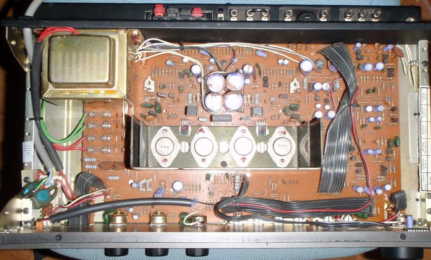

SERVICE NAD 3150
i dont like nad amps of that time and that series
Personally i like amps that are absolute and truth ....obviously machines like that include the perfect playing of nice productions but also include the danger of playing a bad production that actually will sound even worst as a final result.
It seems to me that this time NAD's tend to round the edges or leave you with impression that the sound you listen might be sweet but is somehow processed by something ...is not natural ...
It seems to me that sound is like someone introduced one EQ to the system and then someone else introduced another EQ to cancel the tonal diference from the previous EQ .
Chaotic construction a zillion voltages inside plenty of local stabilization marginal trafos and huge output transistors..
---All electrolytic needed to be replaced
---Plenty of soldering to be done
---some rearrangement of capacitors
--- sealed trimmers
--- tune it ...scope it and let go ...
i am not thrilled....
gut fotos and schematic available
