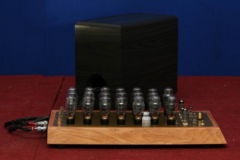

Hi, OTL using , 6J6 for differential input with CCS at common cathod, then 6DJ8 + EL84 to drive 6H13 as ciclotron schema.

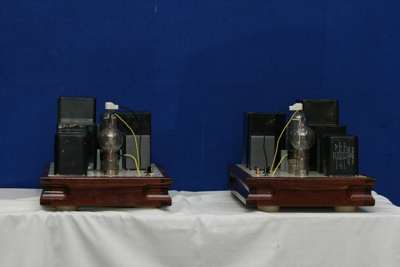

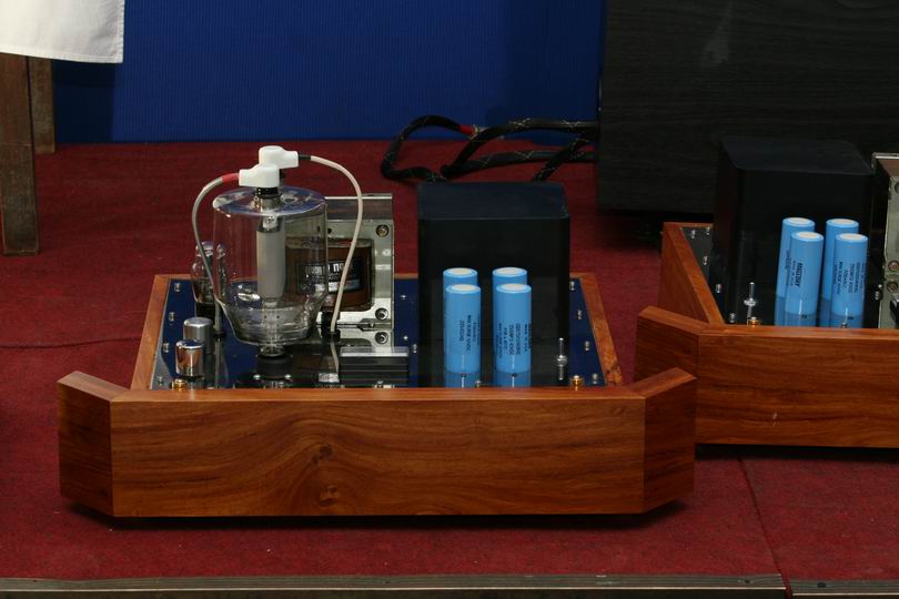

viagraless said:813 mono block
I like this 813 mono block Ampli because I'd like to do it by FU13 tube. Could you please give me the schematics of this?
Thank you very much
Best regards,
thomas-Ngu
Hi, Mr. Viagraloss,
I think that have something wrong here. There are 805 mono bloc amplifier from Mr. Tuan Anh with 75TH tube driver, not 813 tube.
