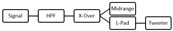

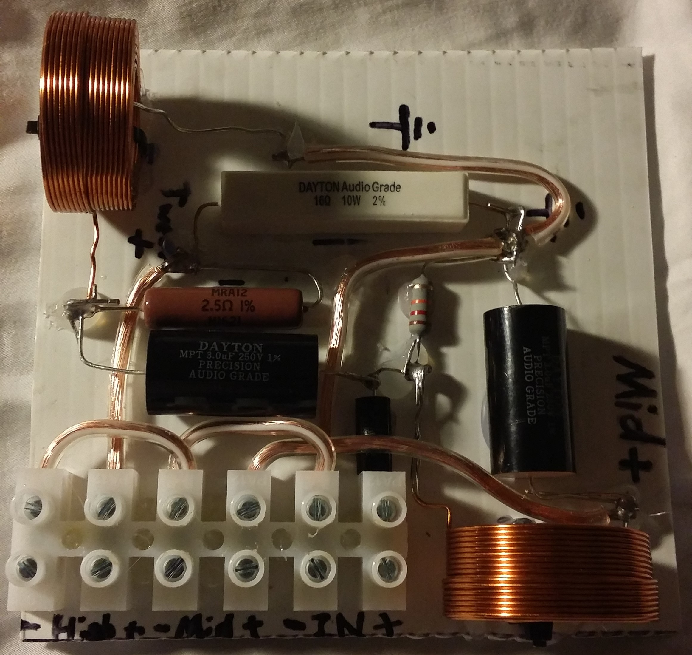

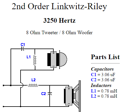

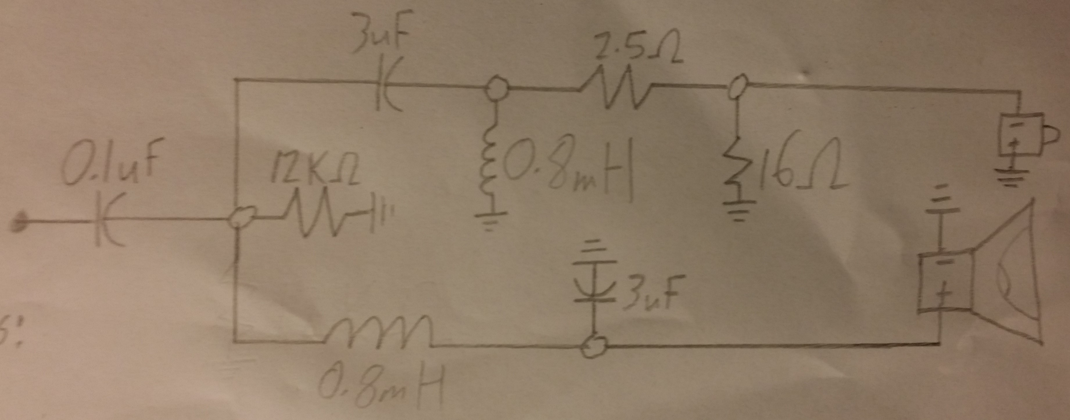

The circuit I built has 3 components implemented (by order): an C-R high pass filter (1st order butterworth, 130Hz), a two-way crossover (2nd order linkwitz-riley at 3250Hz) and an L-pad (3.25dB) for the tweeter. See attached pictures of individual circuits and combined circuit I built (tweeter polarity is reversed intentionally).

Try bypassing the 100nF capacitor. It appears you are trying to high pass this system above 100Hz to use another woofer for bass? The problem is that your filter there is based on an impedance around 12k and it won't work as expected. The correct value to use will be closer to 12 ohms but will be based on a compromise. At the least you could remove the resistor as well, and replace the capacitor with something closer to 100uF.
The reason for the 12k resistor is to give the filter a fixed load to work into. As it happens, the speaker is overtaking this resistor in significance and the 100nF capacitor working into 8 ohms puts the high pass frequency well above the audio band, like a couple of hundred kHz.
See how it goes without a resistor (and with a better value of capacitor). If the irregular impedance of the speaker causes a response peak, there are a few ways to attend to it.

san1c99,
It's clear from your first post that you don't understand electronics math & this makes all your assumptions ( exercised within the first pic ), give wildly incorrect answers ( for your intended outcomes ).
( Even if those 2 drivers where 8 ohm actual resistors / which is just not the case ), your circuit impedance becomes just slightly less than 8 ohms ( when a 12K resistor is added in parallel to the network ).
As Allen has pointed out, you'll need a very large value capacitor HiPass ( for the 8 ohm load ) to give an effective roll-off below 130 hz.

Ok so I believe I now understand where I went wrong.

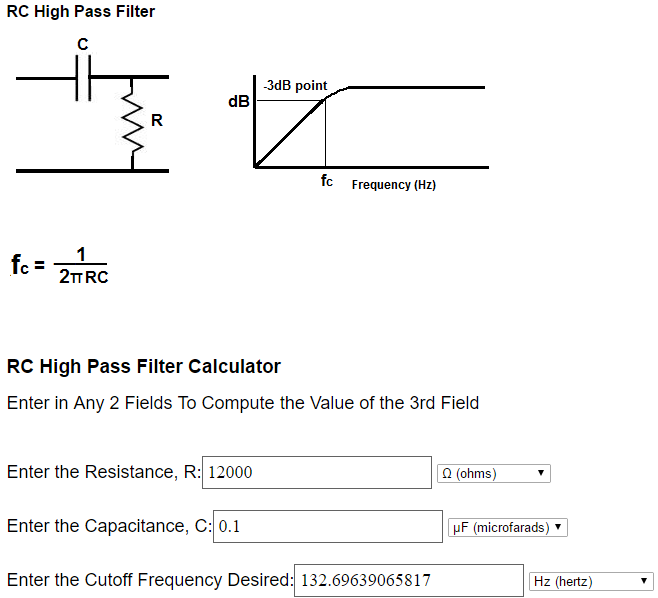

I used an online calculator (im a newbie) to find the required resistance for the C-R HPF. I thought the given resistance value is only for the resistor placed in parallel (looking at the diagram above). Seems like it is actually the resistance of the entire circuit, my entire circuit resistance with the 12K ohm resistor in parallel is about 10 ohms. This means that the real cutoff frequency is actually 160,000Hz (yeah this is probably the issue).
Bingoit is actually the resistance of the entire circuit, my entire circuit resistance with the 12K ohm resistor in parallel is about 10 ohms.
