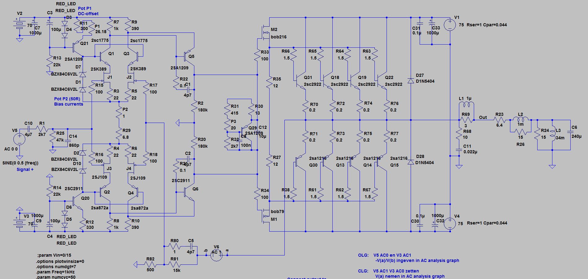

Bias front end: +-75% of IDSS of JFET ==> 4-5ma.
I don't know why, what is wrong with JFET input. They sound just fine, but it needs experienced ears to find out if they sound so... boring? It seems that the quality comes with the JFET used, not just how it is operated, so may be it is related to the Idss. 2SK246 is low Idss but I like them better than K170.

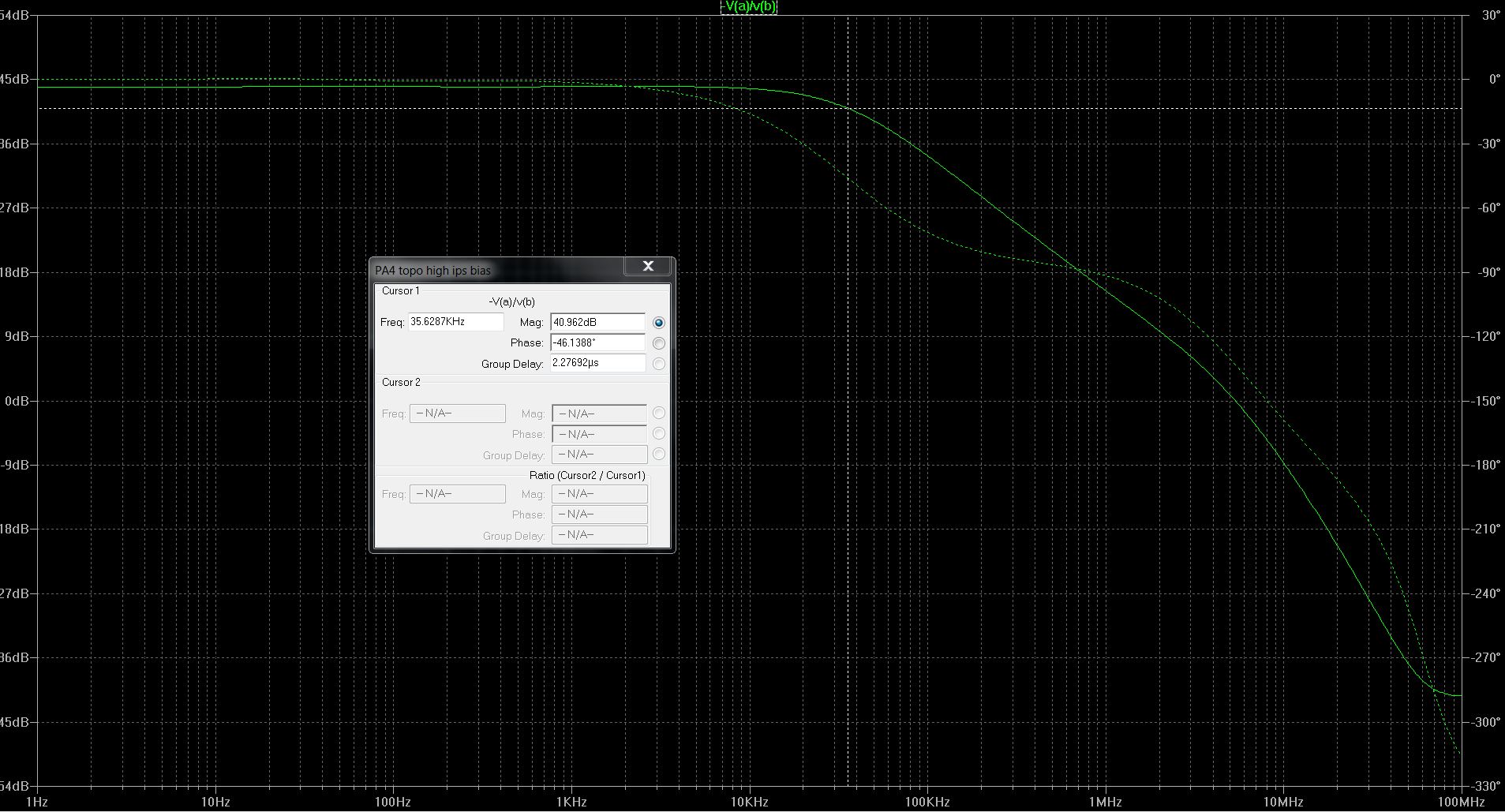

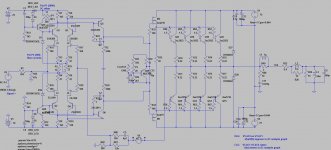

In general: I would like to design an amp with an open loop bandwidht of approx 40khz.
Don't you think that the goal is too pessimistic? The AC analysis chart (pic 2) does not look very good. Many circuits have flat response and zero phase shift up to 20kHz. I don't say that it matters soundwise, just cosmetically good
using as less as possible miller capacitance (this means not to high gain).
So, you are worry about miller capacitance and gain. I think the real devil is phase. From critical listening to speaker crossovers, I have learned how destructive a superposition of 2 signals with different phase can be. I believe the same thing is true with small signal in amplifier circuits. That's why non-feedback designs have their merits. I think feedback must be designed by ears, or in my case, I choose topology where feedback doesn't ruin the phase, i.e. "current feedback".
If you can buy the concept of less phase problem with current feedback, may be you can check the TSSA thread. Hahfran has posted a bipolar version if you need a "preliminary work".
This phase issue is one of a few thing that you cannot see from usual simulation.

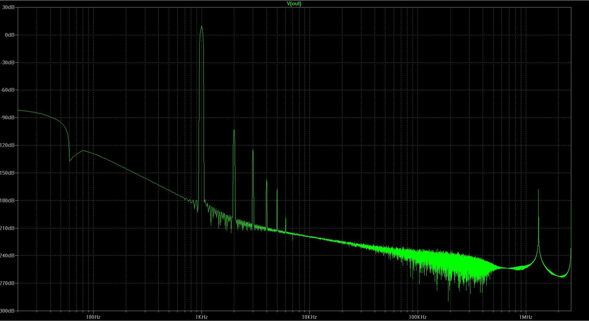

So far, this is the best amp I ever sim'med (only reference I'm having). This VAS wsas a miracle in this design for the above points.
In term of THD? They say, once 2 trailing zeroes is achieved, it doesn't matter anymore. You're lucky that the JFET input allows for no cap in the feedback loop. In TSSA, as a consequence of "current feedback", if you had to use cap, the size will be bigger. This gives "real" distortion. May be somebody will be able to incorporate servo in the future.
In mosfet amps, low distortion usually equate to insufficient drive, and high distortion sometimes equate to sufficient drive, and higher distortion is preferable in this case (see CBS240 case with his planar stripe mosfet).
In your case, I don't know if the drive for the mosfet could be low, and if it is so then will it give bad impact or even improve things by "slowing down" the bipolar. In mosfet amps, strong drive means sonically musical and joyful, and weak drive means boring. Bipolars have very strong drive, so who knows the effect of the mosfet driver, I don't have experience with this

Regarding the phase shift, I'm I wrong or can we see this on the AC analysis? Isn't this the group delay parameter.
It bothers me that I can't understand much of what Jay is posting.
Do you understand any, or some of it?
I had a look at your sim of open loop performance.
I see phase margin ~50degrees and gain margin ~18dB, Have I read these correctly?
I also see a steepening of the gain slope before the gain drops below +0dB. That often leads to instability.

Phase margin is indeed 50°, this is still enough reserve I think, even if it is sim'med. Not?
Gain margin is about 15dB Yes. Have actually not a good idea how good/bad this is. Will do some research on this topic.
I have the idea that also you would be not totaly satisied with this?

This is a circuit I made based on Bob's paper, in turn based on Dr Hawksford's work that functions very well. You can use it as a guide to build your output stage follower using vertical mosfets. Because the circuit uses local feedback/feedforward the overall linearity is very good and does not place the terrible non-linear distortion components linked to vertical 'switching' mosfets on the IPS and VAS. Also it does not require a seperate higher tier voltage supply to achieve rail to rail operation.
B+/- in this case is +/-24V. For more voltage, adjust the components to suit. Output devices can be paralelled, just use seperate gate stoppers, gate Zobel filters, and source ballast resistors.

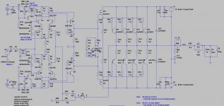

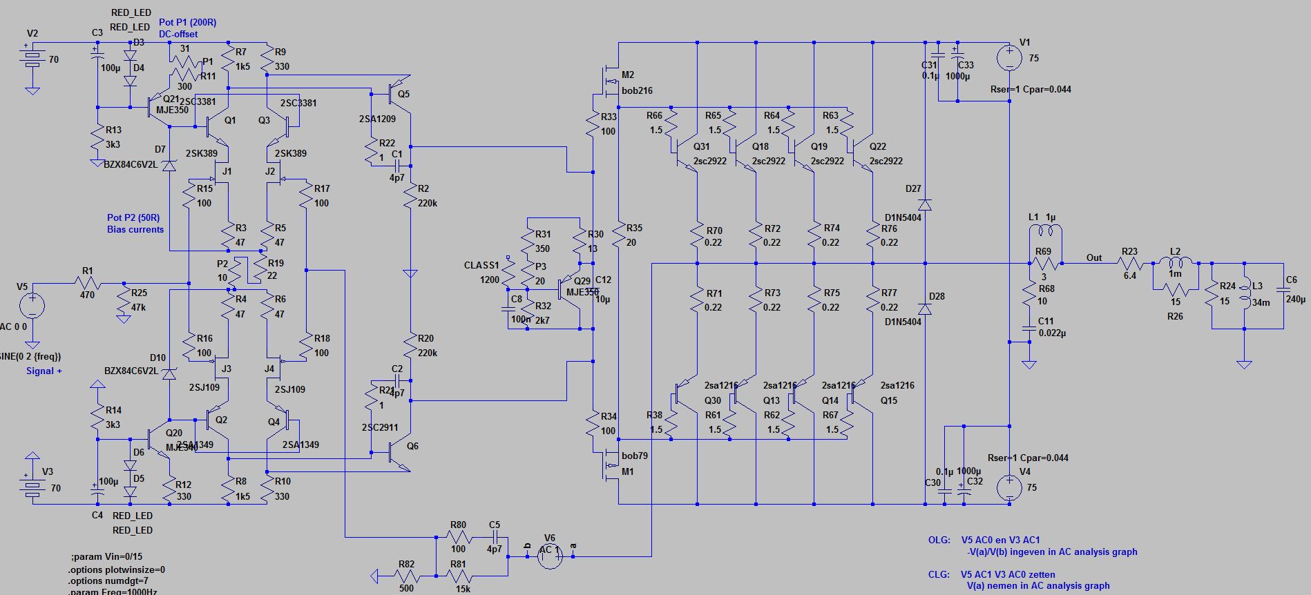

So I would like to make an OP lite the one in the sketch (sorry, I am away from my Eagle), for a subwoofer use, 500W / 2 Ohm continuos duty.
In know that I am under the 1/4 power rule (I am actually at 1/3) but I believe the case makes the difference.
Look at the 75C (case T) SOA graphs, very promising.
Any comments?

P.S. here's the missing sketch...
