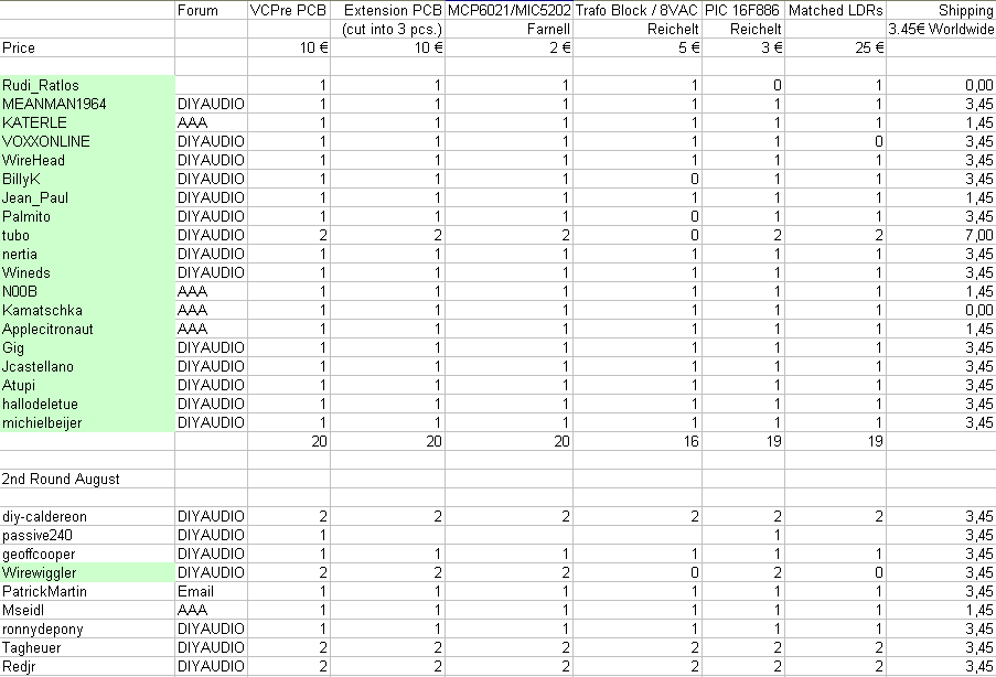

BillyK,
Do you think there is enough US interest in a group Buy?
Bill
I am interested and willing.... Looks like it's only you me and Palmito. Anyone else??
What post # had the price of the PCB and misc. parts? I haven't read the entire thread. Working on it. Count me in as well, but I would like to know what I'm signing up for. I'll take 2 sets of everything too, plus LDRs and transformers for US (120v). Add my name to the spreadsheet.
Rick
Rick
I just signed up. Does that make 3 of us now? Not enough for a group buy.BillyK,
Bill

Gentlemen, find attached the list of participants of round #1 of the group-buy (this round is closed) and round #2, which I will start in August,
after I have received some feedback of the round #1 - DIYers.
Concerning the status:
1) The tracking-ID says that the PCBs have left Hongkong 3 days ago.
2) No feedback from UriahD. concerning the matching of the LDRs so far. I will ask him today.
3) METAL is busy adapting the software.
4) The User's Manual is "under construction".
Concerning the mini-group buy from MOUSER: which components do you want to include? LCD, transformer, motorized potentiometer?

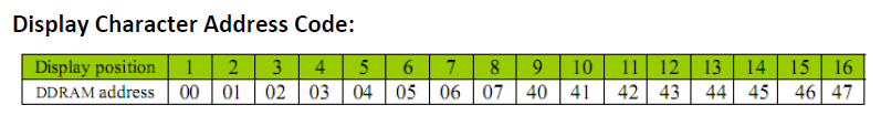

@Adrian: 16x2 chars displays will be supported as well.
But the support of both display types (16x1 and 16x2) is not easy. It takes some time to program and verify.
This is the problem:
When I write "Hello Adrian" on the 1st line of a 16x2 display, I set the cursor to position 1 of the 1st line and do 12 consecutive
put-character - commands. No problem.
When I do the same on a 16x1 display, I once more set the cursor to position 1, do 8 (!) consecutive puts, then change the cursor-position
to X'40' and do another 4 put-character - commands.
Not easy to support both types of display, as I said, but it will be done.
Best regards - Rudi_Ratlos
P.S. The idea is to output texts that consists of 2 chunks of 8 chars without looking cryptic.
