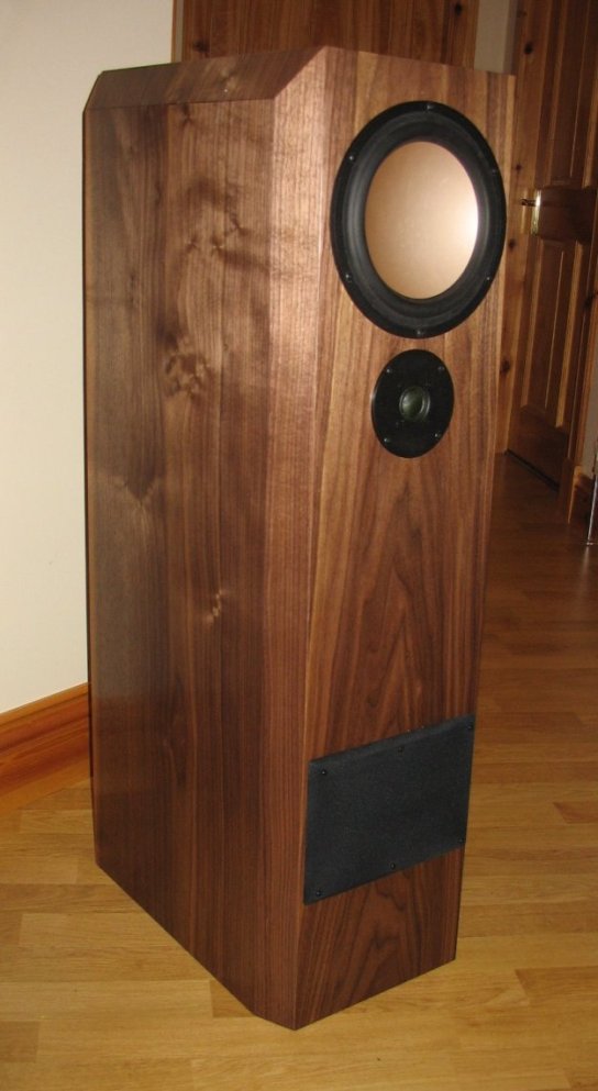

Speakers are finally finished. Thanks to every one for your help and advice. They're not perfect but I'm fairly happy with them.
Although the iron on PVA method was simple I found it did have it's problems. I had to ensure the raw veneer was as dry as possible before starting because shrinkage was causing cracks to open up. Thankfully this was only on the first panel and It is now filled with filler wax and is almost indistinguishable.
I also found a lot of pressure had to be applied to the iron to ensure a bond. I worked a small area at a time and went over it with a veneer hammer while still hot. I have just noticed one small area (about the size of a thumb nail) which has not bonded. Not sure what I'm going to do with it now. I fear the iron will damage the oil finish?
Here Is a photo, unfortunately it doesn't really do the beauty of the grain justice but you get an idea.
Thanks again for your help, Kenny

Hi Kenny
Your speakers look great. It is spurring me on to finish mine which are working but not finished off as yet.
If it helps you my father was a cabinet maker and I used to help him a lot with furniture making. The usual method for removing bubbles was to cut the bubble along the grain, then squeeze glue under each half and then leave wuth a weight on untill the glue had dried. Any cracks were filled with wax - which I think you are doing - as you can adjust the colour of the wax easily to suit the grain of the wood.
Hope you enjoy the speakers and that they sound as good as they look.
