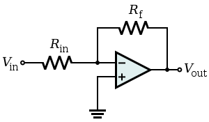

You just need a single op amp, configured as an inverter, driving one of the two amp modules. In the image below both resistors should be 10K.
You also need +/- 9 volts to +/- 15 volts to power the opamp. This is much less than the supply rails for the power amp modules. It can be obtained with dropping resistors and zener regulation or from a different power supply. You need bypass caps on the opamp power supply pins.
I'd use something like an LM833 or NE5532. Connect the unused opamp output to it's negative input and leave the positive input floating.
The only other trick is to get the grounding correct. Generally the positive input of the opamp needs to go to the quiet input ground of the module it feeds and/or the star ground point.
The speaker will then connect between the two positive outputs of the amp modules. I wouldn't suggest using anything less than an 8 ohm speaker as bridging makes it look like half the impedance. So with a 4 ohm speaker the amps would see a 2 ohm load and be very unhappy each having only a single pair of output transistors.
If the above is still too confusing, you might need to do some reading on basic op amp circuits, zener regulators, power supply design, good grounding practices, etc. Unfortunately I don't know of any ready-made boards/modules that will cleanly invert a signal, solve the power supply problem, etc.

Relative to the two other posts, I was just trying to point out it's not really all that difficult in practice. You don't need any transformers, fancy phase splitters, 0.1% components, or "balanced line drivers". Lots of well respected amps offer bridging and use exactly one op-amp to do it.
