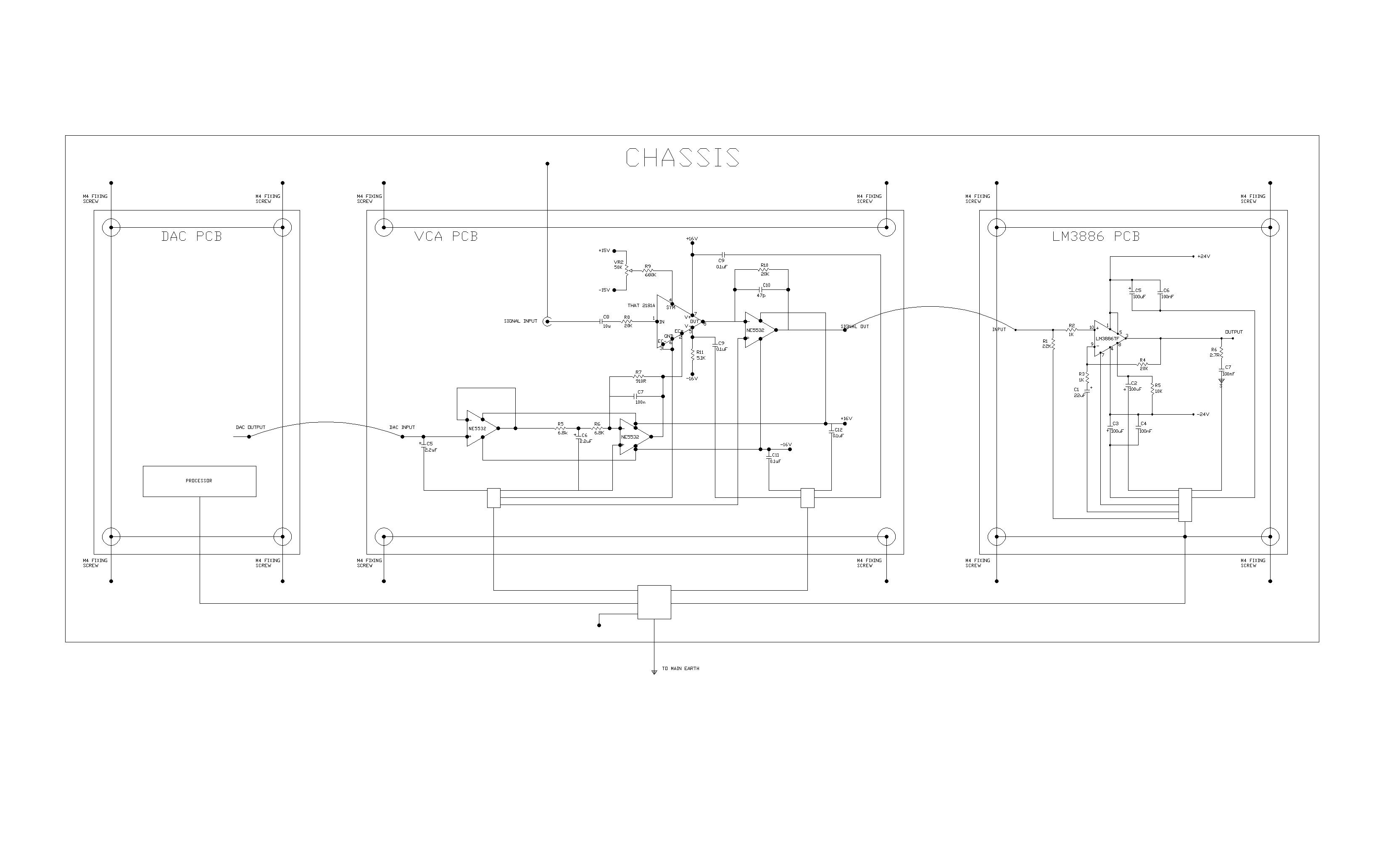

Have shown the existing earthing layout, where each pcb is mounted to the chassis plate there are copper tracks which run round the outside of the pcb and connect to the m4 mounting screws. On the amp pcb the individual earths are in star but the star connects both to the m4 mounting screws and to the main earth block on the chassis.
I have indicated where the copper tracks run between the mounting holes, not all corners are connected on the vca and the processor board.
Now I have drawn the earth schematic it does not look right even to me.
When I had the system working with the vca built on a breadboard the amp earthing was as shown but the vca earthing was with the double star and it worked fine so I thought the amp earthing was not causing the problem.
It looks to me like you've created several ground loops. One that's system wide and run through the chassis and one on each board.
You may also want to rethink how the IV converter ground connects to the rest of the circuit.

the pdf is not legible.
At 300% I think I can read to main earth, but that is just little better than a guess.
I see a Signal Flow from VCA to 3886. You have no Signal Return.
You MUST run the Signal interconnect as a TWO wire Signal Flow and Return.
If you have repeated this type of error elsewhere, then these will add up to massive interference of the signal.
All connections MUST be TWO Wire. Outputs and Inputs and Power. Three wire for dual polarity Power.

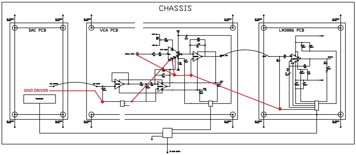

I agree that the grounding scheme is non-ideal to say the least. As drawn, you'll have issues with ground loops, but I don't think it explains the issues the OP is having (see post #1).
With this grounding, you'll certainly get poor THD, but that's likely to be, say 0.1 % rather than 0.005 %. That's not something you'd necessarily pick out in a listening test or on an oscilloscope, but it would be easy to measure. But the poor grounding scheme shouldn't cause the signal to completely disappear in the way the OP is describing.
I think a bigger issue is that the signal ground to the I/V converter is taken from the digital ground. The LM3886 sits in its own little world. If you want the best performance, route the audio signals pseudo-differentially (as Andrew also points to). The best signal ground reference on the LM3886 board would be the ground connection at the output connector. You can convince yourself of this pretty easily by running a simulation of the impact of current in ground path from the load ground to the supply ground.
The best advice I can give is to simulate the ground scheme. Or at least draw out the ground resistances and look at where the high currents flow and how that impacts the low-level signals.
Also, sweep the THD vs frequency. I've found that a crappy grounding scheme will typically identify itself as a severe THD degradation at HF. You can see one of my experiments (with THD data) here: http://www.diyaudio.com/forums/chip-amps/252436-lm3886-pcb-vs-point-point-data-3.html#post3846783

Will do another pdf, it came straight from acad.
Thanks for the info, not sure I quite understand everything yet.
Two wire signal system from vca to LM3886; can you explain a bit more as I do not know how the return wire should be connected.
Seems I have a lot of mods to do to get things right.
