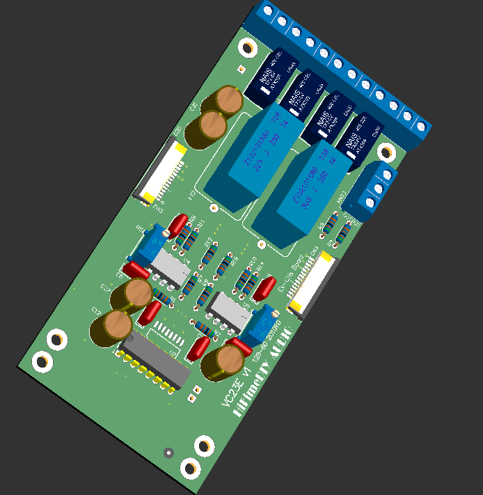

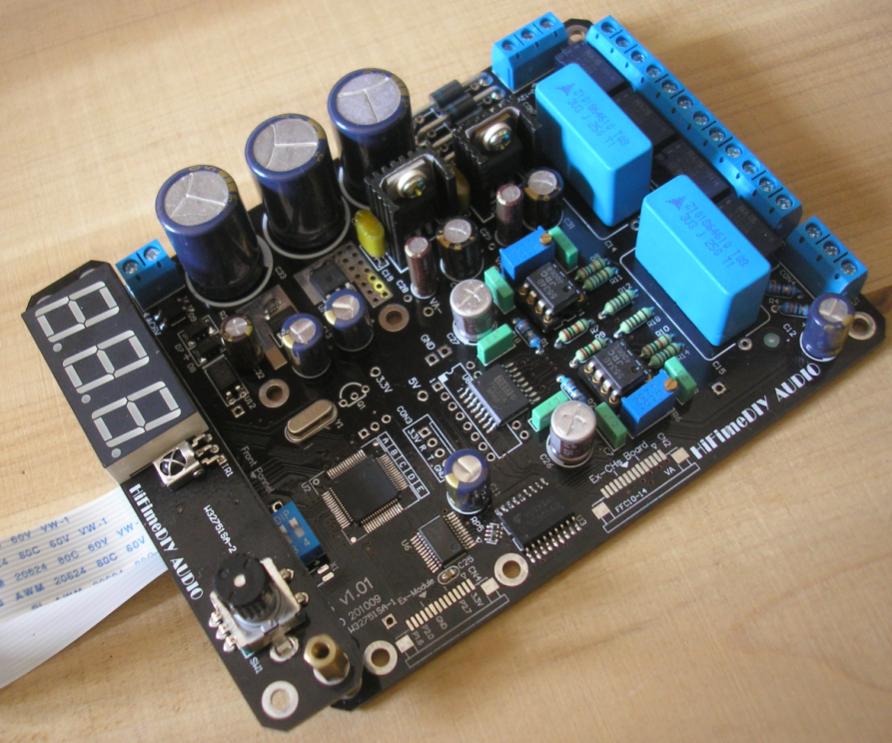

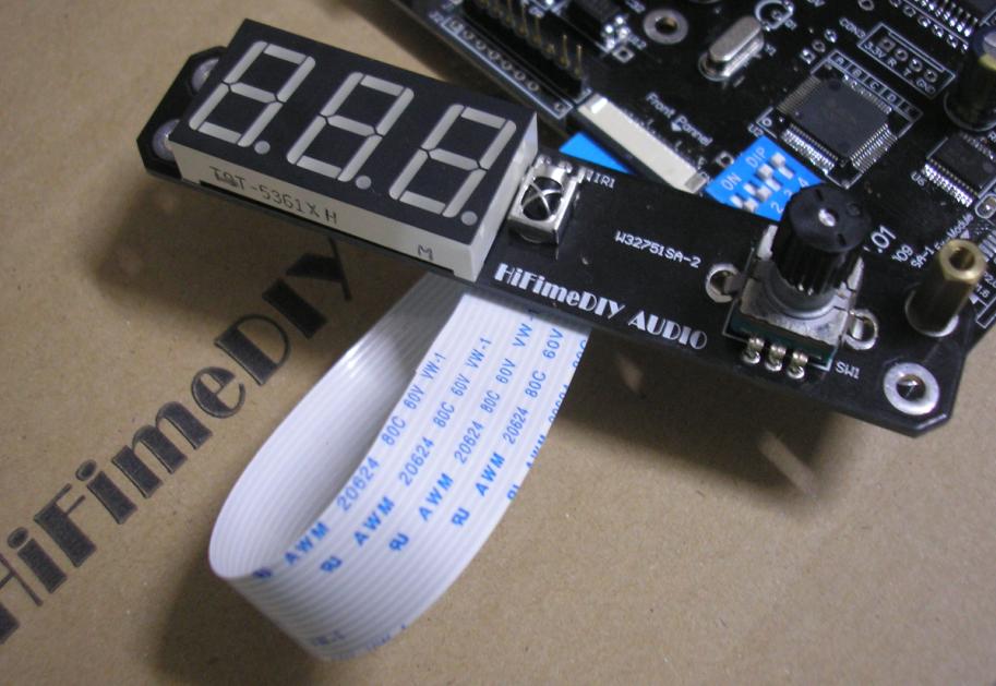

VC23, my new PGA2310 project
Hi everyone.
I made it these days, cool? :D
Use msp430 MCU, 4-channels input, 3*7seg display, rotary encoder, and romote control...

Are you going to publish more detail or make a PCB and uC available? I have a friend that would be interested in this unit and a 6 channel or the ability to extend control to other boards could make this of interest to people who use the DCX or the MiniDSP (stock) or multiple MiniDSP.
I think this board is a little bigger than other design(PCB size: 128*100mm). It's an all-in-one design, include input switch, input buffer, HID(human interface device) and PSU. Gain range from -69dB to 57dB, so you can also use it as pre-amplifier.:)
hello Hifimediy,you read in my mind with your projects :)
a couple of questions
why use pga2310 and not pga2311 ?
will it be possible to operate also with buttons ? volume control seems obvious. Will on/off and channel selector buttons also be possible ?
one more : ability to control switch on/off of an external board ?
Hi my friend.
Actually we can use PGA2311 on this board, just need to change to supply voltage for analog circuit. And when PGA2310 used, it's +/-12V for analog, that is the recommanded voltage for many good OPA. That's why I prefer PGA2310. And PGA2311 is the second choice.

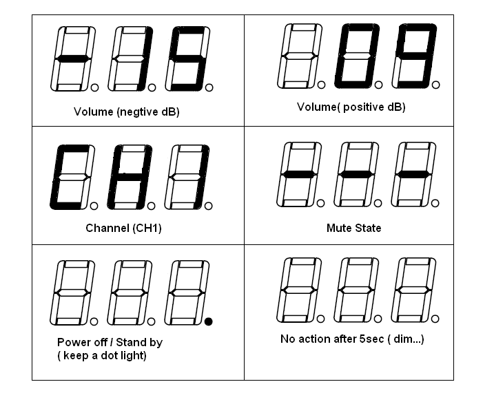

It can be controlled by remote or rotary decoder(EC11). By EC11, we can control volume, channel, and turn on/off. The external board will be controlled synchronously.
hifimediy
Hi my friend.
hifimediy
thanks. Very interesting :) I now realize that, except voltage, pga2310 and 2311 are very similar. I plan to put a volume control board in a box with a DAC. As you say, many DACs require +/- 12V. So only one transfomer could do for both ;)
This volume control board will require very little power I presume ?
You will have to detail how this will be operated : many fonctions for the single rotary encoder ;)
