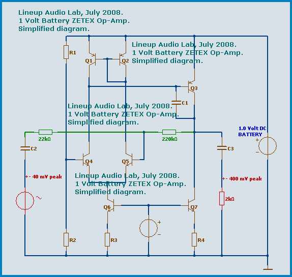

Here is simplified op-amp circuit I use.
All very standard and basic.
Of course my real circuit details & tricks are kept very secret.
So do not try this at home

darkfenriz said:Why?
Because it needs over 3*VBEon supply to bias. Top down: VBEq1/q2+VBEq4/q5+VBEq6. At 1V supply, not a chance in h*ll, unless it's built with Ge trannies (which I would not even think building a high gain opamp with).
Small signal transistors work quite hapily at around 0.2V Vce.
May I ask how this should work? You get in this case a negative Collector-basis voltage...
Have fun, Hannes

Hello partners!
As I already told you:
I posted only the SIMPLIFIED circuit.
If you are of the clever sort, like darkfenriz you may figure it out:

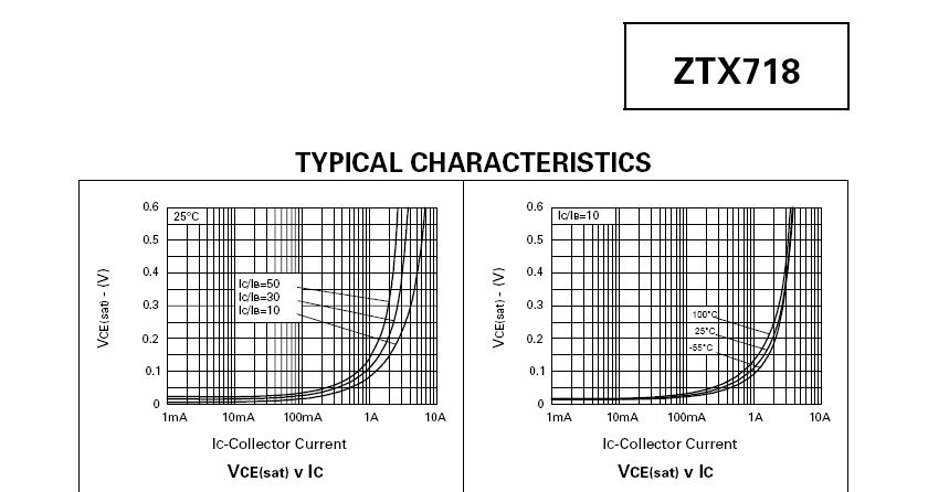

Ther fact is that, like also stated well in this topic,
I use ZETEX Low VBE & Very low saturation transistors.
I have even posted links to those devices.
thanks, AndrewT, for pointing me to these nice ZETEX transistors
http://www.zetex.com/
I know ordinary small singnals works at 0.050 Volt, at very low currents.
And works quite well at 0.100 Volt,
considering those currents I have mentioned in my fists post: 200 - 700 uA
ZETEX ZTX689B & ZTX718
Now, when using these special LOW SAT transitors, with very low VBE, too,
it is no problem to get 1.0 Volt to be well enough to run a circuit
like the schematic I have posted.
Of course, not without some small additional tricks and smartness

sawreyrw said:lineup,
The circuit you just posted will not work. Sorry.
h_a said:Lineup, you're sure that this one will work outside the simulator?
There are 3 junctions in the LTP with current mirror and that already exceeds 1V?
Am I missing something? Have fun, Hannes

I can mention a couple of figures.
first:
I do not use the freeware simulators LTspice and Eagle very much.
I use 2 different Professional Simulation softwares.
Standard Pro versions of these will cost you like €500 - €1000.
I use one called Power Pro which is a bit above standard version.
The lowest VBE I have tested in these high cost Spice programs
is 0.473 Volt for one ZETEX transistor.
( If this is not a good BJT spice sim value,
I go kill those advertising expensive but useless software )
Now, that one (vbe=0.473V) had too low gain, hFE, to be a good performer in Op-Amp.
I use only 2 stages, and need all gain I can get.
The devices I use now, have a VBE drop like 0.495- 0.505 Volt.
I would guess the final bottom limit for the topology in my posted schematic
is like at 0.75 - 0.80 Volt Supply ... ( +- 0.40 VDC )
0.500V ( top current mirror, VBE )
0.150V ( input pair, C-E )
0.150V ( constant current source, C-E )
0.800V
Lineup regards

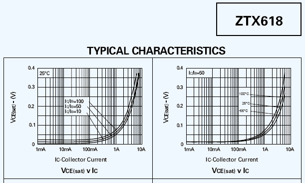

Low Saturation Voltages from ZETEX
Hehe,
darkfenriz
you beat me to it
I was just going to post this, when I did see your post.
For example ZTX618 has got the following saturation voltages characteristics
See Attachment.
If I can accept a gain of 100
I can pass ~50-100 mA at 0.025 Volt C-E ( 25 mV )
If I can accept a gain of 50
I can pass 1000 mA (1A) at ~0.075-0.080 Volt C-E ( 80 mV )

The main concern of Syn08 and me was the 3 junctions that each needs VBE to turn the transistor on. How did you solve that?
C'mon Liney, post your secrets. Designing non-working circuits I can do myself. Give this thread a sense (posting non-working circuits isn't).

what about using two 1.5V batteries and trying to design for a minimum (near exhausted) supply of ~2Vdc?
but at what Vbesat?lineup said:If I can accept a gain of 50
as Hannes said:
in other word, how the p-n and n-p junctions work inside this transistor?
Have fun, Hannes
if Vbe=600mV and Vce=600mV then the voltage at the base equals the voltage at the collector.
In most of our circuits Vce>>Vbe and that leads to the more usual case of The voltage at the base << the voltage at the collector.
But, we have the special case of Vbe>Vce and in the extreme case we approach saturation. For all these the voltage at the base is higher than the voltage at the collector. Nothing mysterious.
The downsides are that we must inject an ever higher base current to get the Vce down to these lower levels and that the base must be driven from a supply that has higher voltage than on the collector. Some form of bootstrapping may help with this.
Will Lineup tell how he makes his circuit work?
