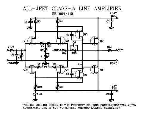

This same folded cascode configuration was used by Mr Borbely in his EB 604/410 /all- jfet Line Amp
(jfet second stage instead of BJT )
Rs =R5,R6, R8 , R9 = 100 R
R3 = 1k5
R=4 = 332R
R7+ P1 = range 47,5- 247,5R - depends on the Idss of the input jfets ( BL/V) set up the drain current of the input jfet at 2 mA !!!! ( each one )
If I understand correctly Mr Curl suggestions , those values aren't optimal , and this simple design could be improved ???

It's been a while since I read those JFET papers, but if I recall correctly they were talking about the plain-Jane common Source, set the load resistor/bias current to half of rail for maximum voltage swing sort of thing. While this may be good advice for that one application, there are other approaches to amplification...such as the folded cascode, where you're depending on the cascode to handle the lion's share of the voltage amplification, not the input JFETs. Trying to make 60% of Idss into a one-size-fits-all solution isn't necessarily going to be the right answer in other circuit topologies.
Grey
While I developed this exact topology,(Borbely's version) even down to active part count, in bipolar transistor form as early as 1968, it is DIFFERENT in optimum values than the JC-2 line stage. This is because the output follower BUFFERS the VAS stage, and it only has to create voltage swing, not supply output load current. In other words, the VAS stage doesn't have to do much, so it is easier to drive, and the input j-fets can be reduced in current. Then 2 ma or so is OK. You will find ALL Parasound power amps and preamps made this way for the last 15 years.
This is not the case when you are making a TRANSCONDUCTANCE amp and driving a difficult load. (potentially) This is when you need to beef-up the input stage so that it can effortlessly drive the VAS (and output) stage, in order to get 100ma or more peak current.
I used a cascoded form of this design to make the Grateful Dead line driver from the console in the audience to the stage. Now that was a challenge! Hundreds of feet of the worst wiring that you can imagine. No typical op amp could do the job, so they hired me to do it, after many years of absence, in the mid 80's. They were very happy with the result.
You might also note that Borbely's design doesn't even bother to turn off the output devices. They work at 100% and more than Idss. What a wild and crazy guy, and I told him that he should turn them down a little, maybe to 90% of Idss. He got very upset when I criticized him. :devilr:

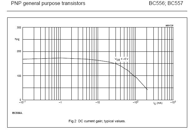

My intended application for this circuit was as a preamplifier for my office system. I chose if for the simplicity, low cost, and small size. I have preamp out jacks so I can connect it to other amplifiers, but I use it as part of an integrated amplifier 95% of the time. I only have a single source input.
As such, I don't need to drive low impedance loads or long cable lengths. The amplifier circuit it drives has a 22K input resistor, so it is driving a light load. I bench tested it with heavier loads for reference.
In my application, and in most home applications, the preamplifier sees a relatively high load. Simplistically, the second stage gain will then be set by the feedback resistor in parallel with the load. With the parts I specified, the second stage voltage gain is approximately 120. With a 6 volt peak to peak output, the voltage to the second stage is 50 millivolts. The distortion of the input stage at that swing is largely independent of the input bias setting. I chose the resistor values I did for the second stage bias and for the open loop gain. Other values will certainly work. As Mr. Curl stated, running at idss will nearly double the transconductance and could provide 3 to 4 times the current drive for the second stage.
Interestingly, the hfe of the bipolar devices supplied with the parts kit start to roll off above 30 mA. The hfe is still 150 typically at 30 mA and probably higher as the part is warmer than 25 degrees C and hfe increases with temperature. It occurs with a 2N4401 also, but at a slightly higher current. The current required to drive the second stage depends on the output load impedance. With a low reactive component, the drive current is just the miller compensation capacitance. With a large reactive load, correspondingly larger drive current is required. The value of R11 limits the maximum current. Removing R11 allows additional current to be supplied to the load. If that describes your application, you would likely do well to heed the advice of Mr. Curl and crank it up.
My comments and opinions are based on the eBay kit, not as an upgrade to the JC-2. I’m not sure that was understood initially. I shared what I did and the results I had with the values I chose. I believe Mr. Curl has provided some valuable insight into operation in a harsher environment, and provided alternative values for your consideration.
