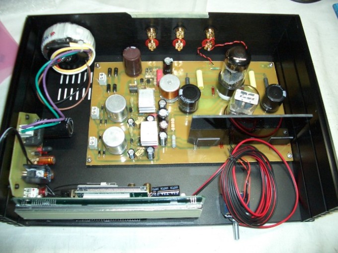

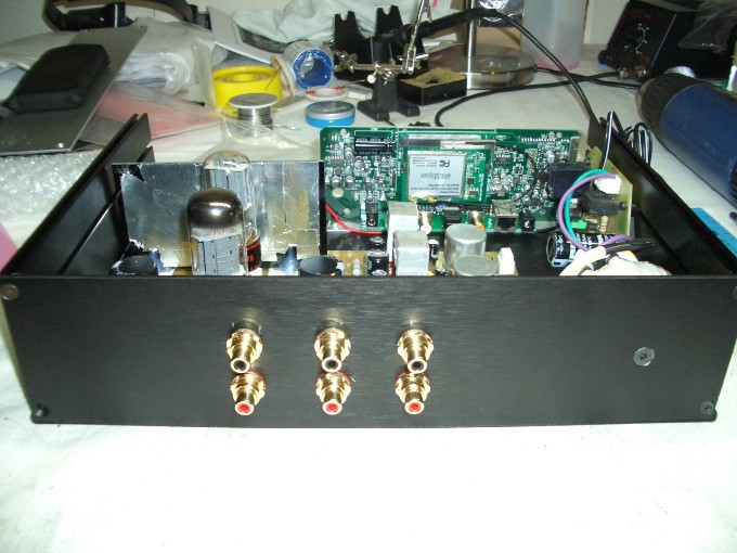

Going ahead: on the front we have the squeezebox3 display, on the left its psu (5v 2ah) and its trafo. The black plexiglass shield on the tube is not to let the tube little light come out on the front, since the front will be a smoked plexi. Obviously the big trafo will be in a case by itself (i say "obviously" because it does not fit in this one...)
Ok, here it should be readable

No, I don't have any other image/file of the board.
I still did not connected the squeezebox to this preamp, but I run the squeezebox with a Marantz7 tube preamp and GC monoblocks and it works very well.
I opened the squeezebox and removed it from the case (6 screws: 20 seconds to do it) and connect the rca's to the commuter and then to the preamp (maybe I did not understand your point, here).
To eliminate the harshness of the digital signal squeezebox also have a BB dac, it should work in some way...
