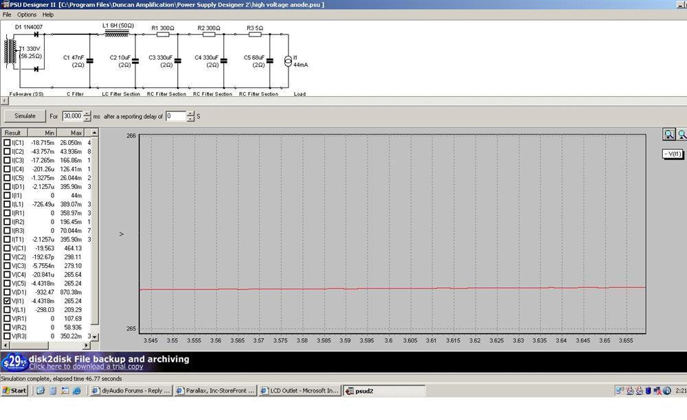

Using the formula for calculating the min. size of the choke needed, I was lucky enough to end up at 6.045. I have read also that using the Fairchild Stealth FREDs will assist in prevention of ringing. Perhaps I should buy a 10H just to be safe.

If a choke is "ringing" you likely won't hear it. You'll have a B+ that is not quite stable. It will have some overshoot. Model it in PSUD2 with a slight change (+1mA) in current draw. For a portion of a second after the change, you'll see the B+ swing past the target voltage, then reverse and swing back up, again missing the target. Typical underdamped filter response.

No, it's exactly that- as the power supply bounces around, so does the desired signal. Bad juju. Sizing of components depends strongly on the design of the supply- I tend to use C input and no long strings of inductors (which is just asking for instability). For CLC filters, the first C should be moderately sized to keep ripple currents low, the second can be as big as you like.

If the PS is modeled in PSUII and then zoomed down to <1V, will this "ringing" show up? I don't know how much ripple is OK.
I have taken your advice and modeled a CLCRCRC and that smoothed out the slight ripple I had previously.

What you want to do is ring the bell, and to do that, you have to tap it with a small hammer. Use the stepped current option and pick a current that's (say) 15% higher than nominal. Step to it after (say) 10 seconds, then look at the output between 9 and 12 seconds. That's where the ringing will show up. A good supply will show a monotonic exponential decay from the initial to the final value.

It's been there as long as I've been using the program. Choose a current sink as a load, then when you get the dialog box on properties, check "stepped load" and fill in the blanks.

I tried that and it worked like a charm! I never would have known what to look for concerning ringing. I had slight ringing that was a repeating pattern, So I am plugging in new #s for the Caps & Resistors.

With all the help I've been given on this project and the GREAT program PSDII, I think I have come up with an extremely smooth DC supply for the B+ rail on my Pre-amp. If you see anything glaring please post your concerns.
