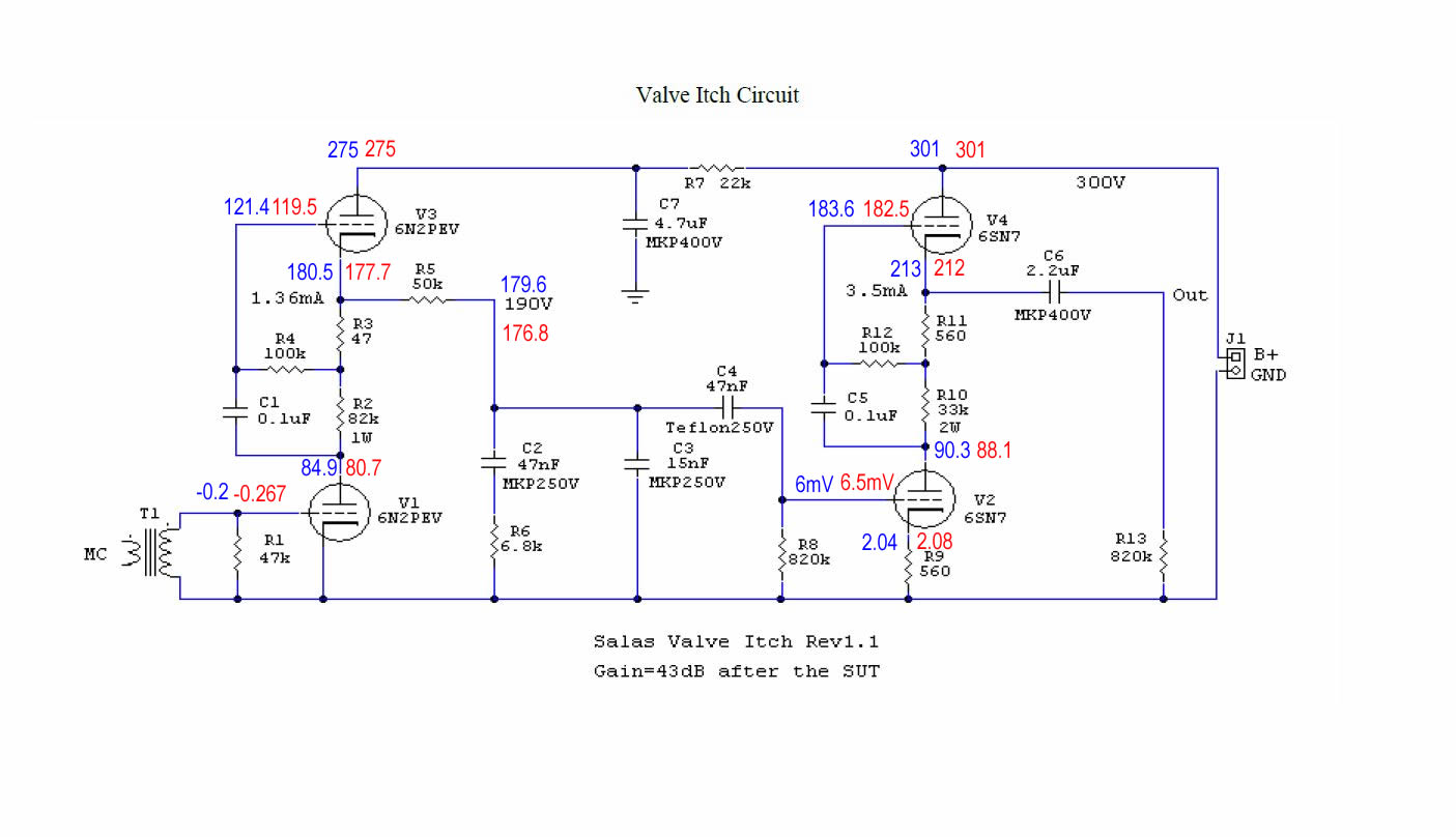

The bias voltages look OK in most places except than input DC, is that ~0.2V? And upper tubes voltages between grid and cathode. They look way much wide. Don't know if Fran can check in his to see if those points follow for a confirmation. Do you use an input transformer?
*There are possible explanations but its early to guess. Confirm R4, R5, R12, C3 values meanwhile if you can.

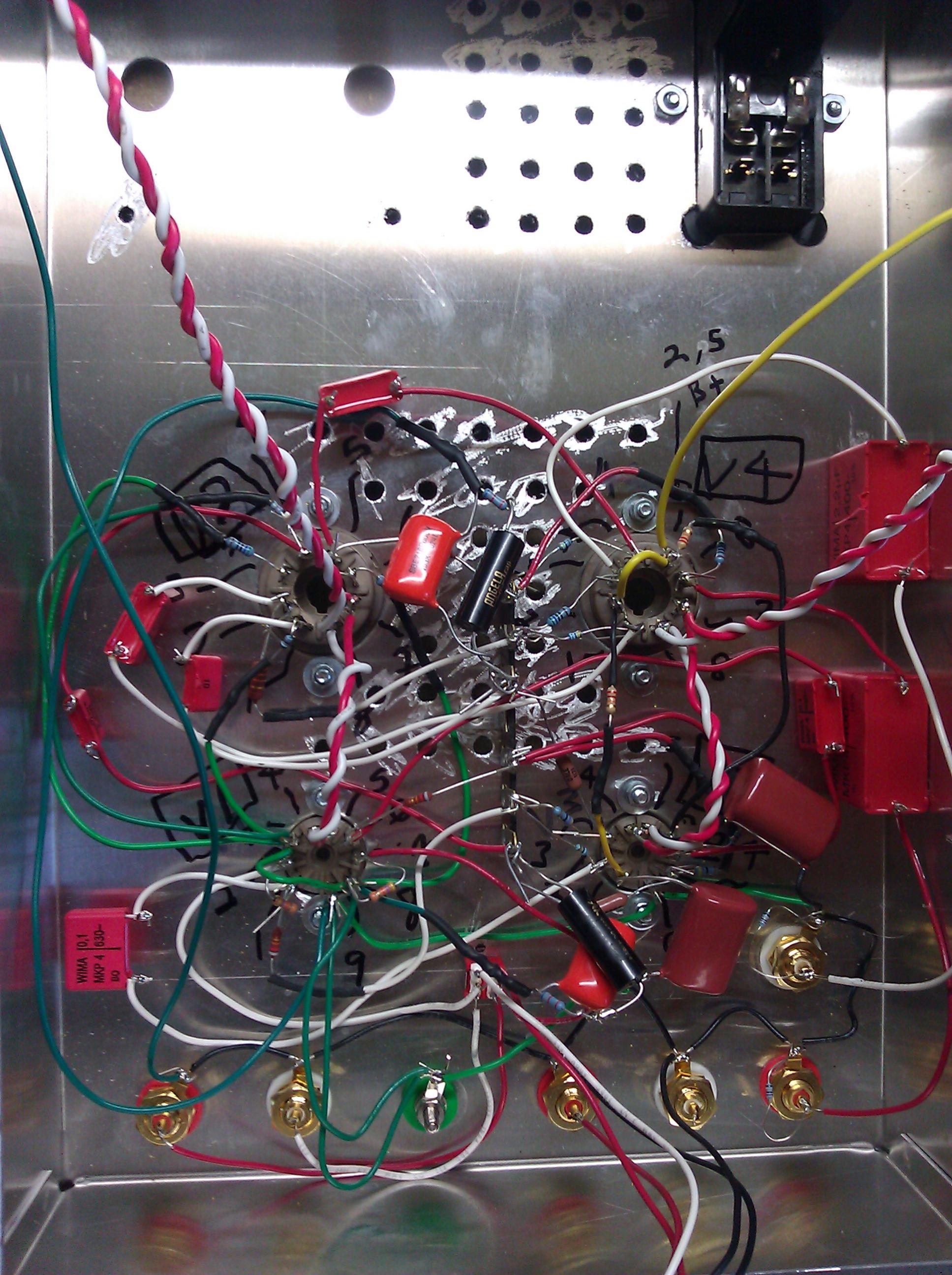

I've begun having a constant static type of noise. It wasn't there before but now it won't go away. I tried swapping all of my tubes, but they're all tubes from the same batch.
Is it possible I was sold a batch of bad tubes?
Don't know, maybe. Spend time to encase and ground the construction properly meantime, its high gain-low signal so it needs some be-together standards, show us pictures after that. That way it will be steady, we could look into wiring, tube types, maybe Fran can spot check a couple of crucial voltage parameters in his build to see if they track, and we will give a hand to debug it. They all succeed in the end.
I'd say go over every connection and component. It can't hurt and you might get lucky. I had a fair bit of debugging on mine to get it absolutely quiet, but then it was quiet.
A few pics would help us to help you too, maybe go back through this thread and look at my pics and it might help jog something? You'll see I had issues!!

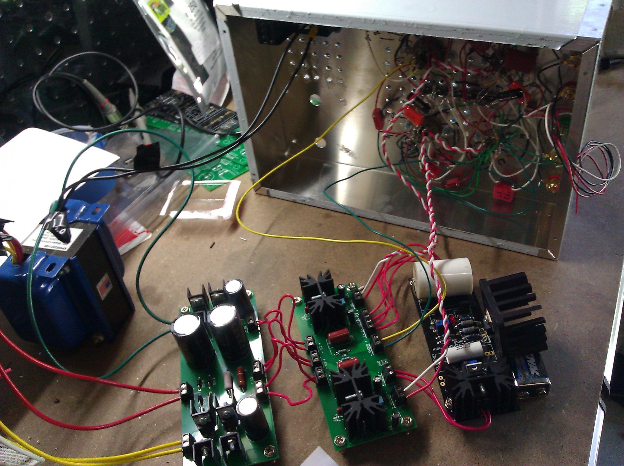

I just got it all grounded and put together. When I turned it on, something went POP. I'm letting it sit for a while before I open it back up.
I might have to rethink how I'm doing this and go back a few steps. Maybe I should use 2 chassis so I can have plenty of space to spread out this circuit.
I attached a few pictures from the build process.
Something I find helpful - maybe you have done this already. I print out the sch and go through each and every connection, and tick them off on paper one by one to make sure its ok. One colour pen for left and another for right.
You build like me - its a bit messy - so its kinda hard to easily find something missing afterwards. The sch and pen has been my friend on many occasions!!

I think I figured out what happened. The leads from Q1 on the SSHV board weren't clipped short enough, so they made contact with the bottom plate of the chassis. When I turned it on... pop. Nothing looks burned, but 345 V are going into the SSHV and only 6.4 are coming out. I'm pretty sure I burned up Q1.
I'll try to pull it off the board tomorrow and replace it. Unsoldering a 3-pin package like that is so hard. If anyone has any tips I'd be glad to hear them.
If there is weird reading on TP points then Q1 (CCS cascoding Mosfet) could have gone. But if there is normal reading there, it could had hit something further down. So check first. Use wick and/or desoldering pump. Some flux would help the wick if you got any in liquid form or paste.

So I checked your voltages against mine and all yours check out AOK except:
grid of V1 - I get ~1-3mVDC there
grid of V2 - I get absolutely flat 0VDC
My B+ is a little lower than yours, about 275-280V out of the shunt, so all my voltages are a little lower than yours, but the proportion is exactly the same.
I think you need to look at the voltage on the input grid in particular, then after that the layout.
